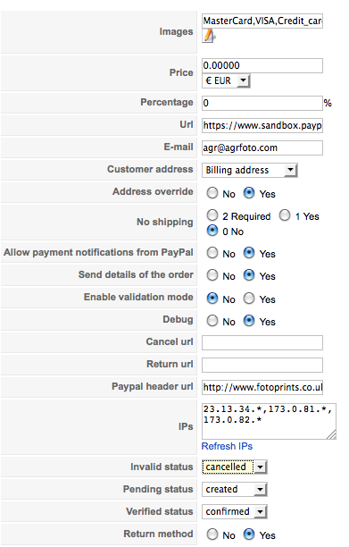

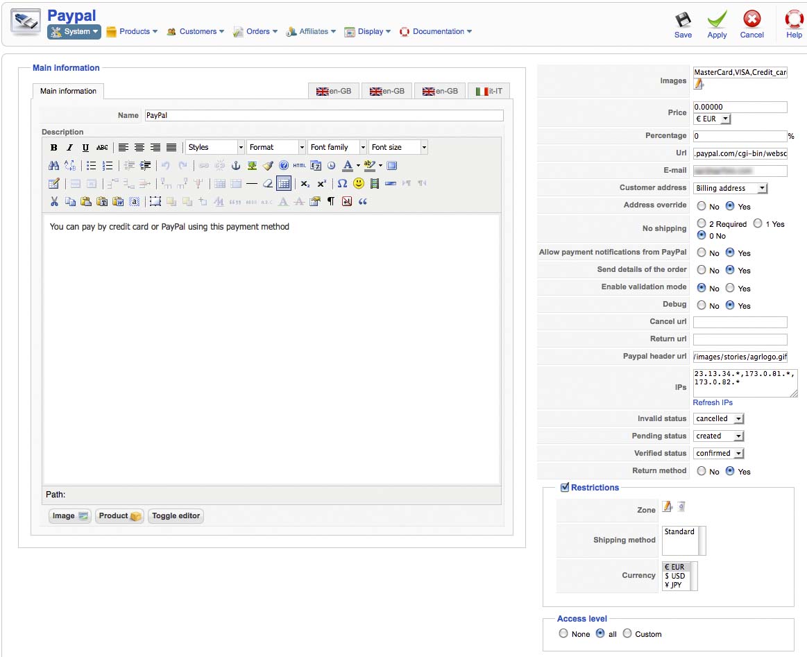

OK, I'm back to where I started. I am still receiving the error:
A Paypal notification was refused because the connection to the confirmation server failed.
openssl is enabled and I have rechecked the settings for HikaShop PayPal plugin (attached screenshot).
Is there anywhere else I need to check settings? API? Keys?

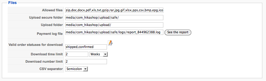

I found one other log file in the /logs/ directory with today's date, it is not displayed in HikaShop config/files
It is 10.3Mb and is the cron log file I think.
I have made a new order (item 45) and still the log file is the same. I've attached screenshots.

Is this correct for the Url in the PayPal plugin settings: www.sandbox.paypal.com/cgi-bin/websc
  • Posts: 86180
13 years 4 months ago #102392
That is the correct URL for the PayPal sandbox yes.

Can you make sure that the report log file's permissions themselves are set to 777 and not just the folder ?
