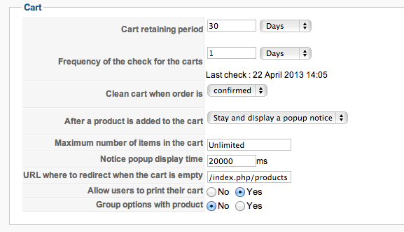

Can you show me how did you configured your add to cart button ("Hikashop->System->Configuration->'Main'->'Cart'") through some screenshots ?
Thank you :).

I have these 2 screenshots, please see attached. Am I missing another configuration place maybe?
Thank you,
-Anna

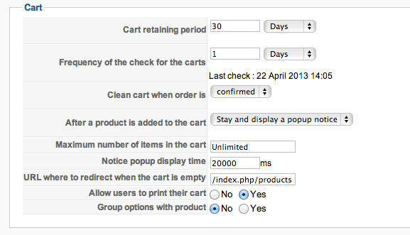

  • Posts: 43
13 years 4 months ago #100386
I see that I got an error when I tried to attach files before.
Attaching the correct file extension now.

13 years 4 months ago #100624
Did you set the "Use AJAX when possible for add to cart buttons" to YES through "Hikashop->System->Configuration->'Main'" ? if not, can you do it and test your add to cart button again ?
The following user(s) said Thank You: anusia
  • Posts: 43
13 years 4 months ago #100646
OMG, that was it, thank you so much!
