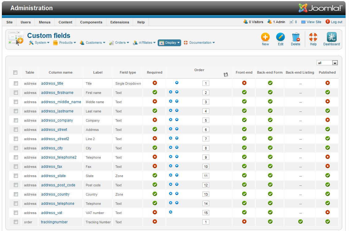

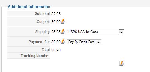

I created a custom field of type order. Here are two screenshots. on the second picture it is the last field at the bottom.

13 years 4 months ago #102104
I think that you'll be able to do it with some code like :
<?php echo "Tracking Number : " . @$data->trackingnumber;
