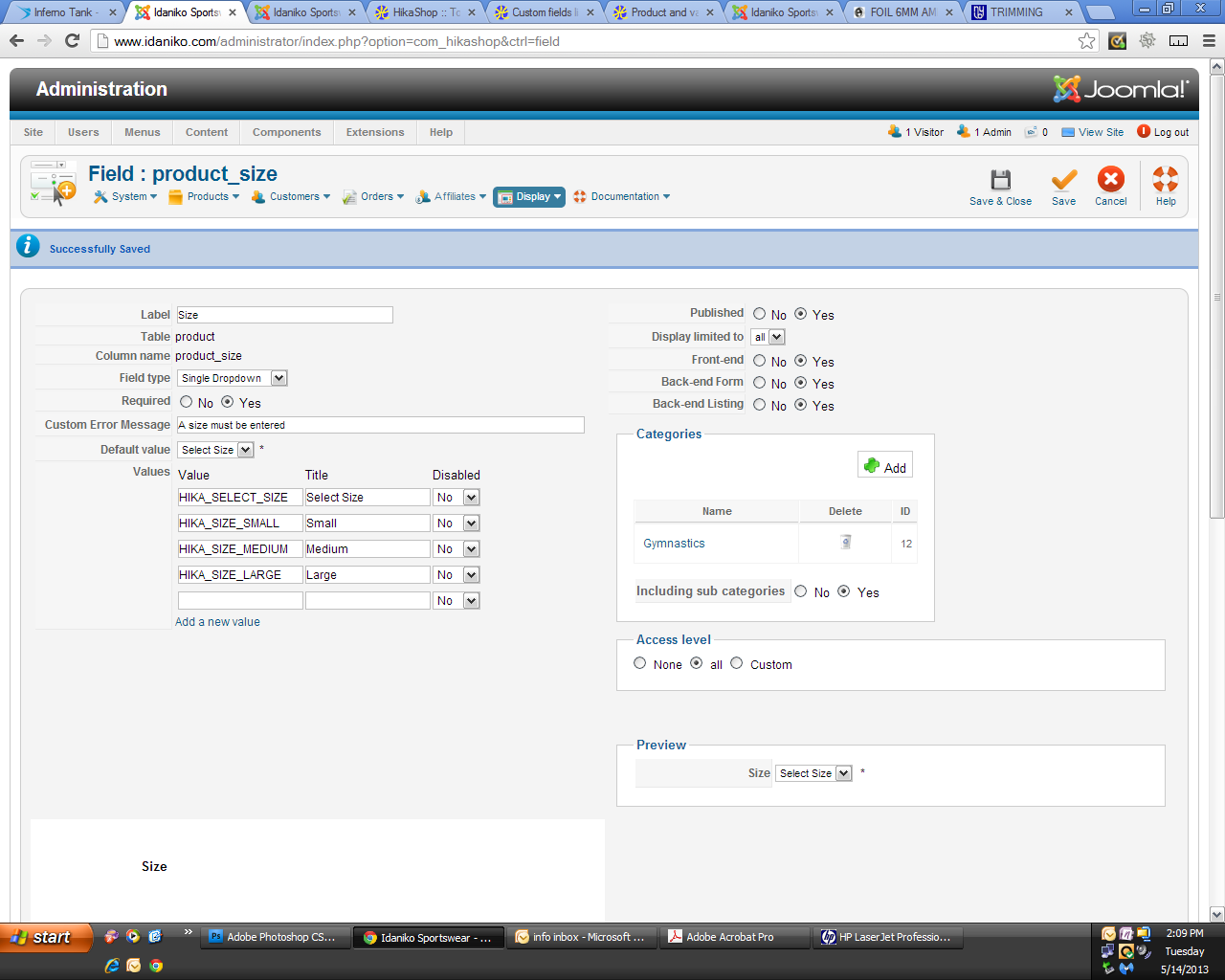

  • Posts: 15
13 years 4 months ago #103965
What do I have to do so that the fixed values (drop down options) are accessible to the customer in the product page? Also what should be done to have the customers selected value appear in the order on the back-end for processing?
Thanks Again,
Last edit: 13 years 4 months ago by jwatson912.
  • Posts: 26386
  • Thank you received: 4078
13 years 4 months ago #103982
Well, as explain in my previous post, product custom field are not the right solution.
So you have to delete the product custom field and create an item custom field.
