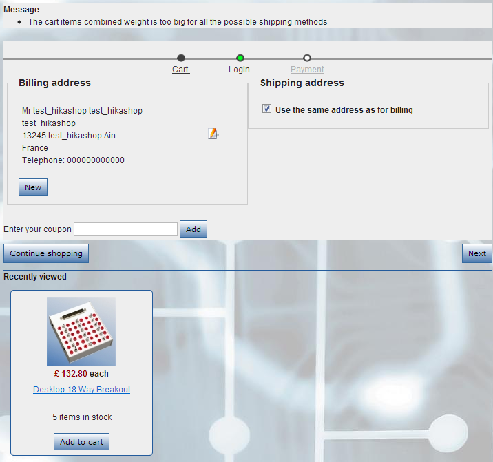

This is abit of an odd request, but I was wondering (as a Premium user I thought I would try my luck!) if you could please test something for me. I have set up a few different delivery options for Europe, ROW, USA and Channel Islands, could you please let me know what comes up for you for delivery charges when you proceed through the checkout to the login plage?

I got an error on your checkout with an address in France:
So something is apparently not correct in your shipping methods setup.
You can't have more than one zone in a shipping method.
However, you can create a new shipping zone in your HikaShop zones manager and add the countries you want as sub zones of that shipping zone and then use that shipping zone in your shipping methods and the shipping method will be available in all the sub zones that you selected for that shipping zone.

Thank you so much for pointing that out. The problem was the product weighed 350grams (0.335kg) and I'd set the minimum weight of the European delivery method from 0.5kg to 1kg, so it wasn't heavy enough to fit in any delivery bracket!
