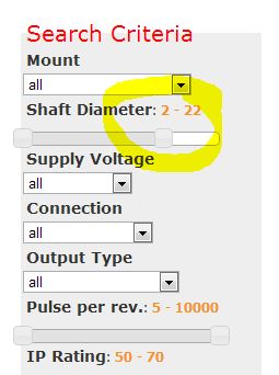

Hi! Just a simple one! Where do I change the colour of the range numbers above the filter cursor? They're currently orange (#f6931f), but appear hard coded to the element. I've searched the CSS for this colour, but can't find it. Image attached.
Any pointers are much appreciated!
Also, does anyone know what 'Cursor Number' means on the cursor filter page?
Many thanks - Leo

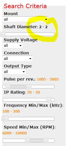

13 years 3 months ago #108077
I think that you'll have to use some CSS code like that :
#ID_OF_YOUR_SPAN_PRICE_FILTER {
color: black !important;
But you'll have to replace this part "ID_OF_YOUR_SPAN_PRICE_FILTER" with the span which is around the price of your filter, in my case it will be : filter_span_price_filter_hikashop_category_information_menu_103
If you can't find it, I'll need a link to your web site.
Hope this will help you :).

13 years 3 months ago #108102
Hi Mohamed.
Many thanks for your reply. Your solution does indeed work, but unfortunately, the site will have a lot of different filters on a lot of different products, and I hoped there would be a more efficient solution than going through the website and adding custom css for every instance.
Your code has only amended one instance, as shown in the attached file.
I guess I really need to find in the source code of where this colour is stated.
Many thanks for your help anyway!
All the best - Leo

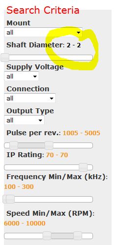

13 years 3 months ago #108118
Ok, The best solution would be to give me a link to your page then I'll probably be able to understand how to do it :).
  • Posts: 46
  • Thank you received: 7
13 years 3 months ago #108120
Thanks Mohamed. Have a look at taylordynamics.com/websitev2/index.php/r...br-shaft-br-encoders
All the best - Leo
13 years 3 months ago #108124
I think that this CSS code will do the job :
#filter_span_Pulse_per_rev__module_168{
#filter_span_IP_Rating_module_168{
#filter_span_Max_Frequency__kHz__module_168{
#filter_span_Maximum_Speed__RPM__module_168 {
#filter_span_Housing_Diameter__mm__module_168 {
The following user(s) said Thank You: lcoombes
