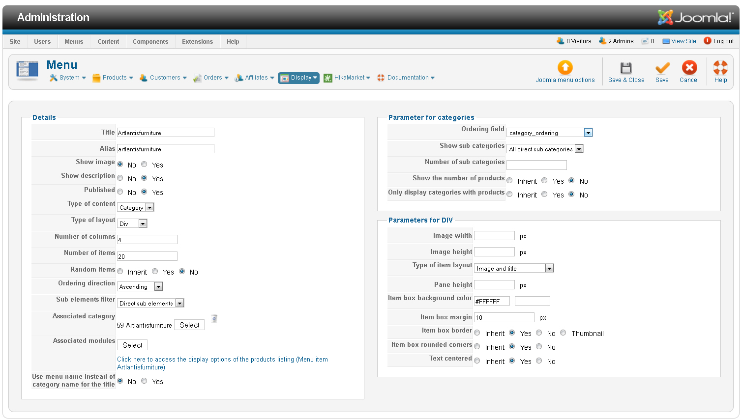

  • Posts: 261
  • Thank you received: 5
13 years 3 months ago #108707
OK,
Here it is.
Sjaak
  • Posts: 86181
13 years 3 months ago #108938
That looks Ok.
