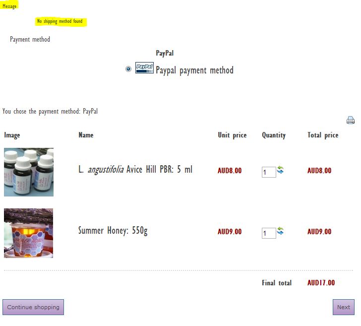

I am having trouble setting up the checkout process on my site.
My checkout will not proceed to any further pages when I hit the "next" button
I have configured a site with Australia Post shipping plugin enabled and Paypal is the only payment method.
Within Australia Post plugin the only method enabled is standard post.
I have not yet loaded all the dimensions and weights on my products but I did it for a few to test the checkout process. However, I am getting an error message "No shipping method found" which I assume is preventing the workflow from proceeding. Why am I getting this message when as far as I can see I have added the shipping method?
Am I right in assuming that this is the reason i cannot proceed?
Please help
thanks
Viv

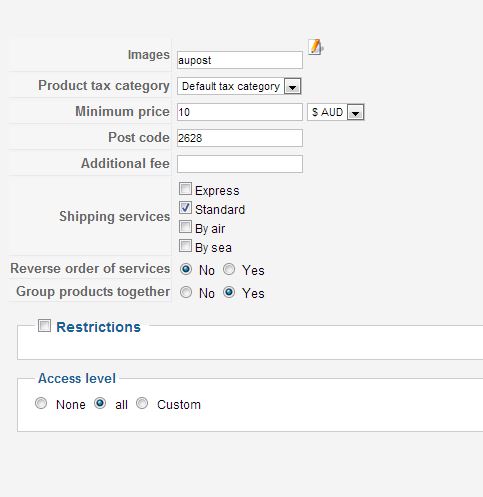

Can you follow each point of the shipping FAQ and tell me if it solved your problem ? also did you set some restriction through your Australia Post shipping configuration page ?

OK. I did as you asked and went through the FAQ. Sorry, I didn't realise I had to set up a manual shipping method so I did one for large items. There are no other restrictions but now I am getting the message "The cart items combined volume is too big for all the possible shipping methods"
I have only added one product to cart which is only 55mm high x 30mm x 30mm and weighs 30g so there is no reason for this message to come up.
What can be going wrong?
Thank you
Viv
13 years 2 months ago #111097
You don't have to set a manual shipping method, I just wanted you to check your Australia post shipping configuration by following some points of the shipping FAQ. However Can you give me a temporary access to your back-end through a private message for testing purpose ?

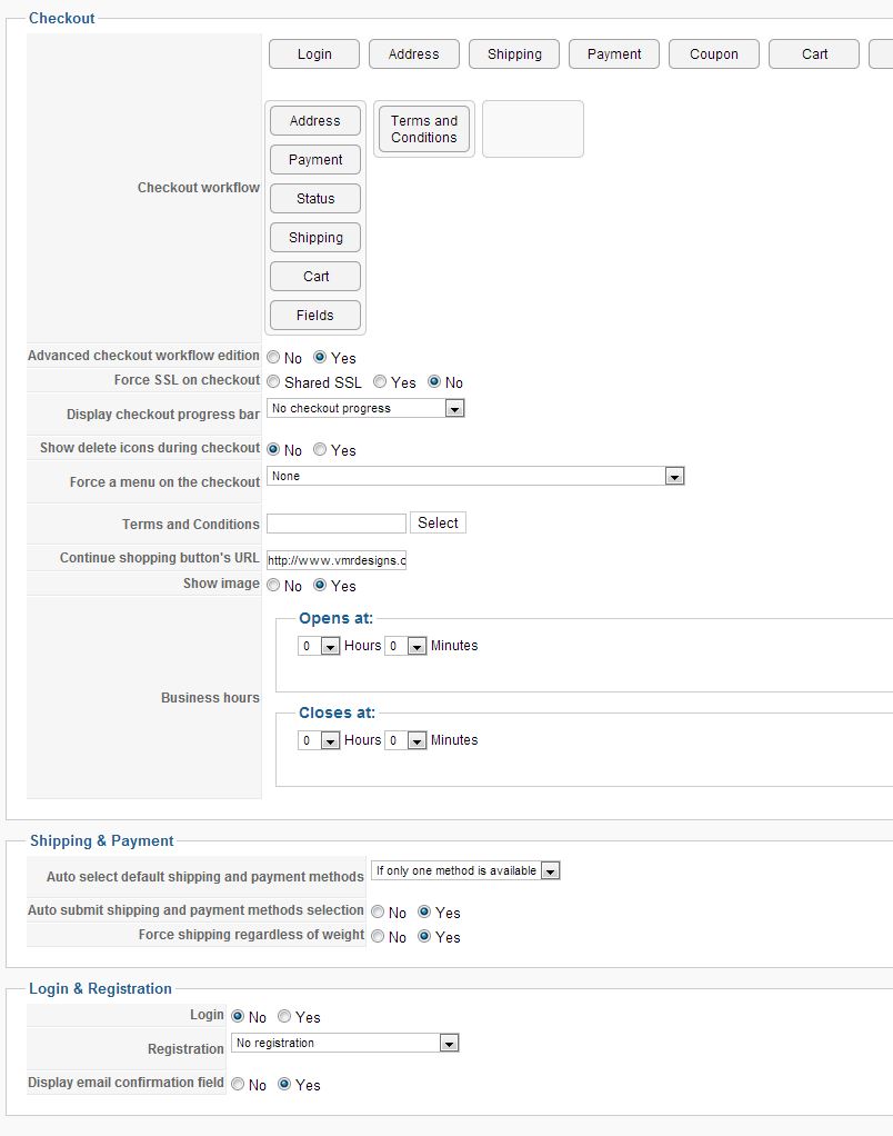

Ok the Australia Post shipping method is correctly showing now, the problem was coming from the fact that you didn't had any login step through your checkout workflow ("Hikashop->System->Configuration->Checkout").

  • Posts: 38
13 years 2 months ago #111453
Thanks for that but Nicholas has pointed out that I had the workflow in the wrong order.
I had enabled the australia post shipping method and configured it correctly but I had the shipping before address in the workflow which means the postcode had not been input for the shipping module to calculate the postage.
All good now.
