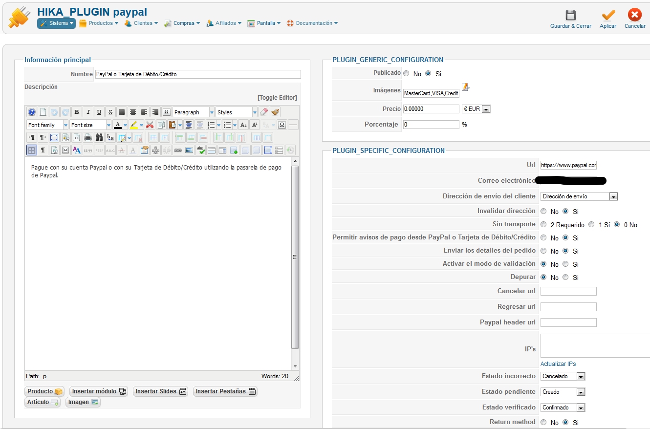

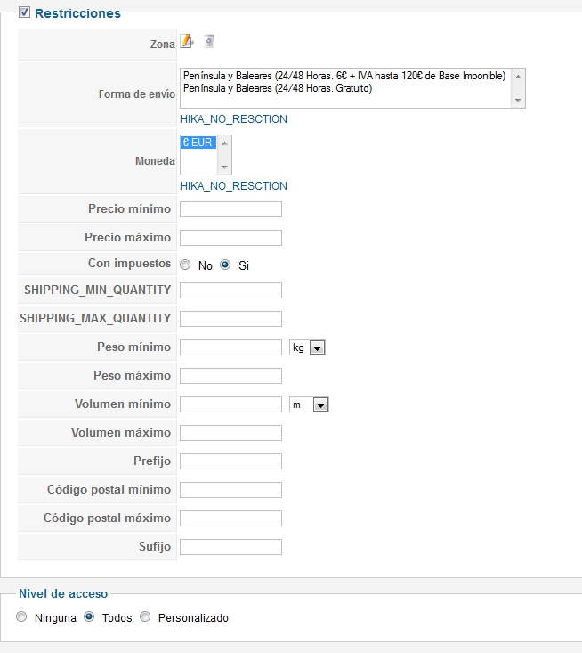

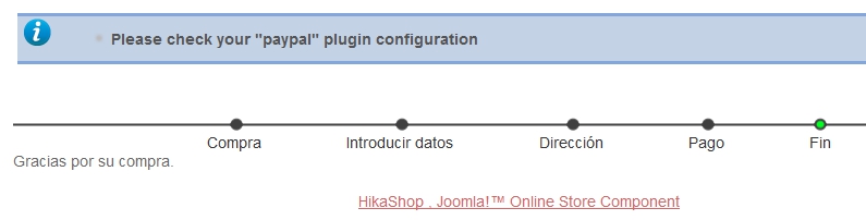

Hello, since I upgraded to version 2.2.0 of HikaShop Business, when I order and I will pay with Paypal, I get an error message:
Attached two screenshots of how I have configured Paypal plugin and the error that appears in the process.
With the previous version of HikaShop worked well. Thank you.
  • Posts: 26386
  • Thank you received: 4078
13 years 2 months ago #111194
I installed in your website the latest version of HikaShop 2.2.0 which contains a fix for the "no shipping" option.
It should work better now.
Thanks for the report.
