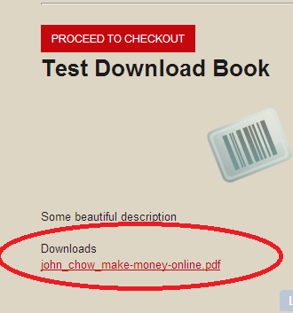

The issue I have is that when I look at the product on my site without being logged in - I can see a link for the product on the page - which if I click on this link I can download the product when bypasses my need for the perform to login and go through the checkout.

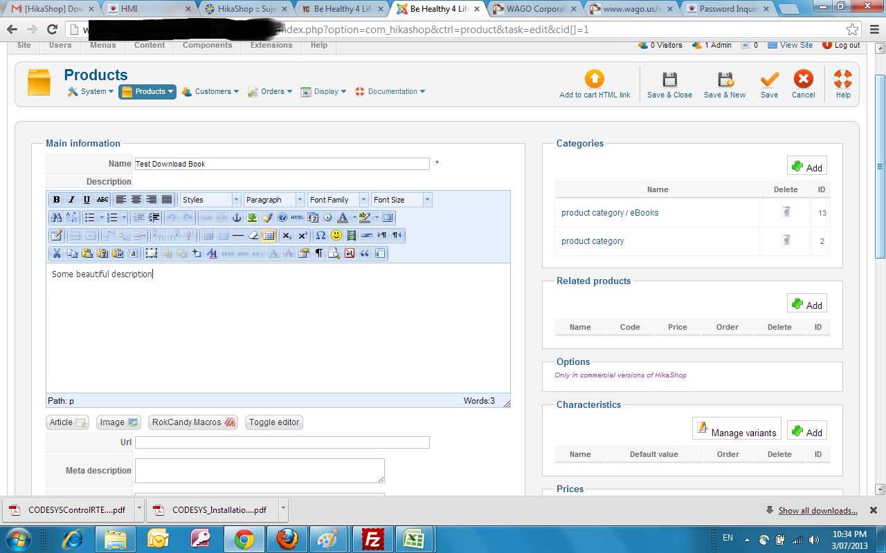

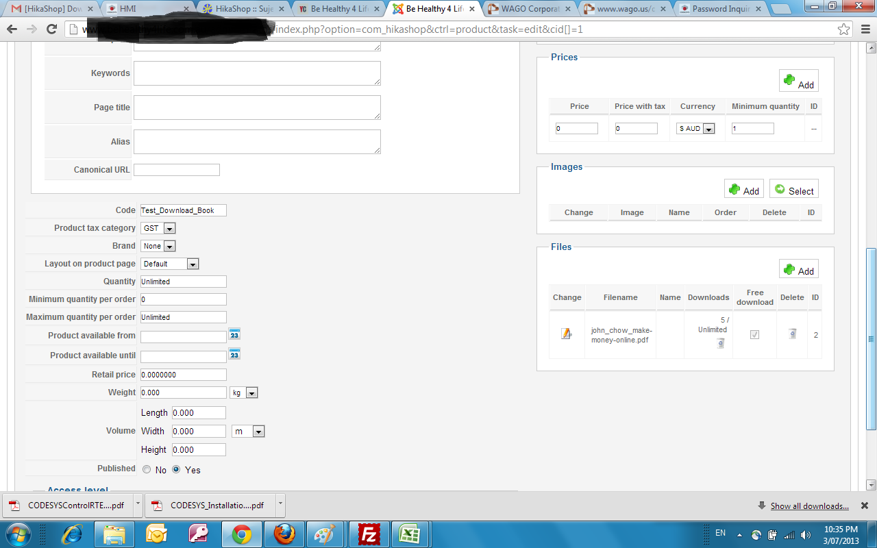

Ok, and can you show me through a screenshot how did you configured your product ? If you putted it through your product's description you'll just have to remove it :).
Last edit: 13 years 2 months ago by Mohamed Thelji.
  • Posts: 4
13 years 2 months ago #111925
No problems - please see attached.
Last edit: 13 years 2 months ago by bstemp.
13 years 2 months ago #111931
Ok the problem is coming from the fact that you have put the "free download" option to YES through your product file configuration :).
