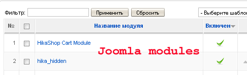

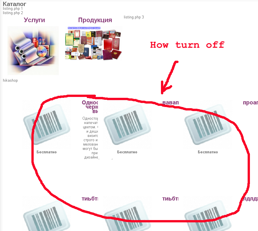

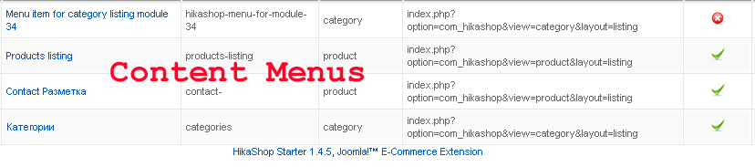

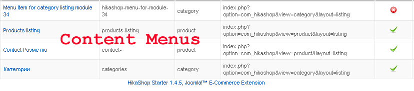

How to disable the output of goods under the category list ?
This is a list of categories (index.php? option = com_hikashop & view = category & layout = listing & Itemid = 74)

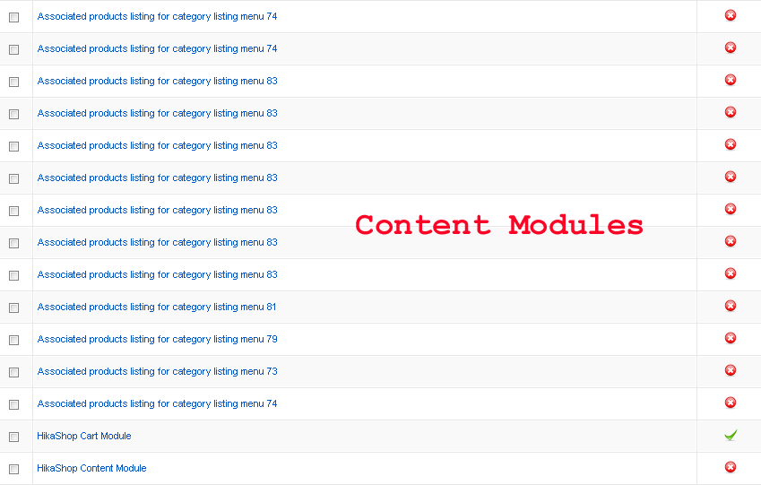

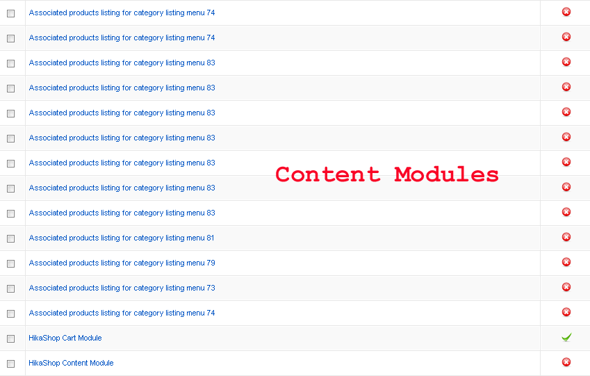

Could you go in the menu Display->Content modules, edit the module associated with your menu (with the menu id 74) and make sure that the element filter is set to display only direct sub elements ?
Last edit: 15 years 6 months ago by nicolas.
  • Posts: 50
  • Thank you received: 4
15 years 6 months ago #8491
Yes, I do it. But no result.
U can see at volprint.ptzhost.ru/index.php?option=com...ut=listing&Itemid=38

  • Posts: 86096
  • Thank you received: 14200
15 years 6 months ago #8492

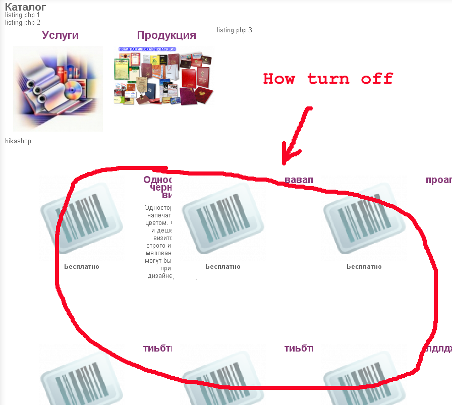

I don't see the problem. You have two products in the main category. So the are displayed on the listing. That's all.

Products must be in categories, but I do not want to show them under the categories.
  • Posts: 86096
15 years 6 months ago #8497
Then edit those products and change their category. Actually, the products test1 and test2 are assigned to the category "Product category", so when you display the listing of categories, it will display these products under that category. Since that category is the "parent category" of your menu, you see your products directly in the first page of the menu. That's totally normal. If you want to show them in how of the sub categories, you just need to set that sub category in the listing categories of the product and remove the main category from that list.
