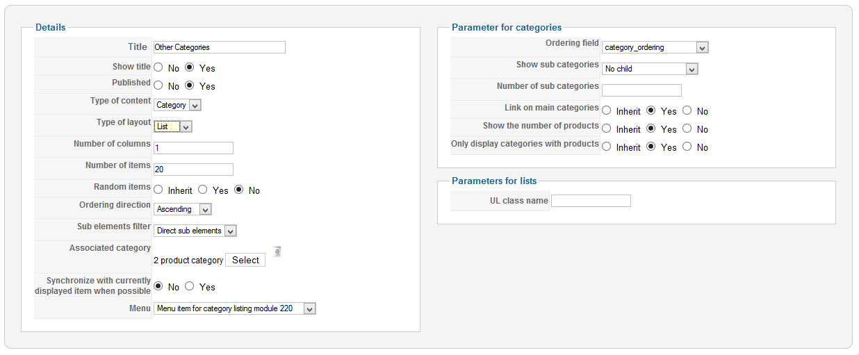

13 years 2 months ago #114127
Ok,
Did you set the "menu" option of your Hikashop module ? Can you show me how did you configured your Hikashop module through some screenshots ?

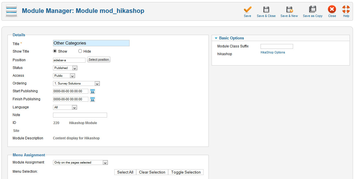

13 years 2 months ago #114243
Please see the attached screen shot of the Module and the Hika Mod...
I have turned SEF and URL rewriting back on for the client
  • Posts: 86212
  • Thank you received: 14221
13 years 2 months ago #114426
The "menu" option of modules allows you to configure on which menu item the links of your module are pointing to.
When SEF is activated, joomla needs that data to be able to translate the SEFed url and understand what component should be called.
If you configure a menu which doesn't exist anymore or which is not configured properly to display a listing of products, the links won't work.
So just sure that this option is configured with a valid menu item and the links of your module will then work properly.
