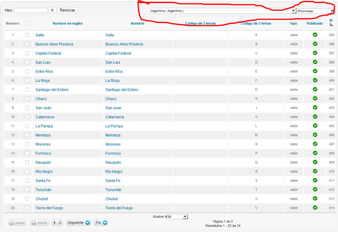

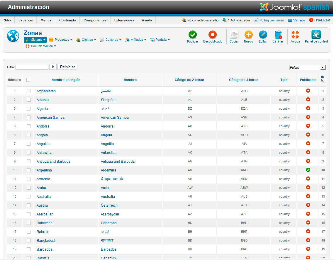

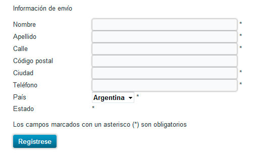

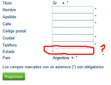

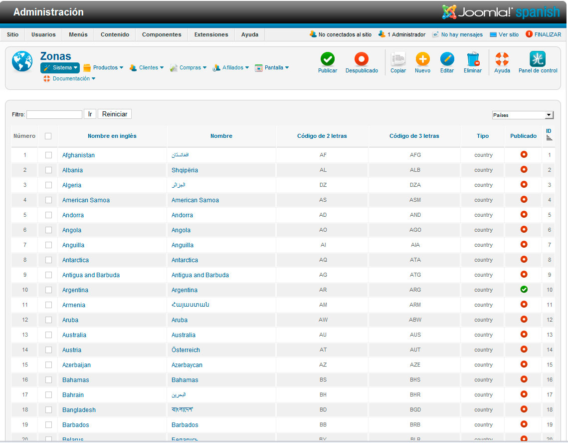

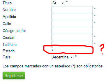

Hi. I have HikaShop configured with a single country: Argentina.
And I want you to show me the select "Provinces", only the provinces of Argentina.
In the zone configuration, uncheck all countries except Argentina. And in the configuracción of "Provinces" (states) published only in Argentina. However do not appear on the registration form. It only appears the "Country" and the field name "Province", but the field in the form.
If I activate another province other than Argentina, select field appears on the form, but only that it is the province of Argentina. Those of Argentina not appear.
I have enclosed pictures.
Thank you very much in advance for your help.

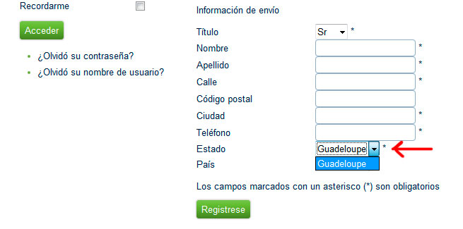

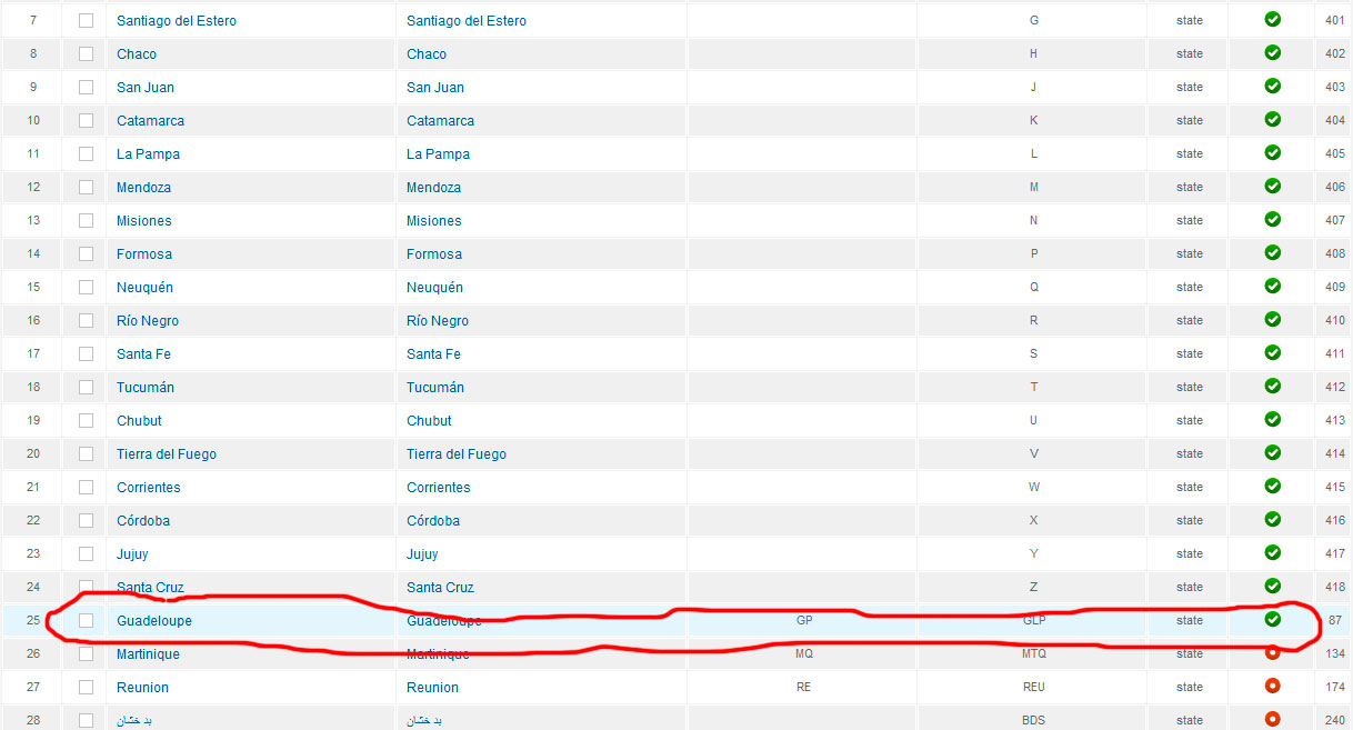

12 years 11 months ago #116788
Thank you for your prompt response.
We do not edit any files on "Display" and browser javascript working properly (tried several browsers).

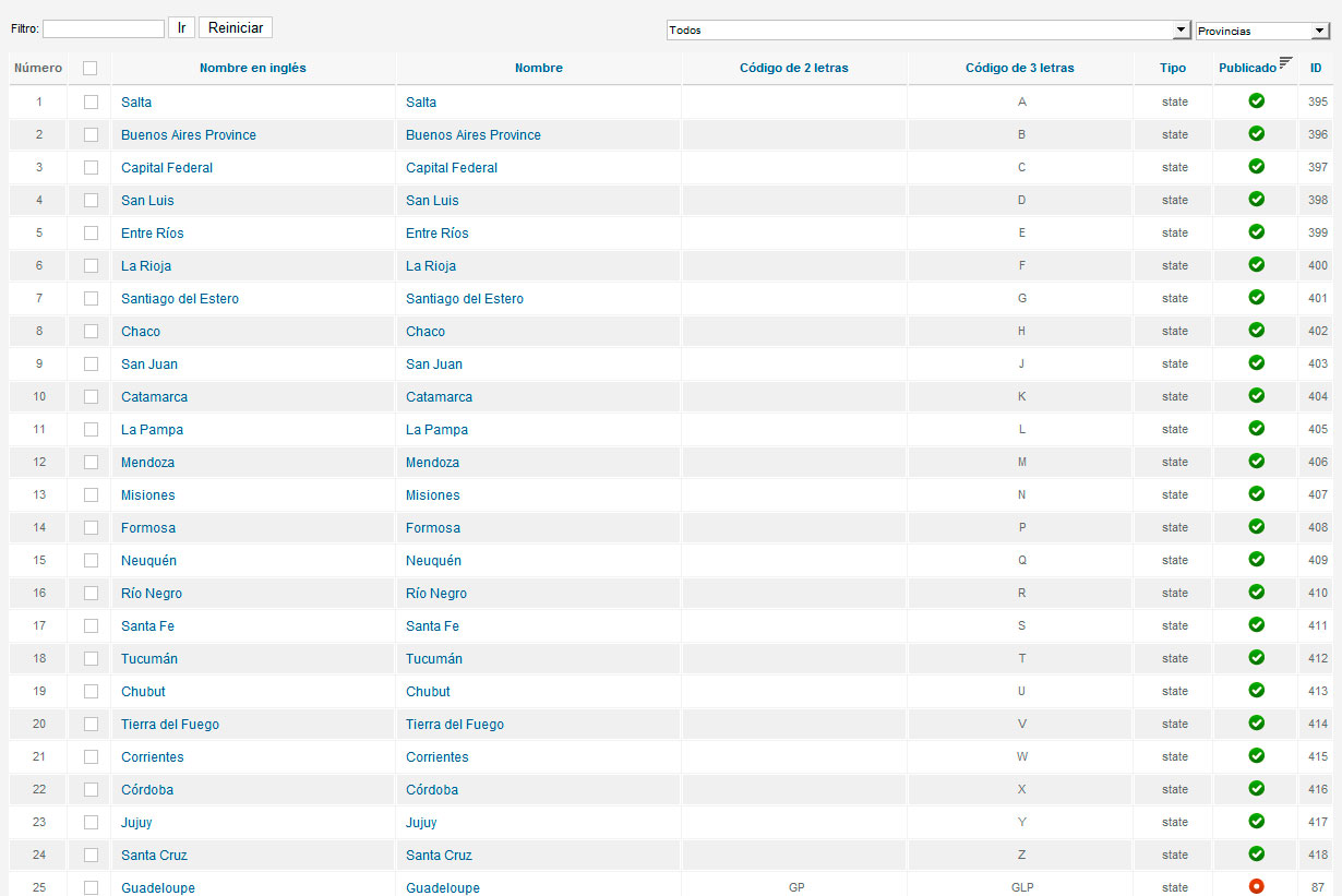

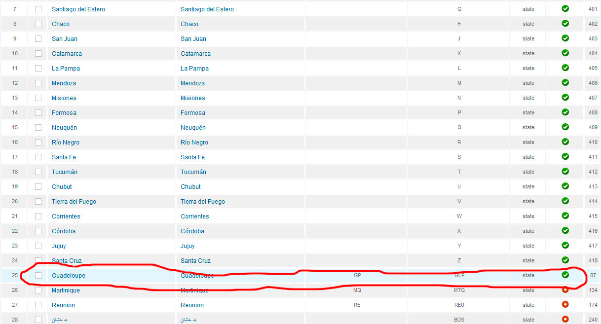

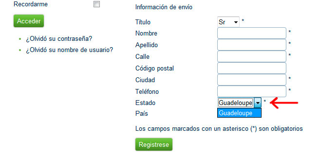

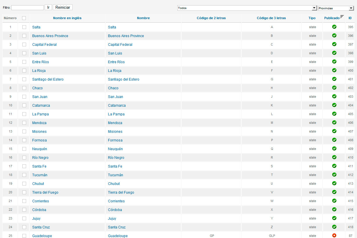

I think I expressed correctly. I am enclosing 2 new screenshots to show my problem.
In the first snapshot you note that I am turning the state "Guadeloupe".
Activating this state, the "province" of the form reappears, but in the drop down menu only appears the "Guadeloupe". They would have to appear all Argentine provinces because they are activated as well, and do not appear.
Thank you very much and I hope your answer.

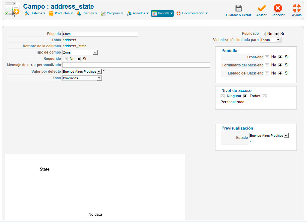

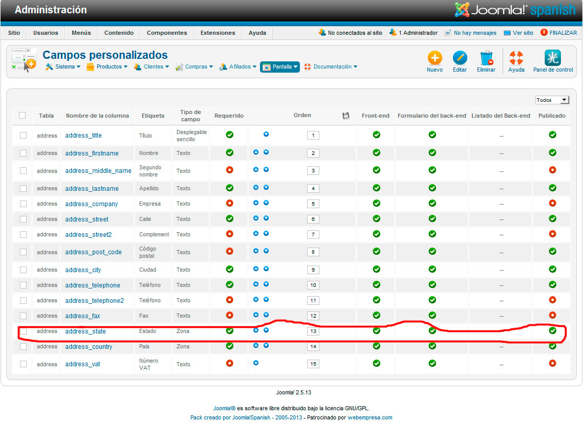

Indeed this custom field has to be published. The issue is probably coming from it configuration.

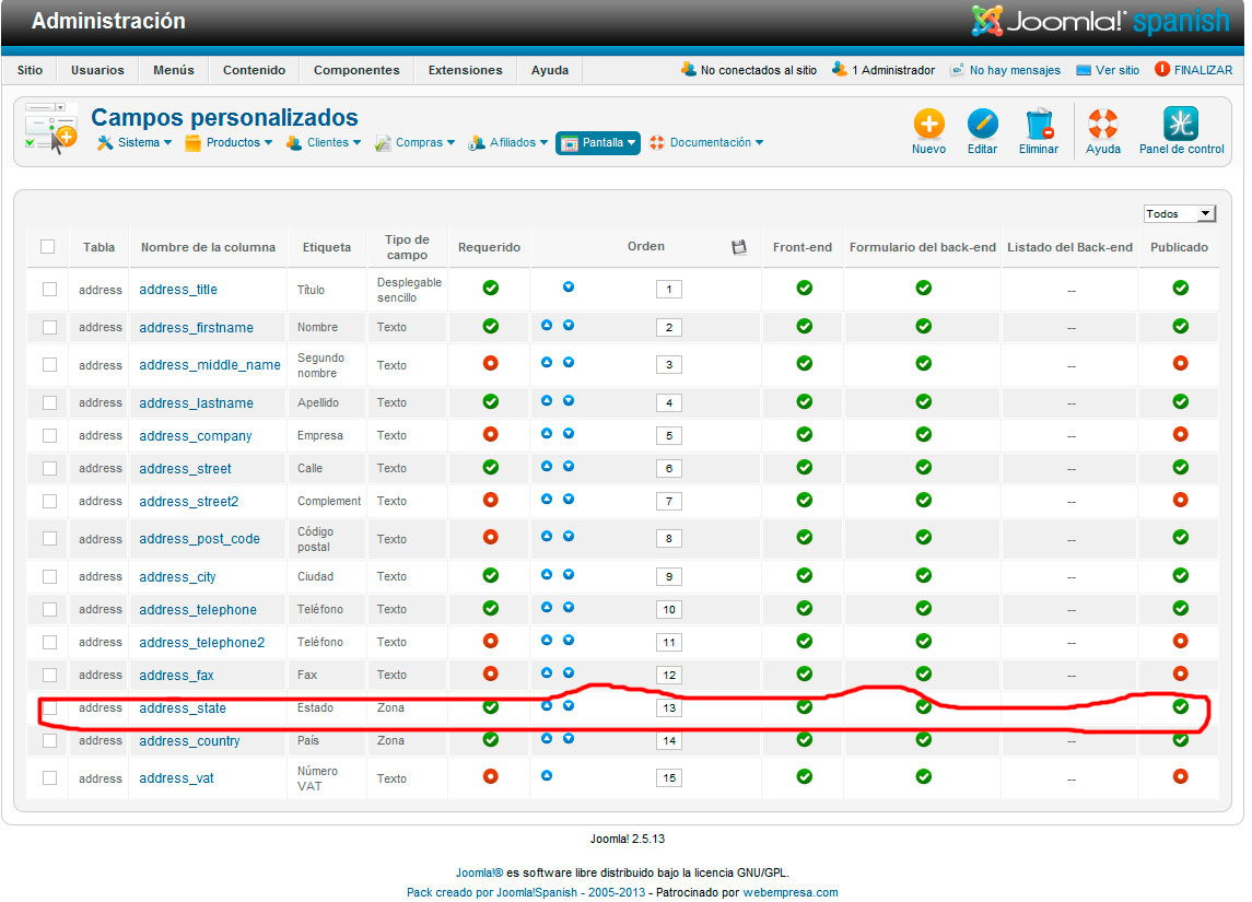

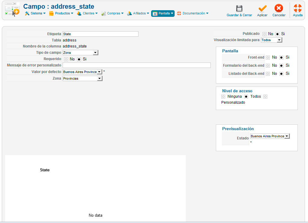

Could you please check that the "Zone" option is correctly configured to state?

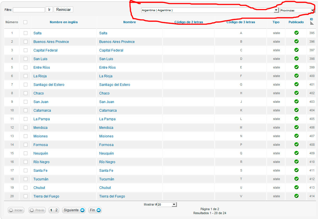

A screenshot of this configuration page could also help us.
  • Posts: 86
12 years 11 months ago #116833
Eliot.

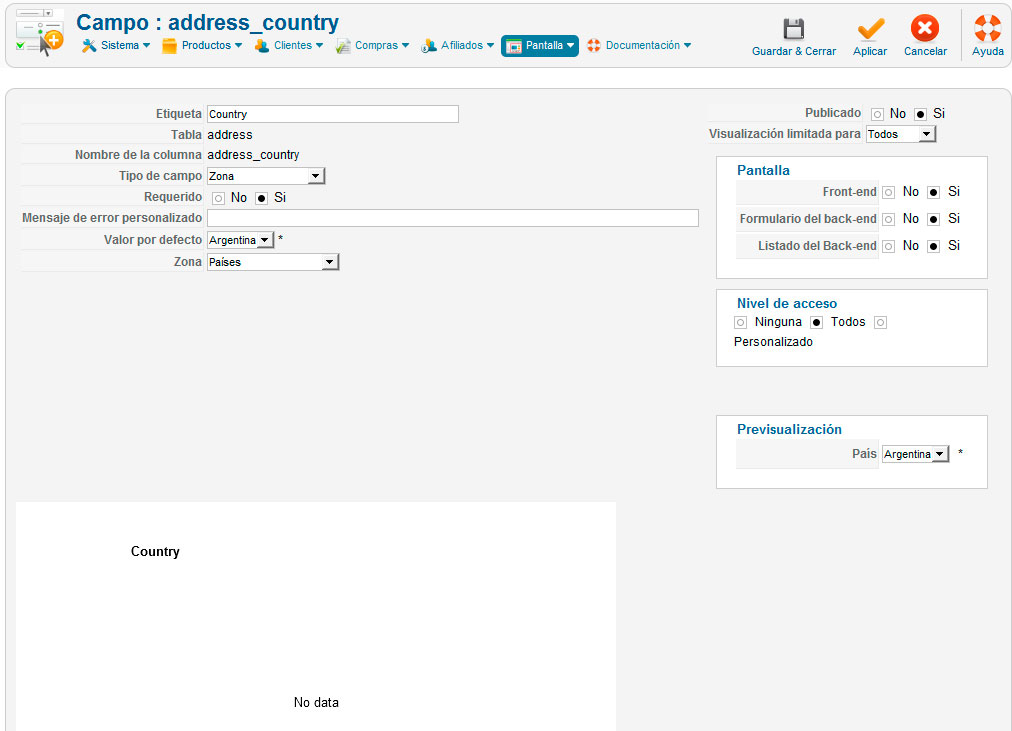

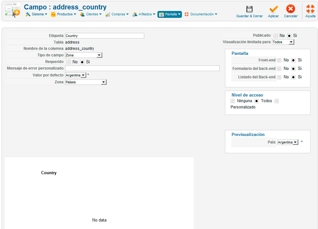

I attached the requested screen shots.

12 years 11 months ago #116847
You simply need to save the settings of the custom country field and then the settings of the custom state field as their default values in the database is still the previous ones.
  • Posts: 86
12 years 11 months ago #116850
Excuse me but I can not understand. Could you explain a little better. thank you very much from now.
  • Posts: 85796
  • Thank you received: 14089
12 years 11 months ago #116854
Simple. Go there: www.hikashop.com/media/kunena/attachments/7826/h35e4078.jpg
Edit the custom country field and click on "save".
Then, edit the custom state field and click on "save".
The following user(s) said Thank You: copyman
  • Posts: 86
12 years 11 months ago #116856
Thank you so much! It worked perfectly! :woohoo: :woohoo: :woohoo:

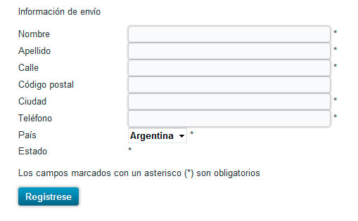

Buenos días.
Hoy he vuelto a tener este mismo problema. La version de Hikashop es la Business: 2.2.1.
He realizado los pasos que me indicó Nicolas, los cuales antes funcionaron bien pero ahora ya no funcionan.
No se si será unbug de esta última version.
Lo extraño es que por mas que guardo el pais y las provincias, en vistas > campos personalizados, los cambios no se ven reflejados.
No creo que sea un problema de javascript, ya que he probado con varias plantillas y tengo el mismo problema.
Adjunto capturas.
Muchas gracias desde ya.
