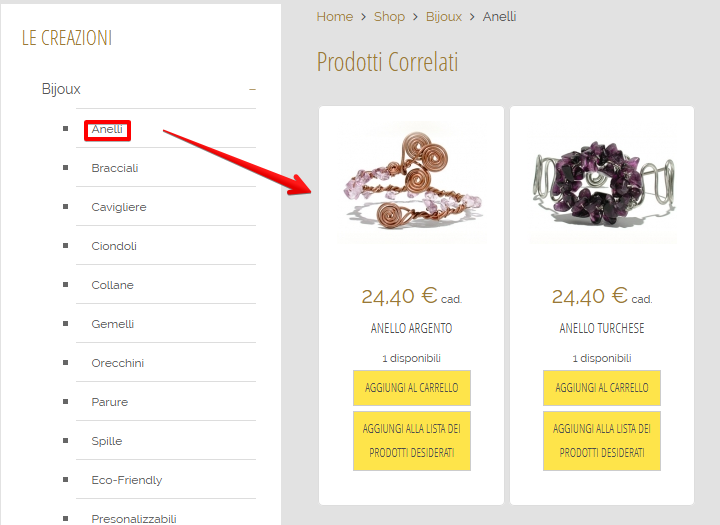

Hi, I read a lot of posts in this forum but I cannot understand why I have this problem.
I created a SHOP menu with product listing, associated with module product related listing.
The filters works correctly but when I click on a subcategory with product (ex. bijoux>anelli or bijoux>collane) no product is shown.
Can you please help me? Thanks!

The problems are not with filters, but with menu on the left "le creazioni".
If you click anelli no results are shown, but there are 2 products.
Thanks!

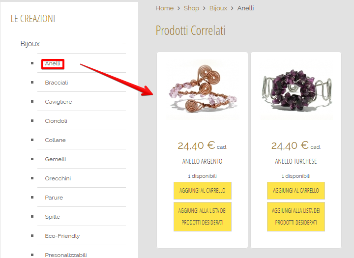

The problem still exists. The product you see come from the module "PRODOTTI CORRELATI", are not all the product in category. If I unpublish the module the categories are empty, I'll do it for you so you can see.
In subcategory ANELLI there are 2 products but I can't see them.

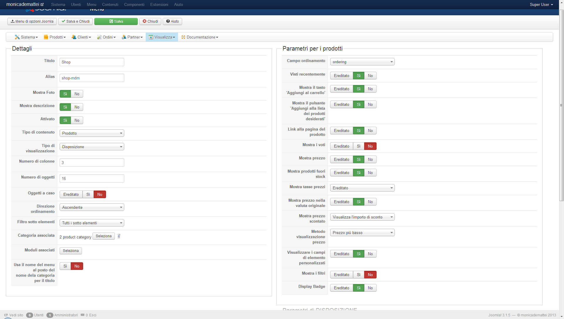

I attach the screenshot of the menu SHOP so you can see if anything is wrong.
Hope everything is clear now, thank you!

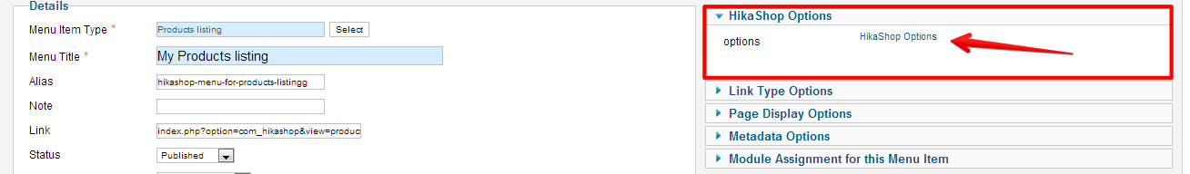

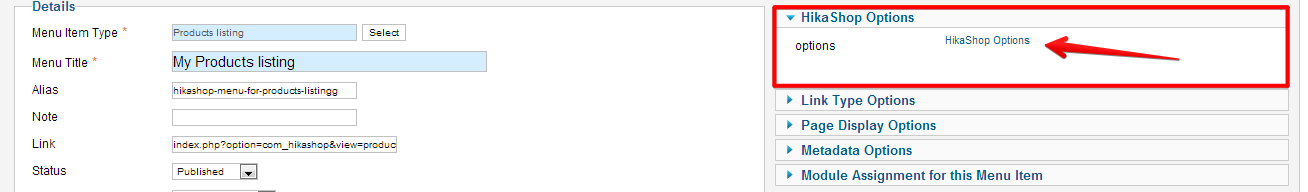

Ok, your menu's type don't seem to be an Hikashop one, the solution will probably be to :
- Go to the Joomla configuration page of all of your sub-menu like Anelli
- Set the "Menu Item Type" option of your Joomla menu to "Products listing"
- Then you'll just have to configure your product listing content menu that will be link to this menu (by using the HikaShop Options link)

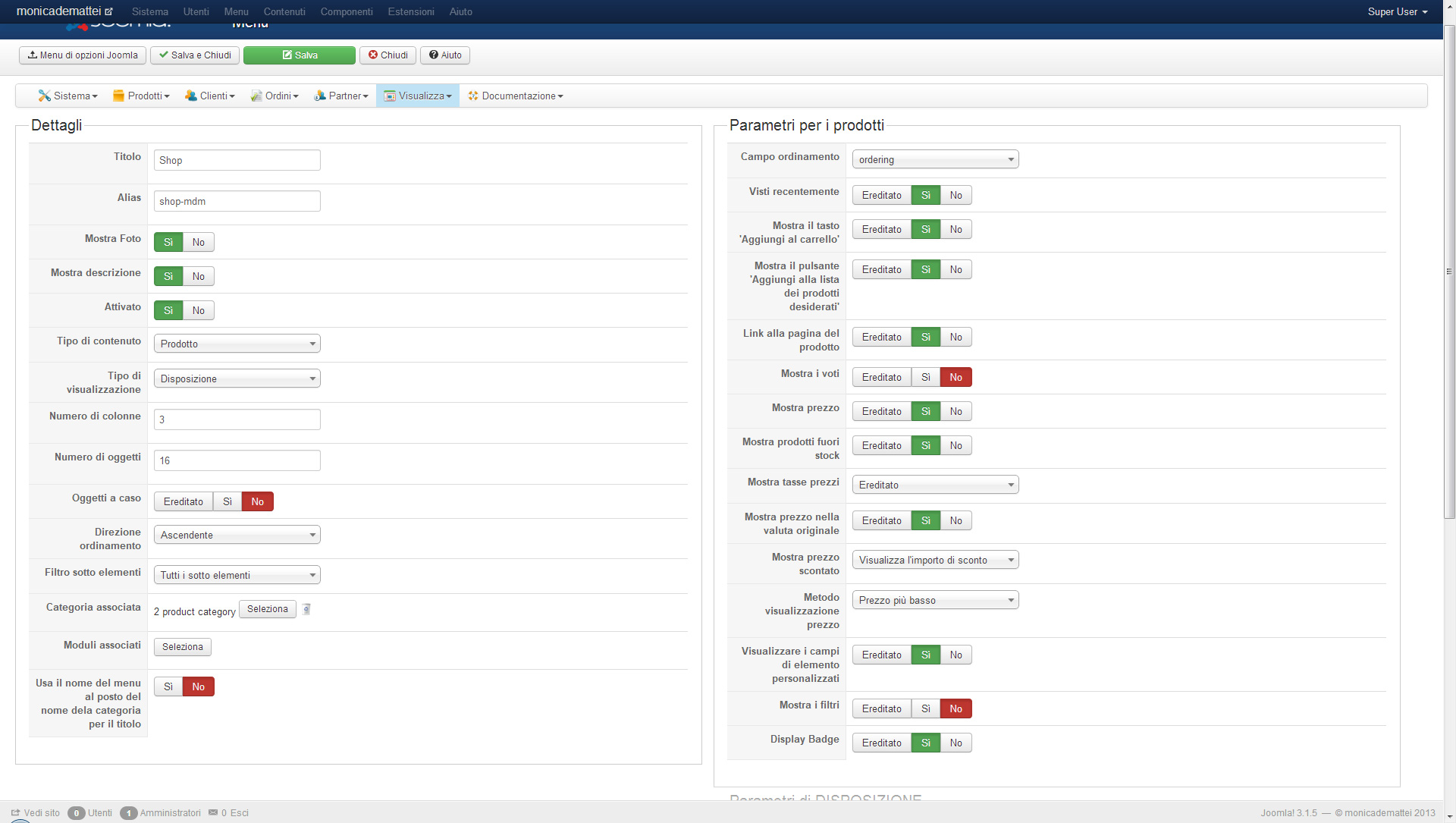

Sorry but my menu is not a category listing but a product listing, I attached a screenshot about it, so I cannot understand what's wrong.

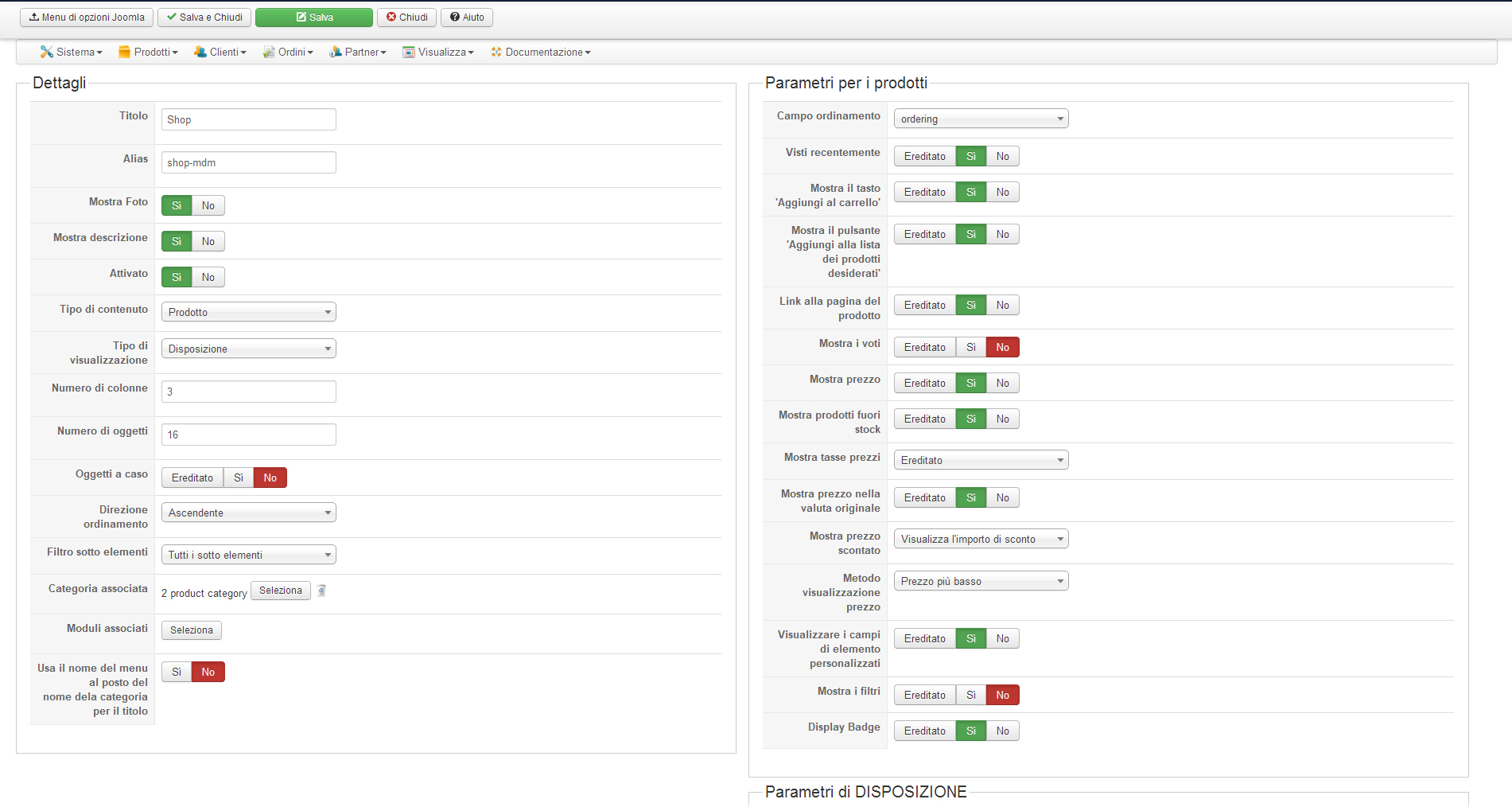

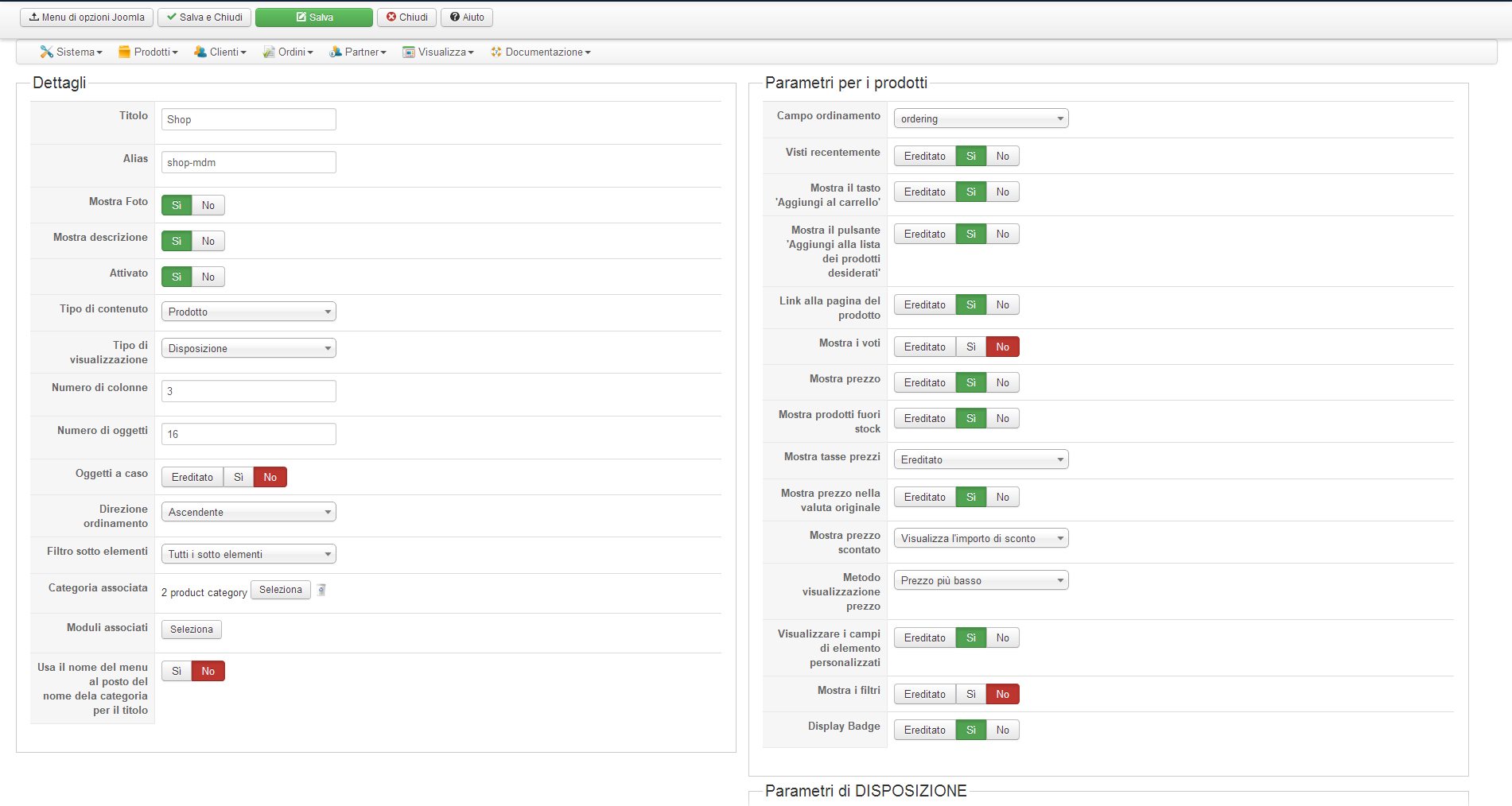

the menu SHOP is a product listing, I attach again the screenshot so you can see.
I cannot understand the problem, really. I read carefully what you told me, but it's all as you said, I'm sorry. If you want an access to backend let me know, thank you.

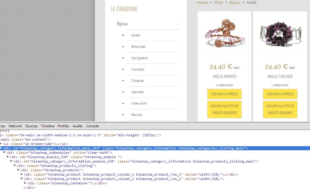

For what I see, you attached a product listing module to your category listing menu.

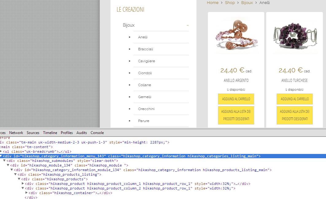

As you can see in the screenshot, your category listing menu (menu id : 143) has not something in his "submodules" : a product listing module (module id: 134).
id="hikashop_category_information_menu_143" class="hikashop_categories_listing_main"
Is for a category listing menu.
id="hikashop_category_information_module_134" class="hikashop_products_listing_main"
Is for a module attached to a category listing menu. The module is a product listing.
