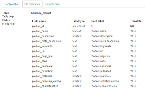

  • Posts: 3
12 years 6 months ago #146161
I've installed in Falang the updated xml with added custom fields.
It is well recognized by falang that also shows the sample data with all the fields.
But the added fields doesn't show up in the translation form for the product, what else to do ?
Thank you for your help

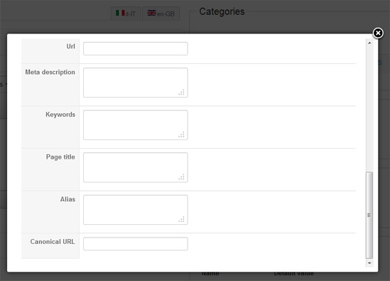

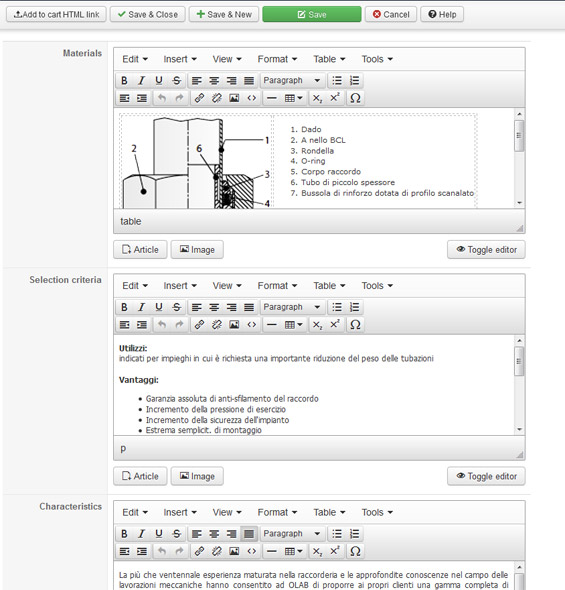

  • Posts: 99
12 years 6 months ago #147634
I attach here some screenshot about configuration and views where custom fields are missing ...
Thank you for any suggestion
  • Posts: 86180
12 years 6 months ago #148557
Adding the fields as being translatable in Falang/JoomFish won't make them appear in the translation edition popup of Hikashop.
What that allows you to do, is to translate them via the translation interface of Falang/JoomFish.
So it's actually normal.

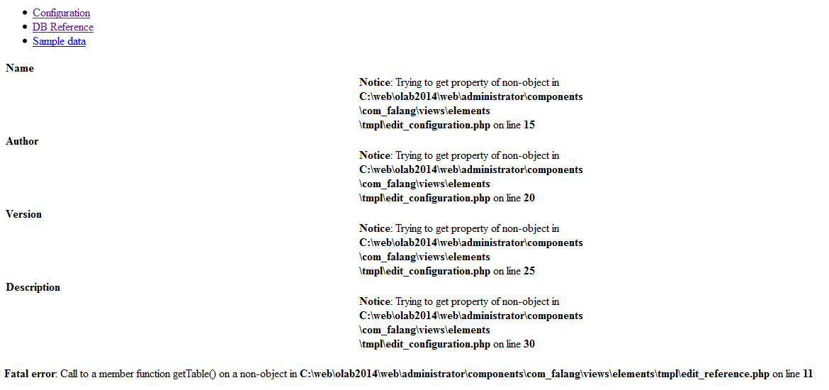

  • Posts: 99
12 years 3 months ago #156503
I've the latest 1.40 falang, this problem comes after the update of hikashop, previously with J3.3 and Falang 1.40 it works fine.
This should be connected to custom fields previously added, but in hikashop backend they still works fine.
Here is a screenshot with the debug/error_reporting enabled if I try to access the "Content Elements - Hikashop Products" section.
Also if I try to access the Translations sections the hikashop products are listed, clicking on a product it reports a white screen with this error:
Fatal error: Call to a member function getTable() on a non-object in C:\web\olab2014\web\administrator\components\com_falang\models\ContentObject.php on line 738
I've also tried to uninstall an reinstall Falang but nothing changes ...
