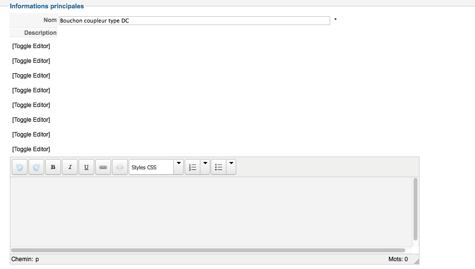

12 years 9 months ago #133544
There is as many "Toggle editor" buttons as the total number of fields appearing per field.
See the picture below.
Does someone have an idea please ?
12 years 9 months ago #133547
I think you have 8 editors in the same page.
JCE does not handle the multi-editor. You can only have one editor per page.
So you have to use another editor or no use JCE for your product custom fields.
  • Posts: 4
12 years 9 months ago #133549
Yes I have 8 editors in the same page, but does Hikashop handle the multi editor when there are custom fields?
Because it's Hikashop that loads 8 times the init code isn't it ?
  • Posts: 86081
  • Thank you received: 14190
12 years 9 months ago #133558
HikaShop has no problem loading several editors on the same page. The issue here is that JCE doesn't support that on its end.
If you use another editor, like tinymce, it will work (you can change the editor in the corresponding option of the HikaShop configuration.
