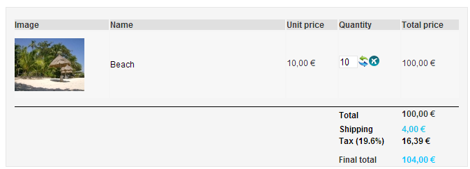

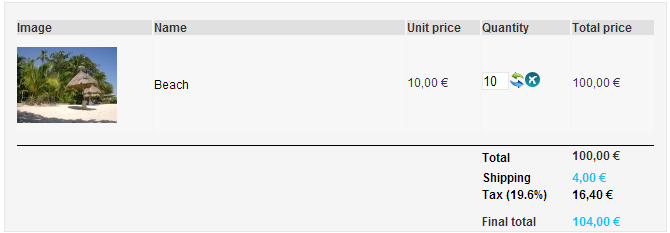

  • Posts: 86081
  • Thank you received: 14190
12 years 8 months ago #135605
I don't understand how you get that.
Here are my results on the demo website:
That is without calculations rounding.
The price of the product is €8.3612
When you multiply by 10, it's €83.612
Then you add the taxes (19.6%) on it: 99.999952 which is then rounded to €100
The taxes are: 99.999952-83.612=16.387952 which is then rounded to €16.39
So these calculations are perfectly correct.
That is with the calculations rounding.
When you multiply by 10, it's €83.612 rounded to €83.61
Then you add the taxes (19.6%) on it: 99.99756 which is then rounded to €100
The taxes are: 100-10*8.36=16.40
So these calculations are perfectly correct too.

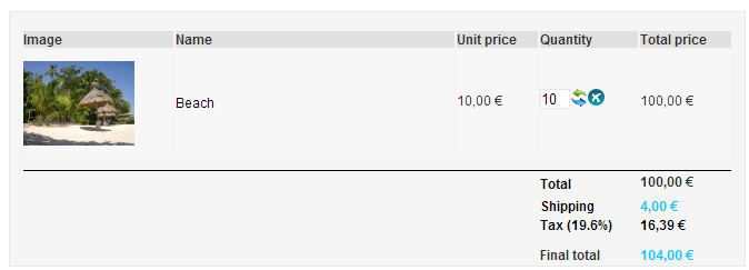

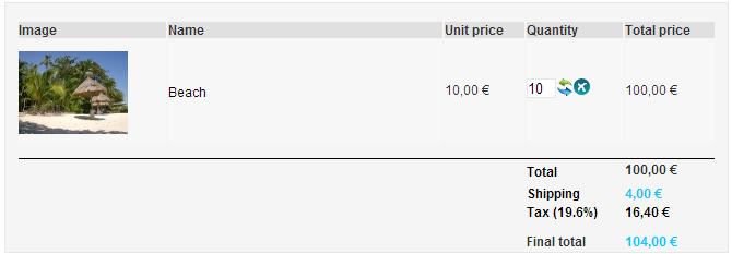

  • Posts: 86
12 years 8 months ago #136436
Hello Nicolas.
sorry for forgetting to tell you that the error ocurred when VAT is set to 21% (instead of 19,6%).
I made some more tests using your demo shop. This time I just modified the net price of a certain product.
I observed differences in the calculations when "Round prices during calculations" si set to Yes or No.
Please see the attached excel file or the image to see the results of my tests. The file shows the results of the calculations in the cart of your demo shop
I am not quite sure when the error ocurrs. Some tims the tax amount shows an error, and some times it is the total amount which has the error.
I hope this helps to identify the cause.
Thank you!
Last edit: 12 years 8 months ago by scharfet.

  • Posts: 86081
12 years 8 months ago #137395
Again, I don't see the problem with your tests:
The price of the product is €8,26447 (there are 5 decimals saved in HikaShop so that's what becomes €8,264465)
When you multiply by 10, it's €82,6447
Then you add the taxes (21%) on it: 100,000087 which is then rounded to €100
The taxes are: 100,000087-82,6447=17,355387 which is then rounded to €17,36
The price of the product is €8,26447 rounded to €8,26
Then you add the taxes (21%) on it: €9,9946 which is then rounded to €10
When you multiply by 10, it's €100
The taxes are: 100-10*8.26=17.40
I still don't see what you want me to fix as so far all the examples I tried from you worked out properly.
