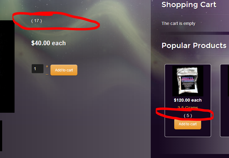

We are using the jbetolo plugin for front-end optimization on our website (site load times in 0.8 - 1.2 seconds :cheer: ). However, the product rating stars are not showing when we merge javascript (attached example). The javascript merging is giving us our best performance gains, so we'd like to be able to use it.
I'm wondering what I need to exclude from being merged, or what load order of the js I need for the rating stars to properly display. Or, perhaps there is an alternate workaround?

Yes you need to exclude the javascript of HikaShop from being merged together. Then it should work fine.

I've finally found the fix and issue, if anyone else is having problems with java optimizations. It was deferring the javascript, which caused the issue. Everything else works fine minified and compressed, it just can't be set to defer.
