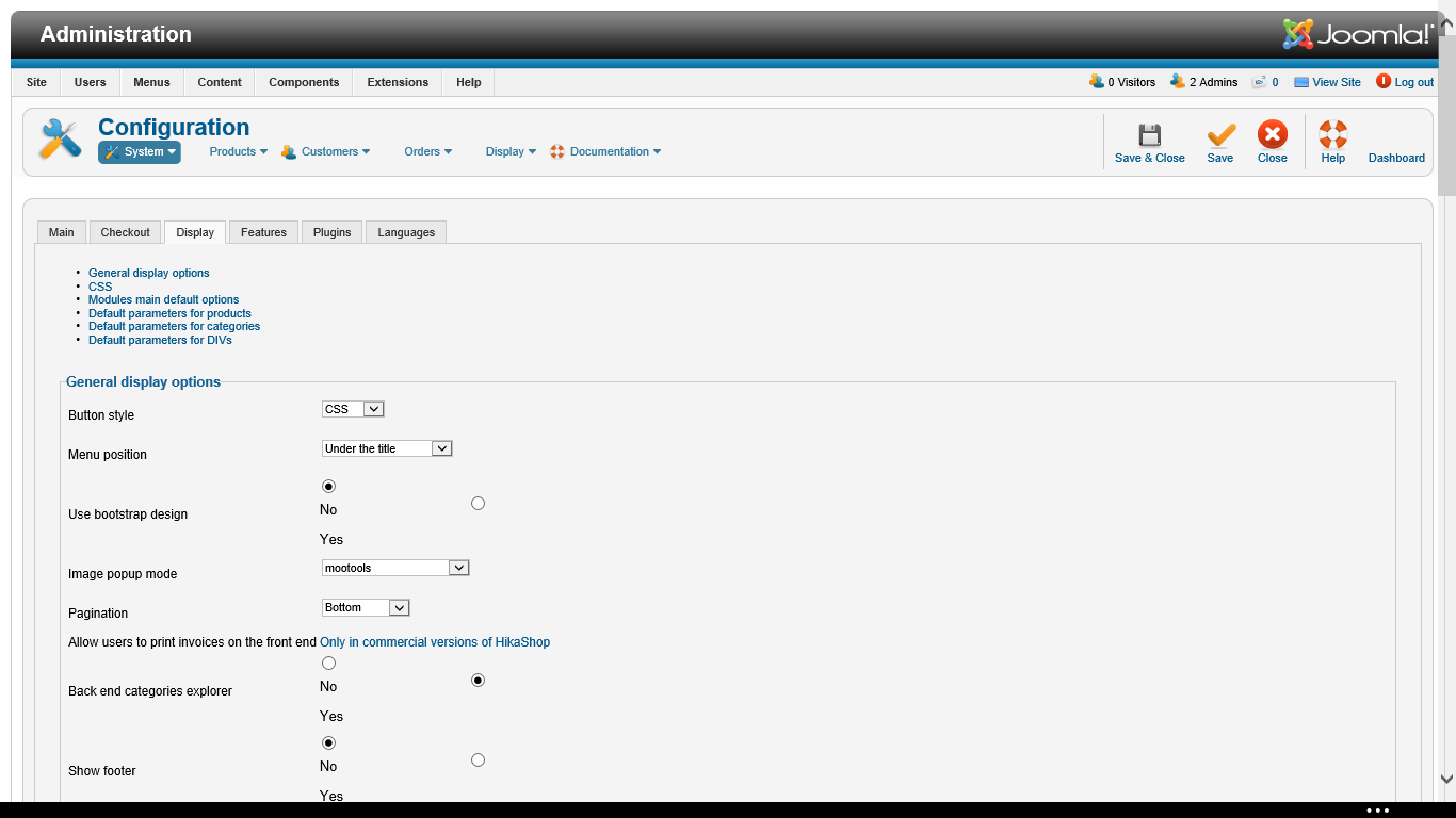

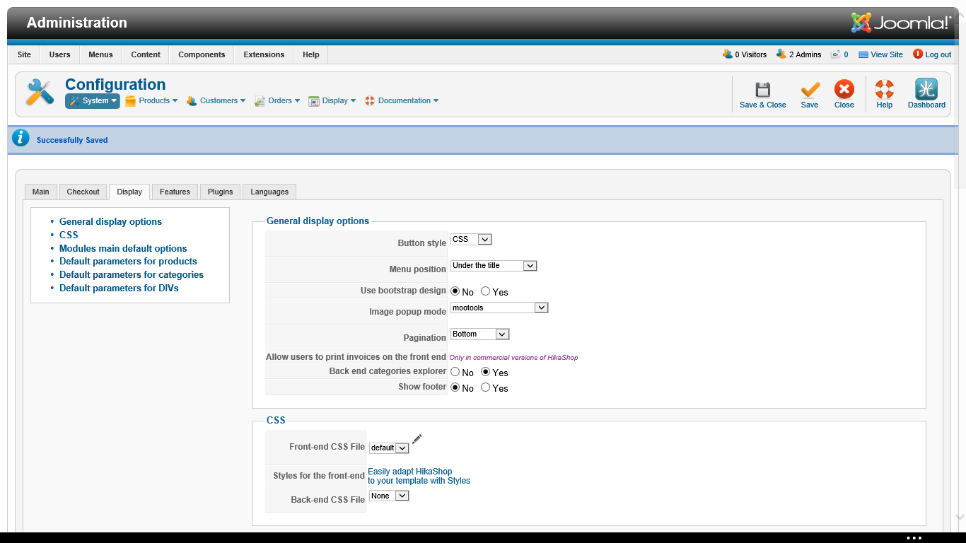

I'm new to the HikaShop forums. This is the first time I have ran into an issue with HikaShop. I was trying to change the style on my front end but accidentally changed my Back-end CSS File from None to Default. When I did, my back-end looked like this:
After I made this mistake, I changed it back to None so it should look like this:
Once I leave the configuration page and go back in again, it looks like the first image. How can I get it so it stays looking like the second image?

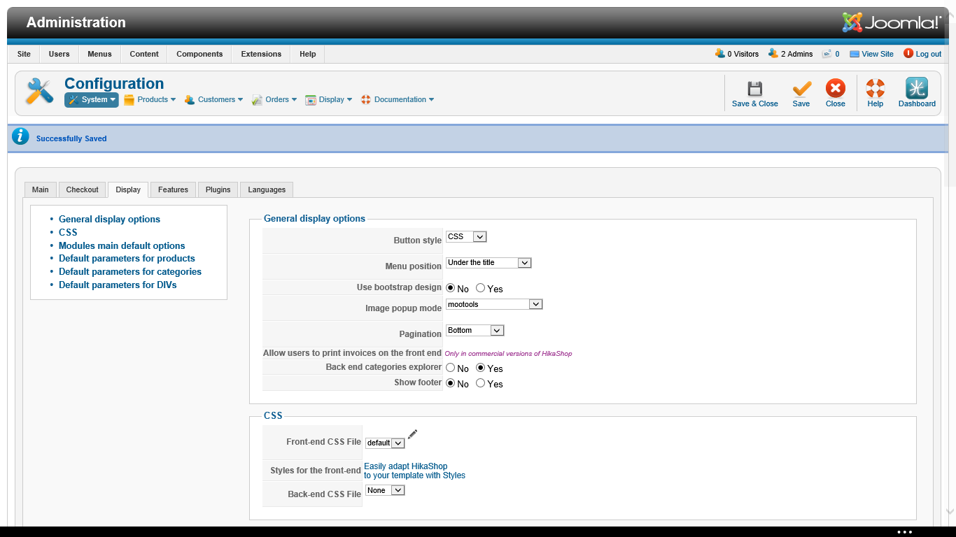

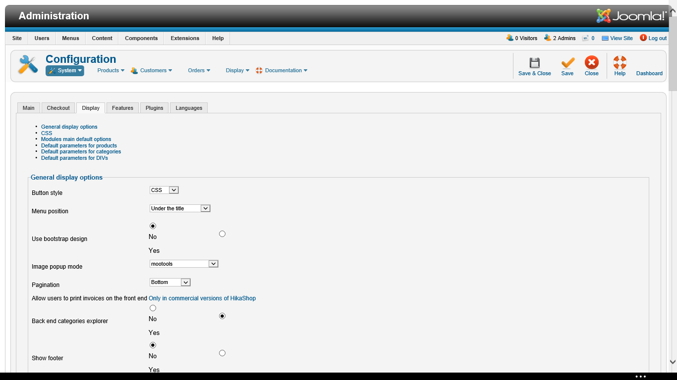

I would like my back-end to look like this:
Instead of this:

Normally, you should get that look with the "default" CSS backend file.
So it's the default one you should always use for the backend.
If you don't get the correct display with the default CSS, it would indicate that the file has been altered manually. In that case, you should download the HikaShop install package and copy the file media/css/backend_default.css form the package to your website media/css/backend_default.css file.
  • Posts: 50
12 years 5 months ago #149356
Thank you for the reply. I have it fixed now. Before, setting it as default didn't show the default back-end layout. Now it is working.
