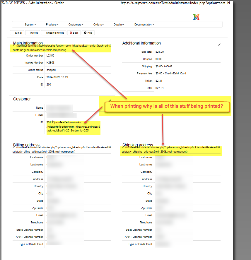

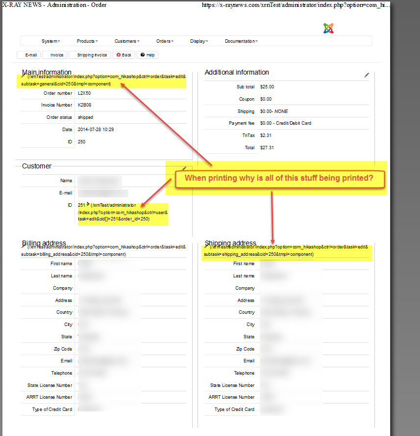

HS prints code that it should not. See the attached png file.
Any ideas??

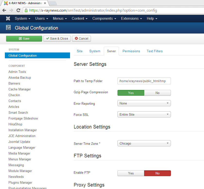

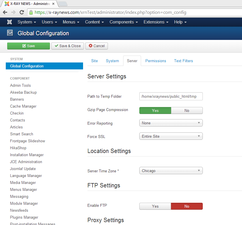

I don't really know from where are coming these lines.
Could you try to change the error reporting level of Joomla to minimum and see if it is still displayed ?

I have error reporting set at None. The code only displays when you Print or look at Print Preview. See attached png file.

Ok, I have reproduced the situation on my end.
We will check that, but why not click on "Invoice" button in the toolbar, and then on the print icon ?
This way you can print the invoice with all the informations directly with a nice display :)

11 years 11 months ago #166019
This issue come from the Joomla template, so thanks to edit the backend css file via HikaShop Configuration > Display > CSS and edit "Back-end CSS File" then add the following property at the end:
	a[href]:after {
		content: "" !important;
