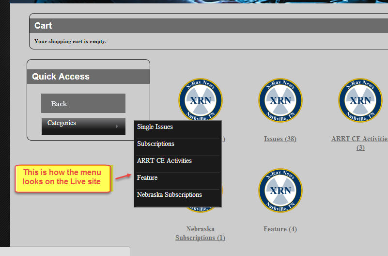

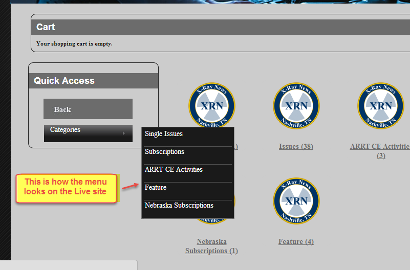

Live site at: https://x-raynews.com/products
Live site is Joomla! 2.5.24, HS 2.3.2

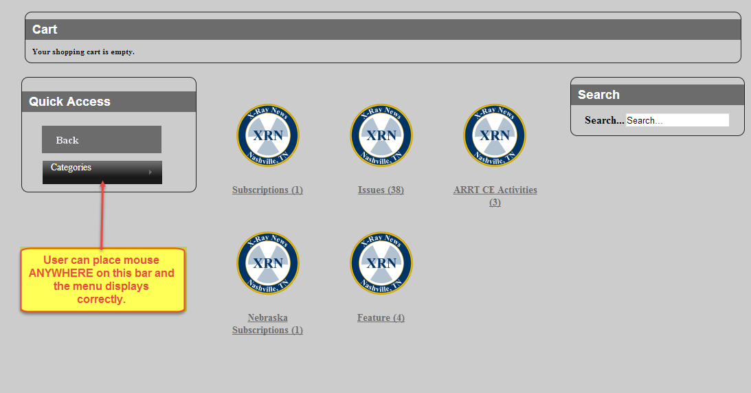

Categories menu display correctly
Test site at: https://x-raynews.com/xrnTest/products
Test site is Joomla! 3.3.3 HS 2.3.2

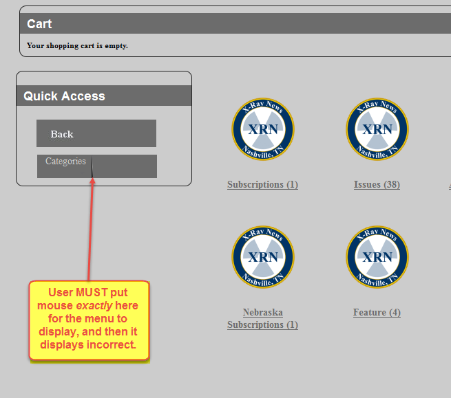

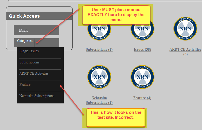

Categories menu display incorrectly

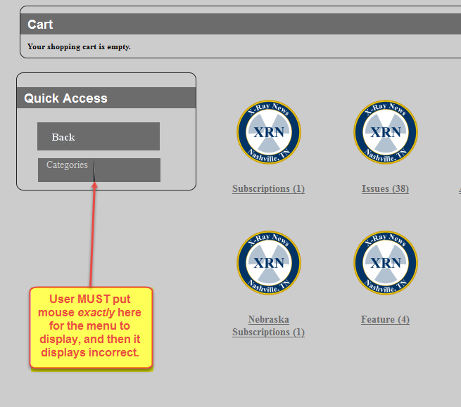

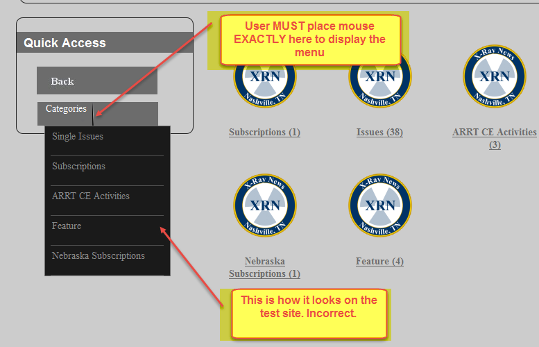

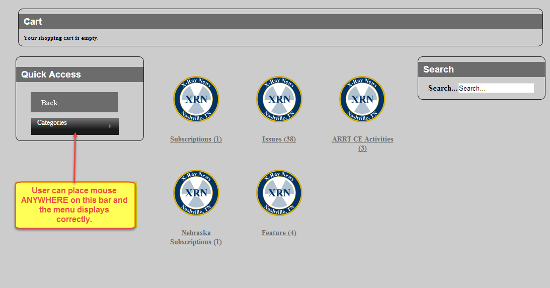

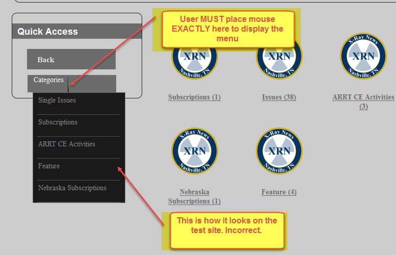

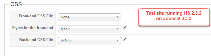

See the attached png files. Anyone have any ideas what is going on here??
Thanks for your time.

11 years 11 months ago #165845
You're problem is coming from some CSS issue, so using some CSS code will probably solve your issue : www.hikashop.com/support/documentation/1...ize-the-display.html

11 years 11 months ago #165953

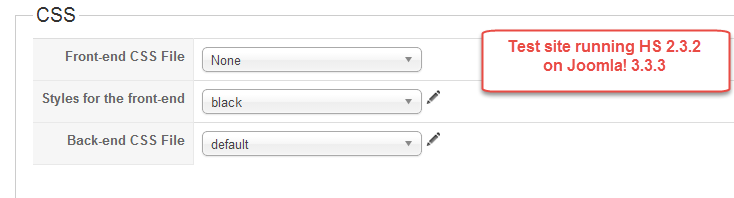

As explained in the given documentation, you have to edit the css file via HikaShop Configuration > Display > CSS.
The code can be added at the end of the file ;)

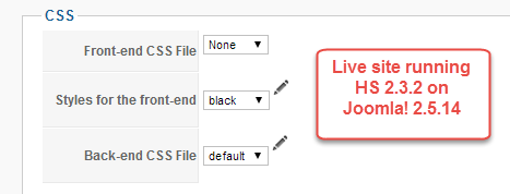

I'm not sure the issue is related to the CSS files. I think maybe HS does not play exactly nice with Joomla! 3.3.3. The rest of the cart is not displaying correctly either. All the HS files on the Test site are identical to the HS files on the Live site.
This is what I did to make/build the Test site. (The Live site was built before the Test site.)
1. Used Akeeba Backup to make a complete backup of the Live site, which is running HS 2.3.2 on Joomla! 2.5.14.
2. Restored the site using Akeeba Kickstart to the Test site, therefore, HS 2.3.2 is now running on Joomla! 3.3.3.
All HS 2.3.2 files on the Joomla! 3.3.3 Test site are are identical to the HS 2.3.2 that is running on Joomla! 2.5.14.

  • Posts: 30
11 years 11 months ago #166187
HiYa Xavier,
That fixed everything in the cart display EXCEPT the cart menu. It is STILL messed up. See attached pngs.
Ideas??
JamesKB
  • Posts: 85796
  • Thank you received: 14090
11 years 11 months ago #166228
The difference of display between the menu on the test website and the live website comes from CSS generated by the extension MaxiMenu CK which is actually the one which creates the menu altogether.
So I'm afraid we can't help on that. Please contact the support of MaxiMenu CK for help on the issue. They'll be able to answer better than us.
