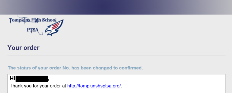

Hi Nicolas and team,
The email for "order confirmed" does not include the order number. It looks like it's supposed to though.
Hoping you can guide me on how to fix.
fyi - both the "order created" email and the "order shipped" email contain the order number.

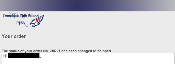

Thanks in advance!

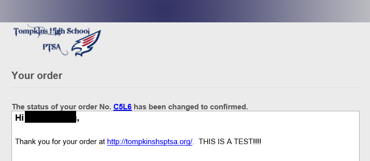

When I change the status to anything in the backend, the order number is included.
We are using the PayPal plugin. It works fine - but the email that is triggered once the order is paid, is the one I included here - WITHOUT the order number.
I guess I'm confused though - because when paypal triggers the email (changing the status from created to confirmed), the email that is sent, not only does not include the order number, it also has a different font as the h2. Is it possible it's pulling from a different email template?
