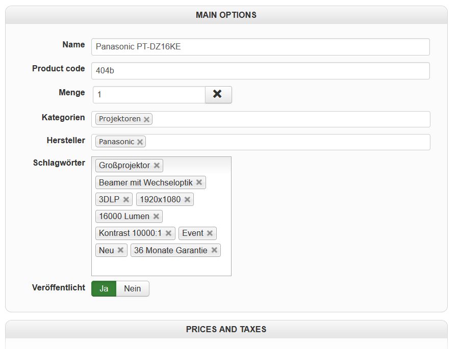

  • Posts: 12
9 years 10 months ago #251904
Thanks for your help.
In the screenshot you can see the settings für the tags in the backend at the product.
And the linking tags with no results you can find here:
gebrauchte.beamerstation.de/Produkt/Panasonic-PT-DZ16KE.html
if you click of one of the tags you get the message: there are no results for that.
