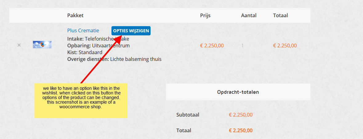

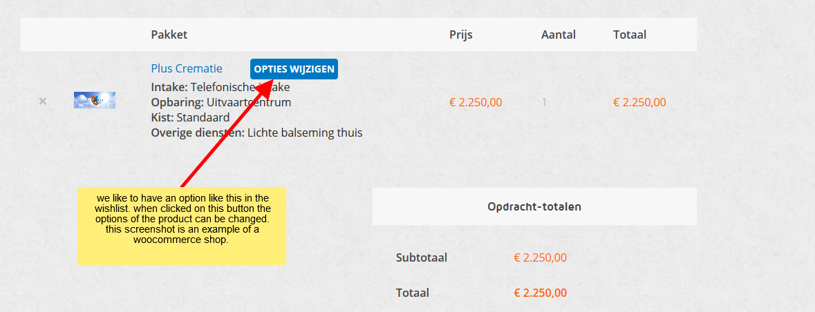

to bad that there's no option to that.. i found on a wp woocommerce website the following see attachment. They have the option in the cart to change the options of the product in the cart. This is what we like to have but then for the wishlist. is this only possible with a custom plugin you suggested?
We probably also like to have such an option in the cart itself.

  • Posts: 86081
  • Thank you received: 14192
9 years 10 months ago #253574
Yes. A custom plugin and/or a view override. But in any case, it will require the help of a developer to implement that.

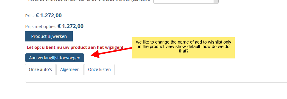

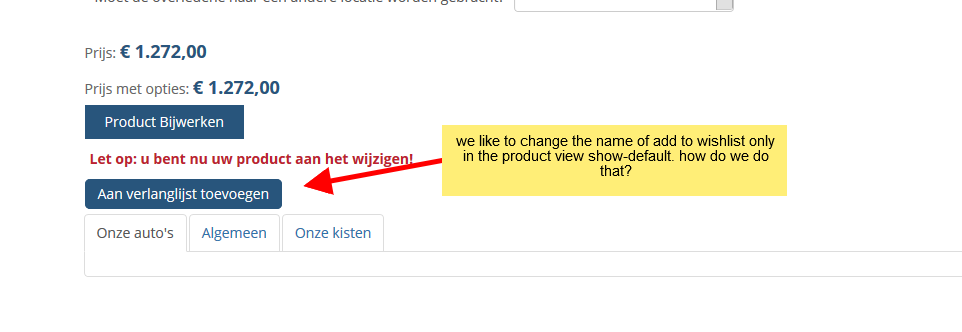

Thanks it helped a lot.. we now managed the button. it is working.. but to make the whole more complete i would like to change the name: Add to cart only in the product view. the show_default.php how can i manage that? because when i change it in the quantity.php it all will be changed. only the name? not the function of the add to wishlist button.
Thanks.

9 years 9 months ago #255281
Then you indeed need to edit the file quantity.
What you can do is something like that:
if(!empty($this->element->product_id)){
$button_name = 'name on product page';
}else{
$button_name = 'name elsewhere';
and then use $button_name where you have the call to the displayButton function.

9 years 9 months ago #255386
Please reread my message. You have to do that in the file "quantity". There is nothing to change in show_default...
And if you search for "displayButton" in the quantity view file, you'll find several ocurrences of that so you can just add the if/else before each one.
