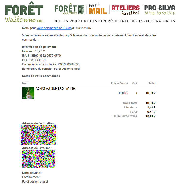

I need help to solve a problem I had with mails in hikashop.
In ALL the notification mails the € symbol is replaced by a question mark.
As I set a custom layout for the mails I firstly thought that the problem was in my template. I reset the original one and the problem is already present.
I've also checked the Hikashop params and the setting is on UTF-8 (and base 64). The others special chars in my mails are correctly displayed (é, è, à, etc.).

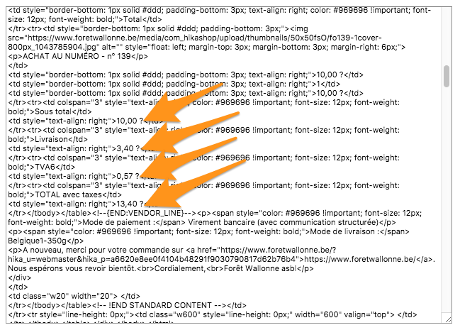

So i created a plugin to test the mail with the event "onBeforeMailSend" and the problem is present before the sent.
Here is the code :
public function onBeforeMailSend(&$mail,&$mailer){
		echo "<textarea>";
		print_r ($mail);
		echo "</textarea>";
		die();
And the result is :
Thanks for your help.

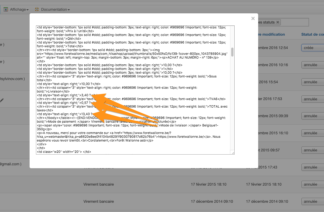

Also, there is no need to do a die like that. You can go in the menu Customers>Emails history of HikaShop and you'll get the data stored for each email sent by HikaShop. How does it look there ?
  • Posts: 14
9 years 9 months ago #254812
Thanks for your answer.
In the email history it looks good. The mail I receive contains the problem but not in the mail history.
I don't understand, I tried with an external SMTP and a simple PHP function and the problem stay.
