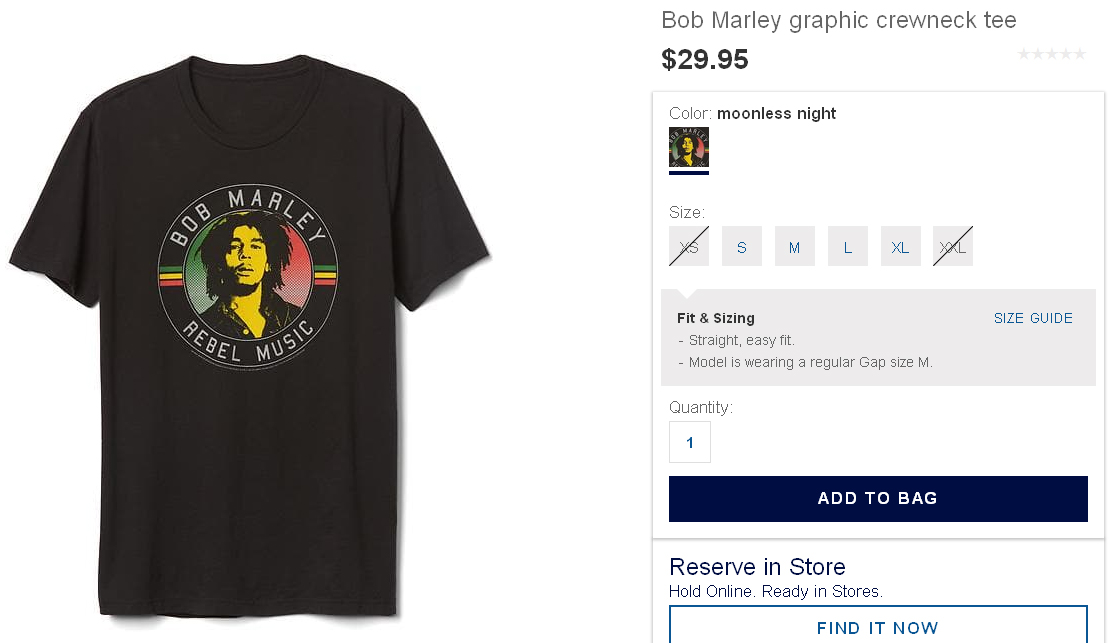

I have someone who is interested in possible using Hikashop. One of the question they are asking is can the sizes still be displayed even when the item is sold out, similar to the attached.

Any idea how I can make the out of stock sizes appear similar to the example that I attached above? The user will need to see the sizes but not able to click on it.

The options available only allow you to remove the out of stock variants or keep them.
If you want to keep them but not make them selectable then, you would have to edit the code of the file administrator/components/com_hikashop/types/characteristic.php
