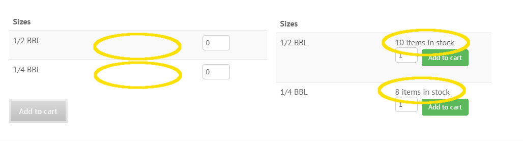

Thanks for the reply. You can actually see what's happening with the add to cart button in one of my earlier screenshots related to the stock level display (attached).
Matt

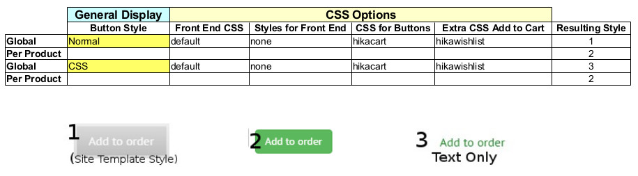

Perhaps the attached graphic will explain better than I can.
Matt

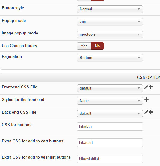

you're not wrong, there are indeed some different classes going on because of new improvements in Hikashop 3, so I guess you could say we're in a transitional phase from Hikashop 2 to 3, that's why they still have the legacy settings. Hopefully someone of the Hikashop team would gladly discuss that with you, but instead of writing these long posts it's really a matter of a few minutes to fix it.
Why not simply add the old button class in your display configuration under "Extra CSS for add to cart buttons" and everything should look fine, easy fix. Or just open your template CSS file and add the new button class in a few places, a few minutes work at most. Just trying to help with a quick solution.

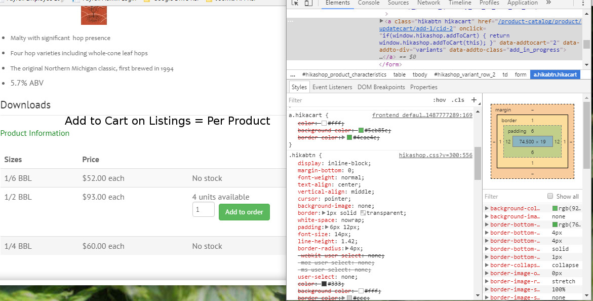

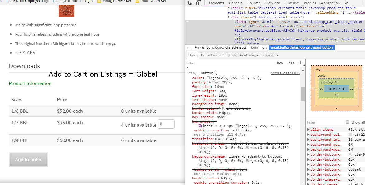

Thank you both for your consideration and input on this matter. I fear we have all spent too much time on what can admittedly be patched up with a workaround or two quickly and effectively. I am still puzzled as to why the Add To Cart button is rendered as a different element type based on configuration.
When the button type is set to "Default" and add to cart is configured as "Global" the button is rendered as an <Input> element:
<input type="submit" class=" button hikashop_cart_input_button" name="add" ...
When the button type is set to "Default" and add to cart is configured as "Per Product", the button is rendered as an <a> element:
<a class="hikabtn hikacart" href="/product-catalog/product/updatecart/add-1/cid-7" onclick= ...
My site-wide CSS defines style for the .button class, so in the absence of any overriding style the Add to Cart button accordingly. Once the configuration is changed to "Per Product", Hikashop renders as an <a> element, so the the button class styling no longer applies. That is why the button displays differently, correct?

yes, it displays differently because in your template only the .button class is defined, which is present in the "old" input elements but by default not in the new Add to Cart <a> buttons.
As you can see, by default Hikashop 3 now uses the class .hikabtn for the buttons, which isn't defined in your template hence it's not styled by your template, but the great thing is HS 3 allows you to set the class for the buttons yourself as defined in the Display Configuration with CSS for buttons.
So like I indicated in my previous answer, you can:
1. Change this default hikabtn class to button in your configuration and your buttons should look exactly the same with any of your settings whether you have an <input> or <a> element
2. Or add the class .hikabtn in your template CSS file to where the class .button is also defined
