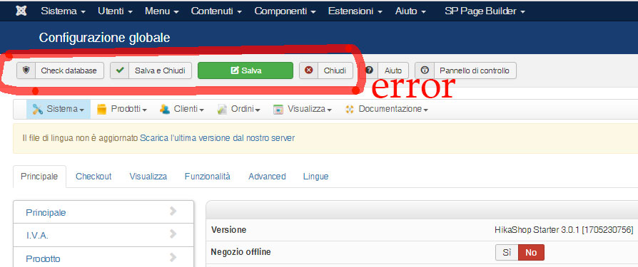

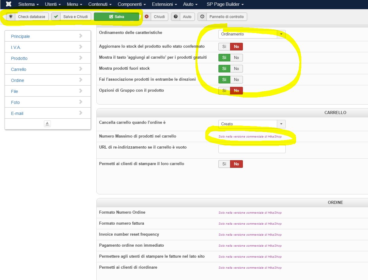

Sorry for stupid question:
But with the HikaShop Starter I can not even change and save the global configuration?

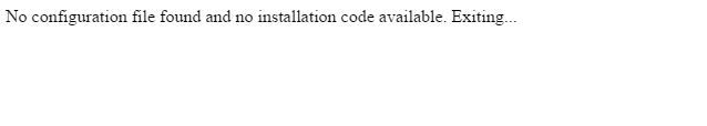

When I try to save an error message:
No configuration file found and no installation code available. Exiting ...

That error doesn't come from HikaShop.
Searching on Google about that error message, it appears that this error is displayed by Joomla when it can't find the configuration.php file at the root of the website with all the settings of the Joomla website:
forum.joomla.org/viewtopic.php?t=265091

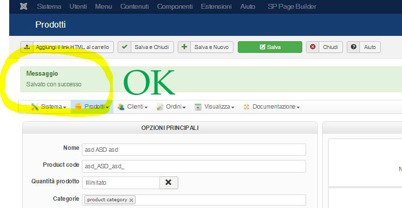

Saving a product works properly
Saving the configuration does not work properly

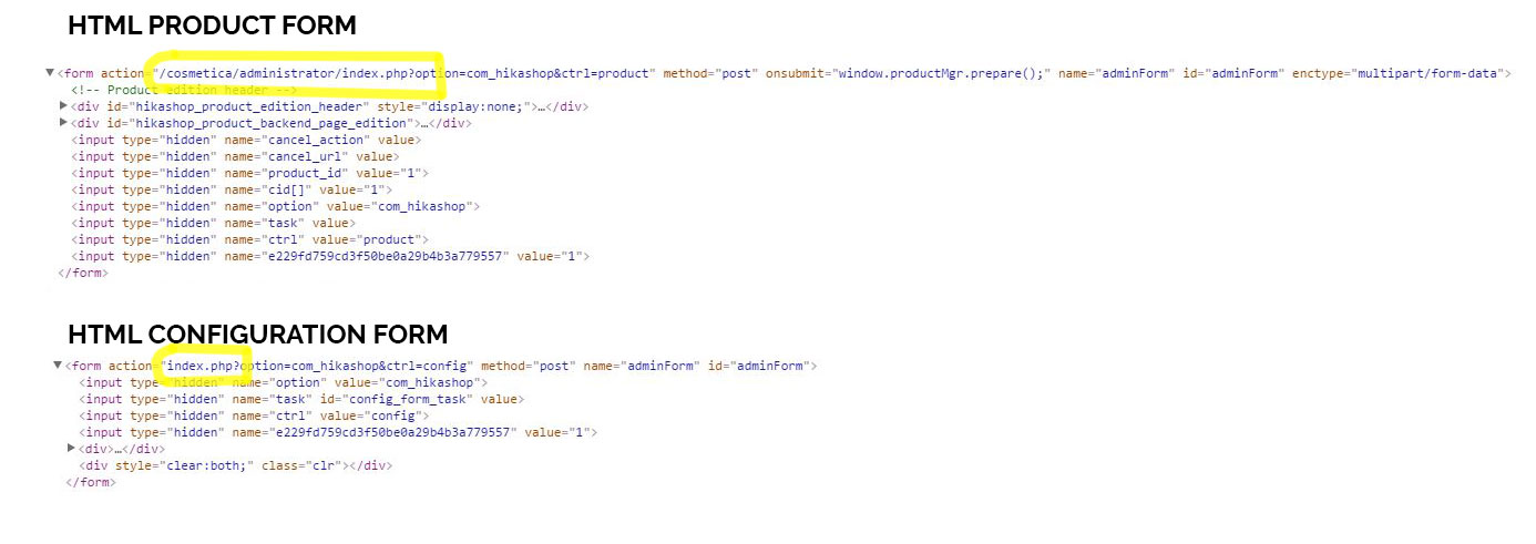

Looking for the problem
I saw that action form of the product's and action form of configuration have different url
This can mean something?
Last edit: 9 years 3 months ago by testdrive.
  • Posts: 86081
  • Thank you received: 14192
9 years 3 months ago #270398
I don't think so but it worth trying.
Edit the file administrator/components/com_hikashop/views/config/tmpl/config.php and change the code:
index.php?option=<?php echo HIKASHOP_COMPONENT ?>&ctrl=config
to:
<?php echo hikashop_completeLink('config'); ?>
That should give a similar URL for the form.
