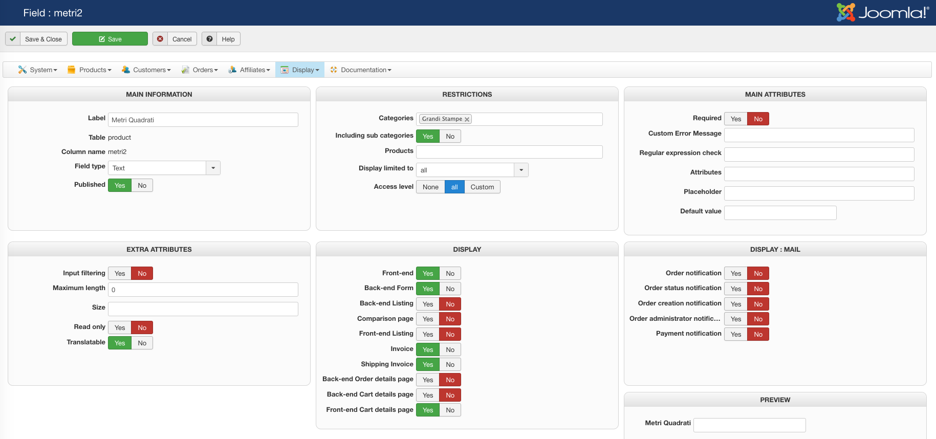

  • Posts: 42
8 years 11 months ago #278191
Here is the screenshot.
Thanks!
  • Posts: 86081
  • Thank you received: 14192
8 years 11 months ago #278205
The column name of your custom field is "metri2" and not "product_metri2".
Thus, your code should be:
$productClass = hikashop_get('class.product');
$productData = $productClass->get($product->product_id);
echo '<br/>m2: '.$productData->metri2;
