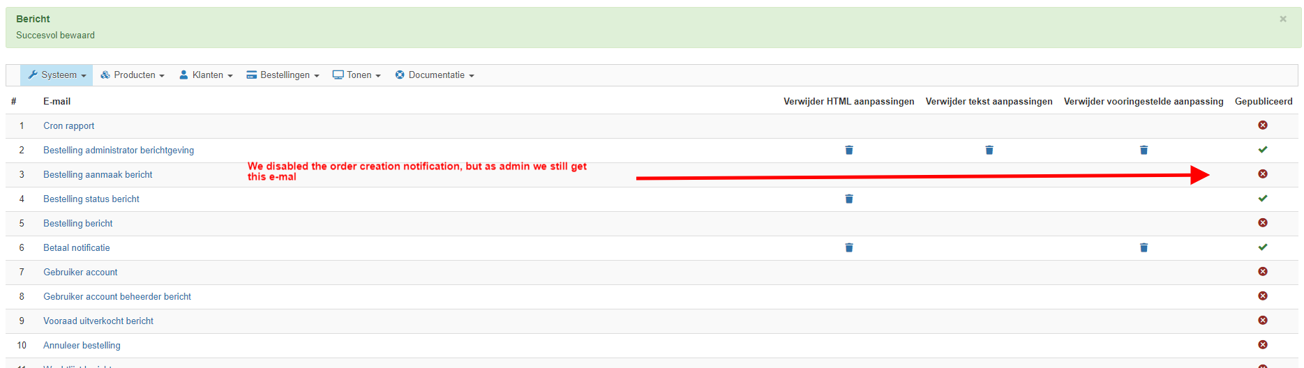

4 years 9 months ago #338209 by BluepointWebdesign
Thanks for your answer, i think what we forgot to mention is that we don't want the admin get the order created notification, only the confirmed e-mails, this because when someone goes to ideal and does not do the payment he gets a created email.. but this isn't paid.. so that is confusing for our client..(admin)
How can we accomplish that??
Hope you can help..
Mark
More
4 years 9 months ago #338210 by nicolas
For the admin, you want to disable the "order administrator notification" email there.
The admin will still get the "payment notification" email when the order is confirmed by the payment gateway, after the payment.
More

4 years 9 months ago - 4 years 9 months ago #338222 by Philip
Did you try to remove the administrator email address, in your Main HikaShop Configuration => Emails part :
Hope this can allow you to achieved your needs.

4 years 9 months ago #338240 by BluepointWebdesign
Hi Philip,
I tried this. But then no email will be sent.. not even the cash on delivery ..
So it does not achieve what we need..
As i explained we have to checkout options.
1. cash on delivery, -> this one goes well and sent only the confirm email.
2. iDeal-> here we get three emails when payment is successfull 1 created and 1 confirmed, and also the notifcation of the transaction is succesfull.
When nothing is done through iDeal so no payment what so ever the created email is sent. But we don't want that to happen, this is confusing for the admin..
Mark

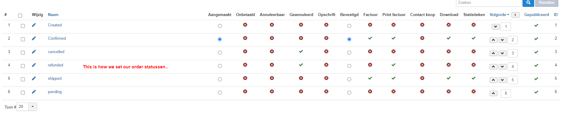

4 years 9 months ago #338350 by BluepointWebdesign
I did some testing with your code.. but then we only get the payment notification email and not the admin notification email confirmed,
What we now get is for one order 3 emails:
1. one created (this one we do not want to be sent.
2. one confirmed
3. The payment notification
The first two are generated in the order administrator notification email..

4 years 8 months ago #338557 by BluepointWebdesign
hi,
I used that peace of code in the pre load of the administrator notifaction email..
But this didn't help then i only get the created emails when a payment is done by iDeal.
More
