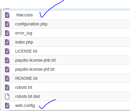

i check this config on my host but i have 3 more site on this server and work as fine
and if u see my site all other link ( non hikashop work as fine )

Also, I can see that the links works again on your website. And SEF is still enabled. Only the index.php is in the URL. And if the URLs don't work without the index.php, in most cases it means that the htaccess.txt file has not been renamed to .htaccess or the configuration of the web server has not been done properly.

nicolas wrote: And SEF is still enabled. Only the index.php is in the URL. And if the URLs don't work without the index.php, in most cases it means that the htaccess.txt file has not been renamed to .htaccess or the configuration of the web server has not been done properly.
i change htaccess name
and server this is not my main server ( we all rent some host from other company ) we access to C-Panel and some config ( we cant change server config ) in this host 3 more website work ( avisapro.ir / behpookaran.ir and ... ) other website work without index.php and sef fine ( so this problem just for medequip.ir not from server ) i wanna know this problem come from hikashop ? or gantry 5 framework ? or my template !!! this is broken my mind because ( i receive error 404 without any error massage ) so i cant understand this 404 coming from where bro

yes with this i found problem
you right all this problems coming from htaccess
this is not for name or ...
i say what happen maybe some one else have this problem :
i install some component ( name is JCH Optimizer ) this component always work fine but not after update it from version 8 to 9 this component remove all htaccess code... ( all of them ) and add some new code from JCH to htaccess, so htaccess have not default code and i receive this problem
