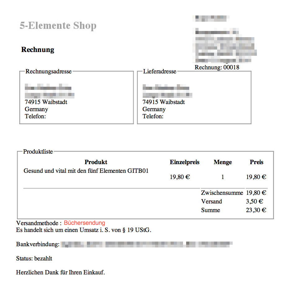

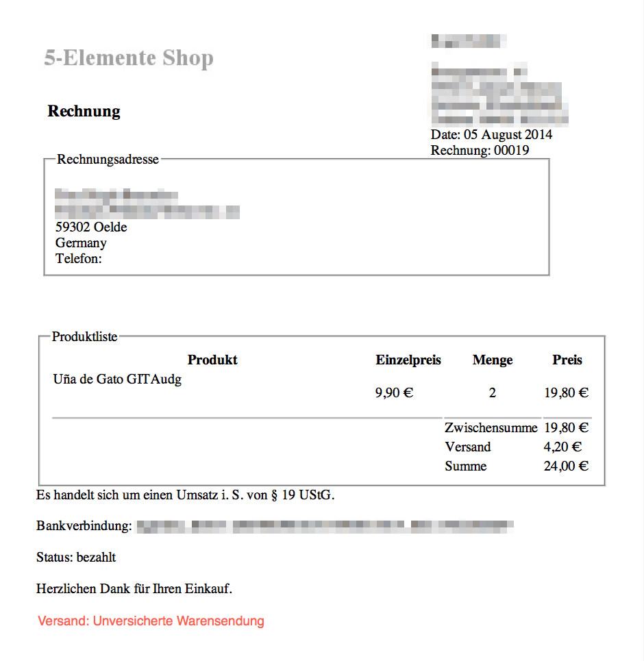

I attached two of my invoices. That will probably explain the problem better. I'm printing the invoices from the front end via a vendor account. I use two vendors. If I receive an order that contains products of the two vendors, the invoice looks different from an order that contains products only from one vendor.
Invoice number 00018 comes from an order that contained products from two vendors. It shows shipping address and shipping method (Versandmethode), but not the carrier. I put it in manually in red (Büchersendung) which is not a good solution, because I have to edit every single invoice.
The other invoice 00019 contains only products of one vendor. It doesn't show the shipping address and no shipping method. Again I had to put the shipping method manually in red (Versand: Unversicherte Warensendung)
I don't understand why the invoice output is different depending on the fact that more than one vendor is involved and why the carrier is not shown.
The shipping methods are set up for this vendor only. The other vendor is selling downloadable products and has an extra shipping method with 0 costs.
Roger

In the front-end, the display of the invoice looks good ; I could display the order "47893" and see the
Versandmethode : Download/E-Mail, Büchersendung
Which looks good for me.
So I guess that your problem is not linked to HikaMarket but to HikaShop.
Well, I fixed the view "hikashop - backend | isis | order | invoice" in your website.
With the next HikaShop release, you could remove this view override (because the code is in already in the development version of HikaShop).

  • Posts: 26376
11 years 11 months ago #168385
If you look at the orders in the backend.
The main order "47893" have the two shipping methods, now displayed fine in the shipping invoice backend too.
The sub order for the vendor "Roger ..." have a single shipping method attached, I can see it in the backend but I don't have any account to see it in the front-end.
The sub order for the vendor "Get in ..." does not have a shipping method attached, I think it's because there is not shipping price and it looks like a problem in the sub order generation.
If the shipping is not right set in the sub order, it won't be possible to display it in the order or in the invoice.
I will investigate in that point on my local website.

  • Posts: 26376
11 years 11 months ago #169011
Hi Roger,
Sorry, Nicolas was in business travel these last days so I help the HikaShop support team and I make the support during the last days (and I was alone for the support during the week end).
Like I told you in my previous message, the problem is link to the shipping price.
In the HikaMarket order class, in the function "processShippingParams", the algorithm checks the shipping price in order to know if a shipping methods has been found or not.
And we know now that, it is not the right solution because you can have a free shipping for a vendor ; and he want to know it !
So I have modified the function in order to use a variable "$shipping_found" instead of checking the shipping price ; but I didn't have the time yet to test it in my local website.
