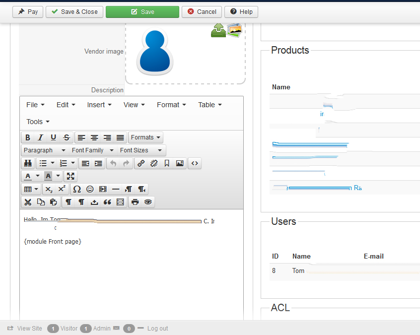

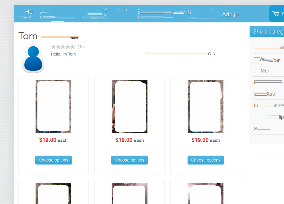

this is the way I did that and it may help you.
- Create vendormarket menu item for the vendor.
- Create a category that shows all products.
- Make a module for that category, make sure "Synchronize with currently displayed item when possible" is set to yes.
- Create a menu item for your vendor.
- Install "Modules anywhere"
- With modules anywhere add that module to the bottom of the vendors description
Look at the image to see what it looks like
