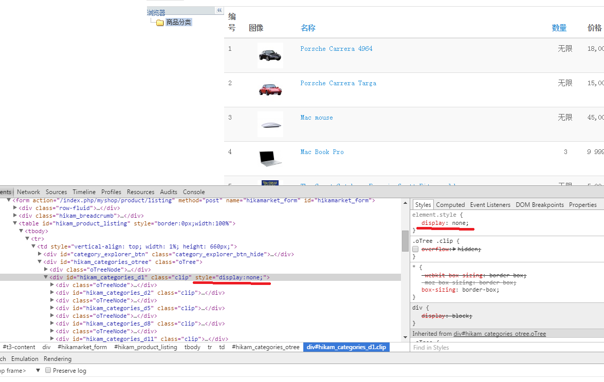

It's strange, the categories do not display in category explorer in front-end. It works well 2days ago.
I found that it has been setted as display none in Css. Why? I didn't set anything about this. How could I fix it?

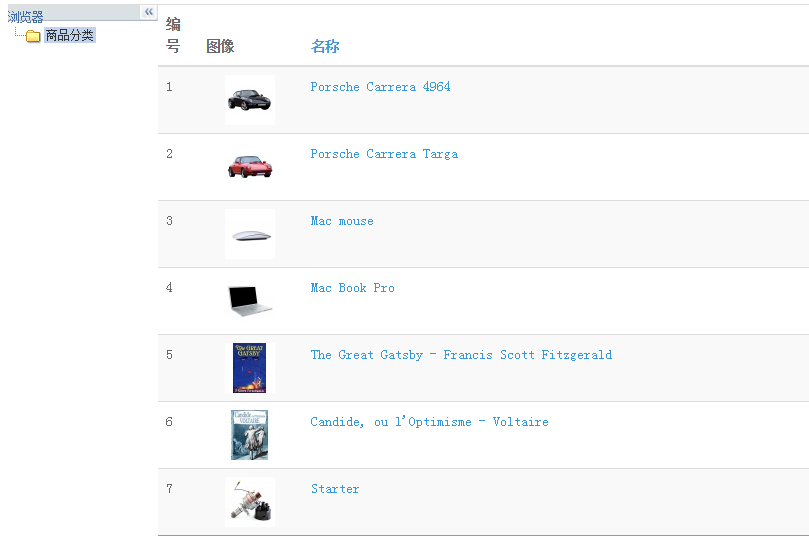

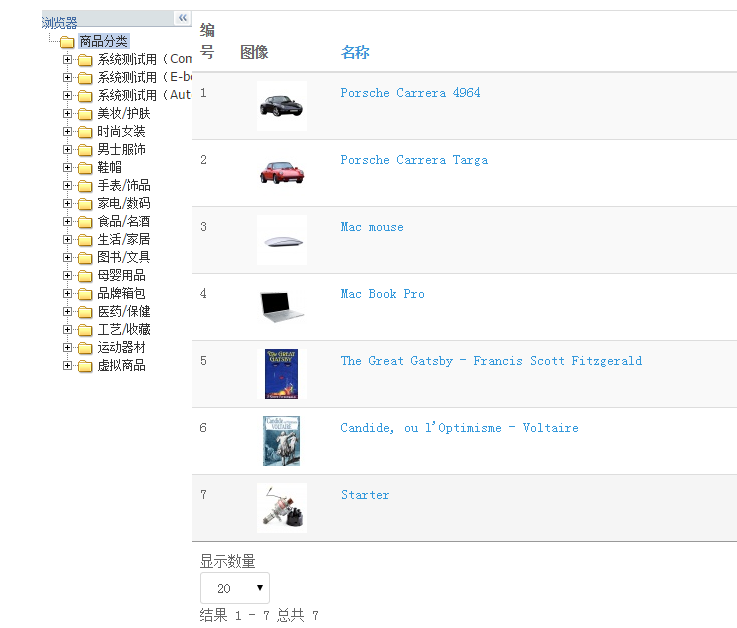

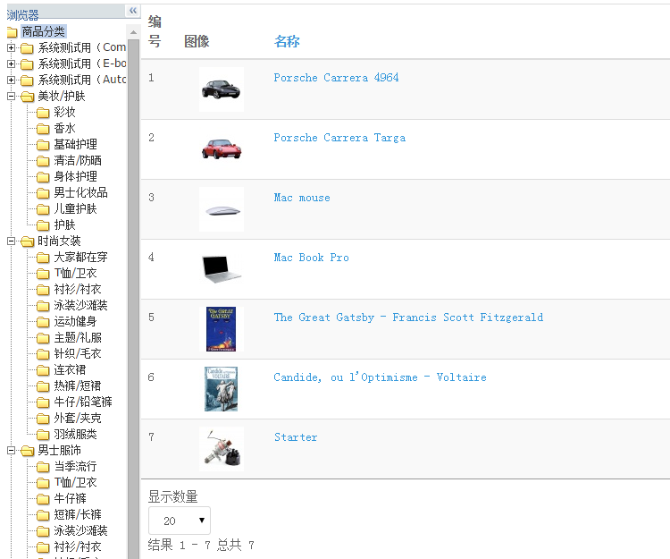

I mean that the "product"page in front-end was look like as this 2days before
But, now, the categories do not display in category explorer.

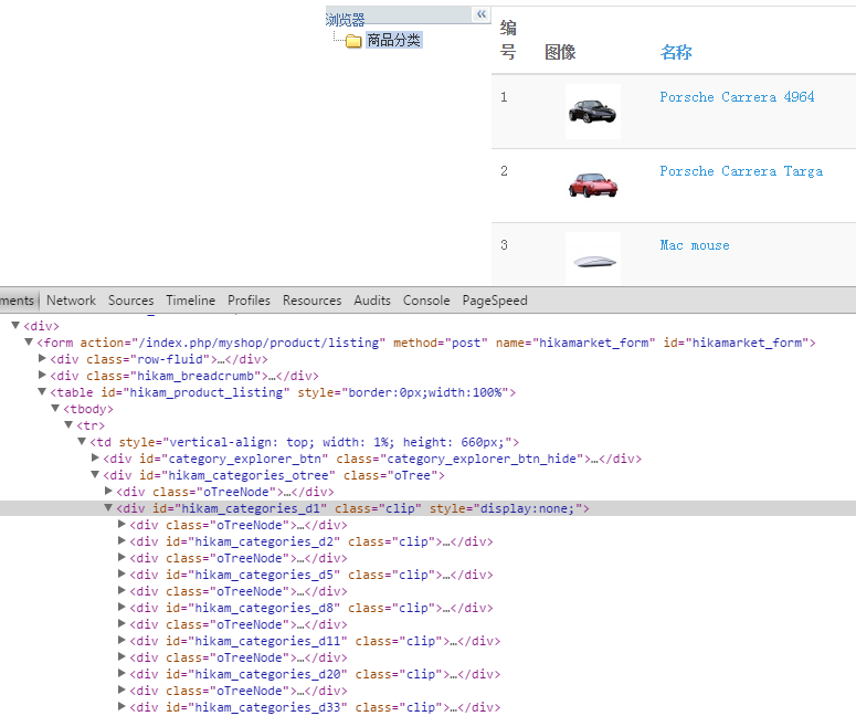

I found that there appeard a" display: none" line in the code. I'm sure there was not before.
I added these code in the custom css file and It works well as before
#hikam_categories_d1.clip{
display:block!important;}
however, I still want to know where are the " display: none" line from. I did nothing change in settings during these days

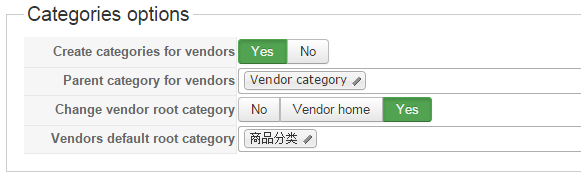

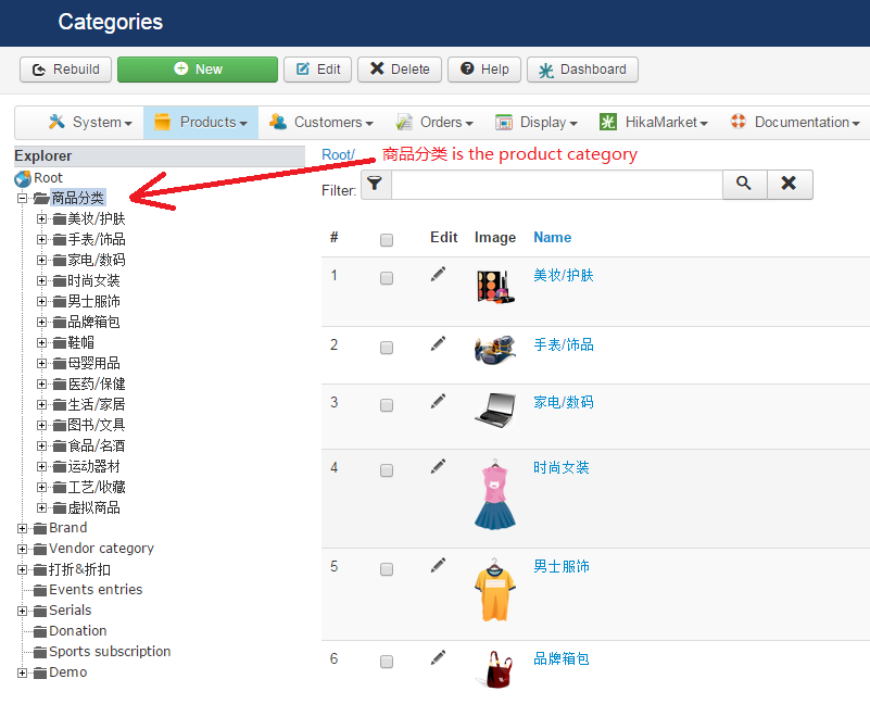

Regarding your screenshots, it's "no" and not "yes".
What is the category you have selected for the "vendor default root category" ?
What is your category structure ?
I do not need to know the ACL ; I need to know the structure of your categories and understand what is the category with a name that I can't read, type or understand.

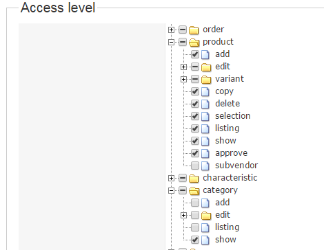

  • Posts: 49
10 years 4 months ago #203226
the vendor default root category is the product category
The category explorer in the front-end
