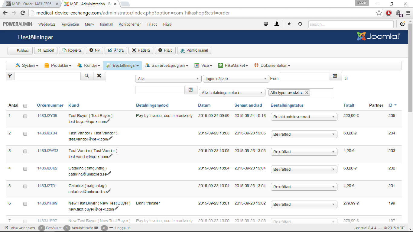

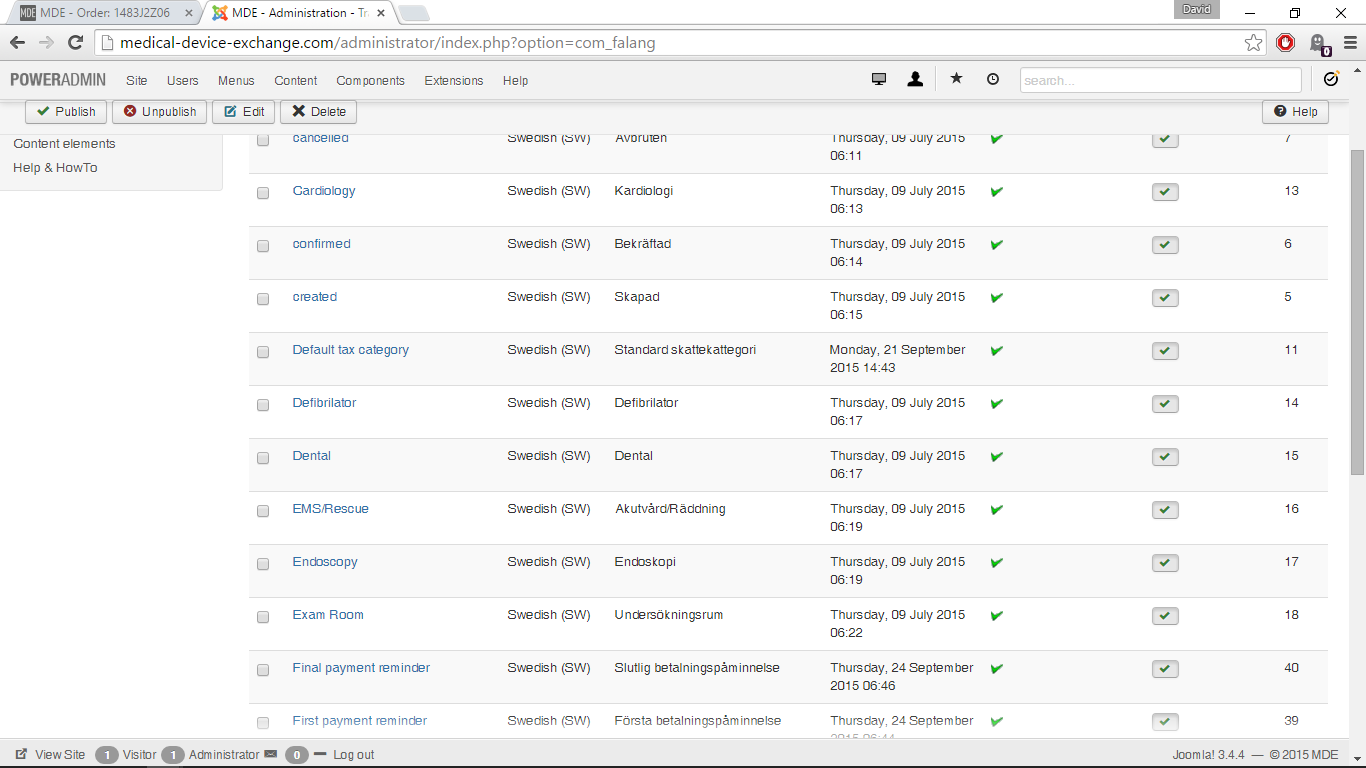

All order statuses translated with FaLang. Img 1.

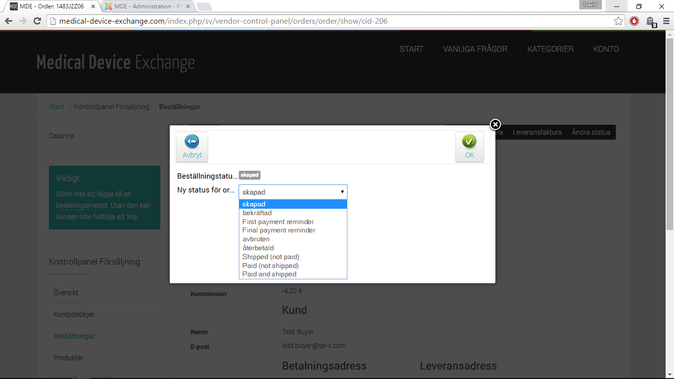

1. Vendor front-end changing order status mixes languages. Img 2. Looks to be a mix of system language for default order statuses and FaLang non-translated language for non-default order statuses.

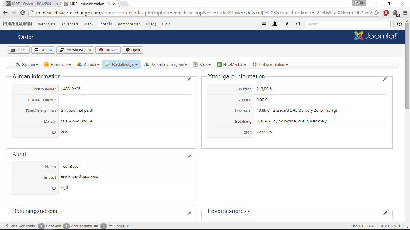

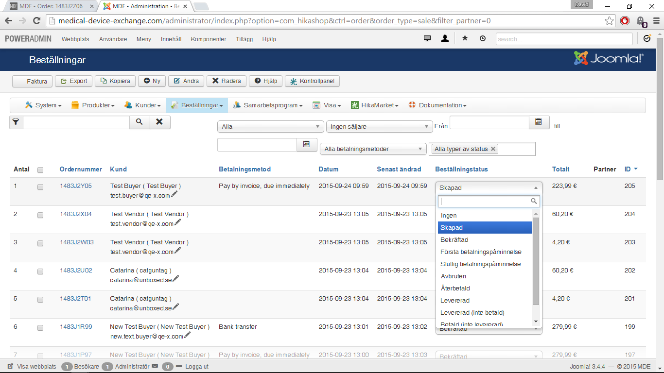

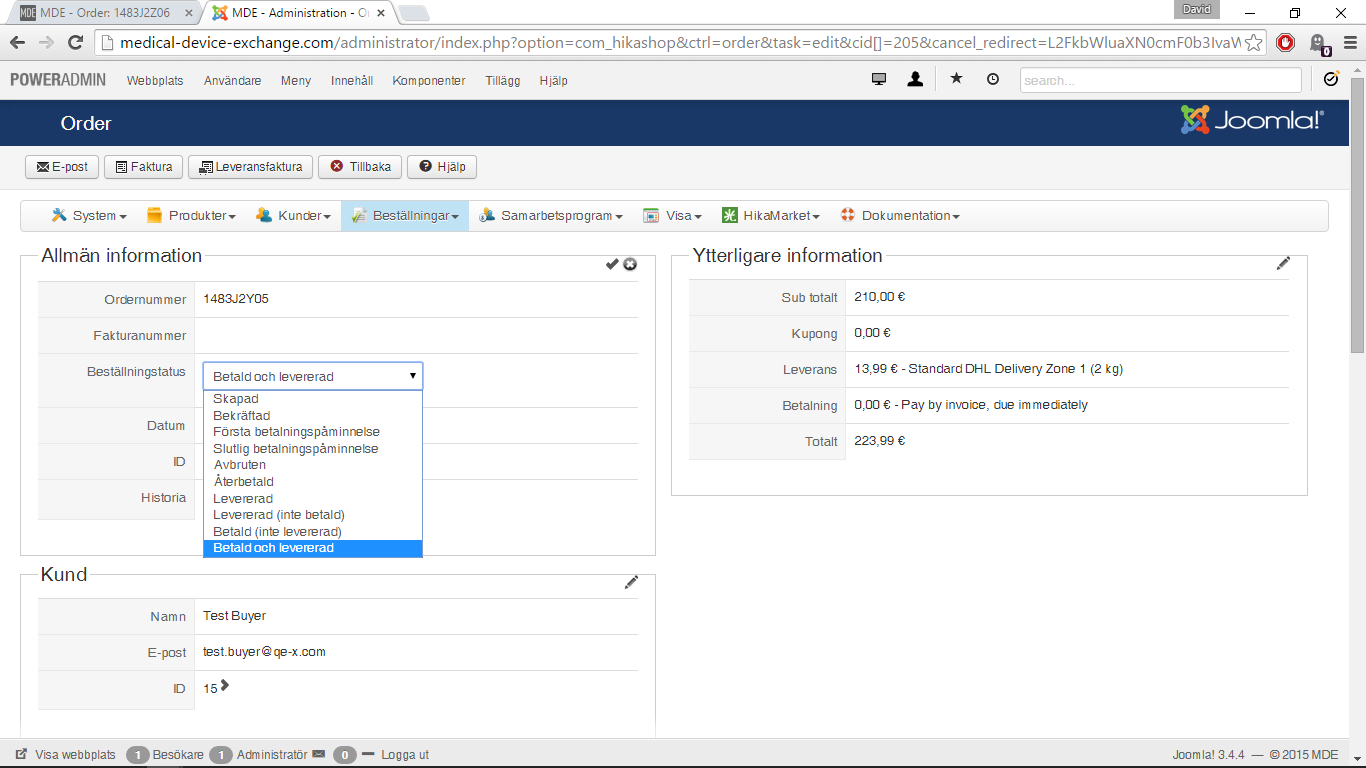

2. Admiinstrator back-end order list view displays correct order statuses in drop-down (img 3) and saves in correct language when selected (img 4). However, if the order status was non-default, the non-translated order status is specified in order view (img 5).
3. Administrator back-end order view displays correct order statuses in drop-down (img 6), but reverts to non-translated value when the order is saved if a non-default order status is selected (img 7).
