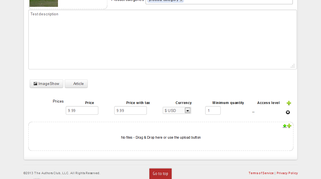

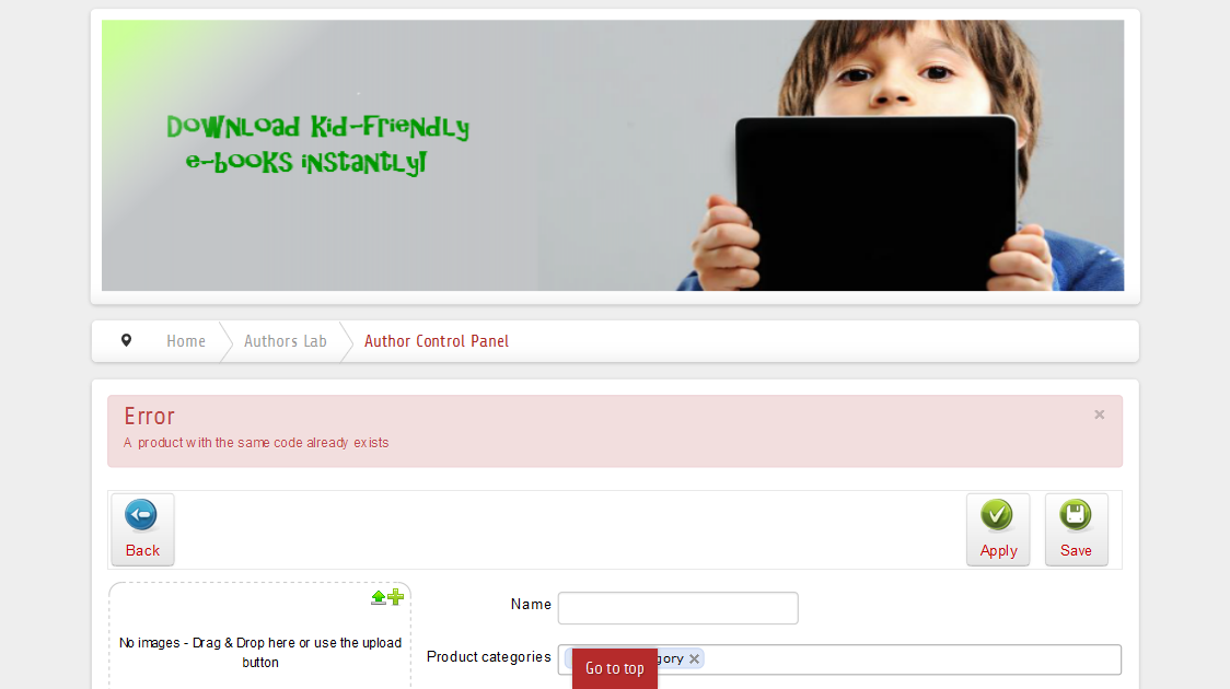

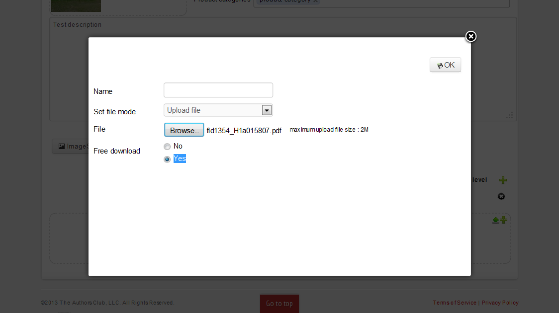

I add a new product from the front-end as a vendor (because I want to test a vendor account). Allowed file types are PDF, MOBI, and EPUB.
I've attached 3 screenshots: uploading the file, after I upload the file - no file is there, and the error message
The file won't even upload from the front-end and it still gives me that error message.

12 years 10 months ago #127815
The problem is not related to the file upload.
There was a problem with the update of the file zone just after the "manual" upload. This problem will be fixed in the next release (that I hope publish soon, changelog is mostly written).
About the product code, it looks like you didn't have it in your screenshots and you have an empty product name too.
I don't know what options you activated in HikaMarket but the product code is generally determined using the product name if you don't specify it (the product code).
HikaMarket have some features to avoid the product code duplication, trying to always generate a unique product code.
But if you don't specify any product name, it could be a little bit complicated for HikaMarket to have a working base for his product code generation.

When you save your product, the file is already uploaded so there is no link at all between the two parts.
The problem is when you save your product because your product name is empty and I still don't know anything of your configuration so I can't tell you more but it is not a good thing that the product name if empty.
