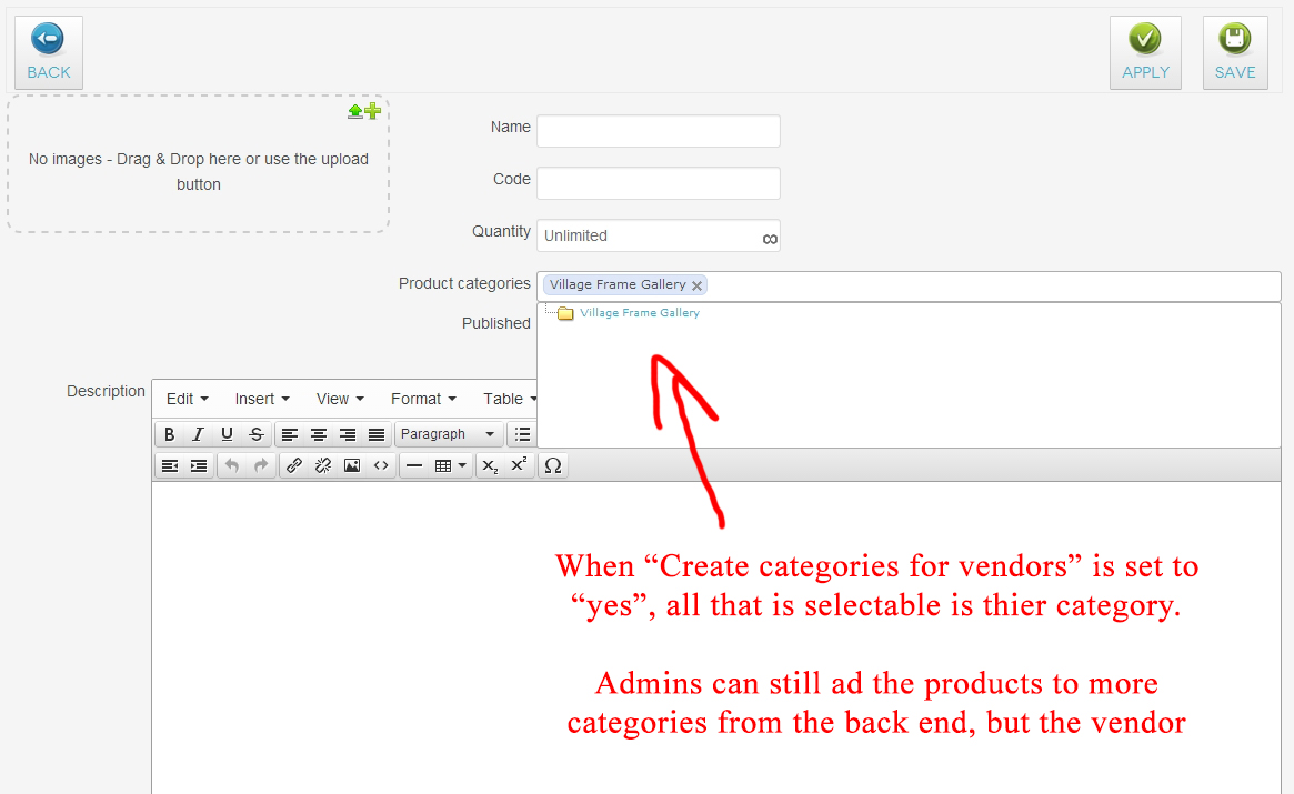

For some reason in the Hikamarket | Market Options tab under category options, if you toggle YES for "Create categories for vendors", it will create a category for the vendor, however, the vendor loses the ability to select the product categories I created while they are creating a new product. I'm not sure if that is intentional or if it is a bug. Either way, as a result, all the products for a few of my vendor accounts are not correctly categorized because they didn't know any better.
Is there a way i can assign a group of products to a product category quickly, or do i have to go in to each individual product and assign their categories? ALSO, while the new sign ups have the ability to select product categories for their products (but they are not in a vendor category), the ones that did have a vendor category STILL have no access to the product categories. How do i get them the ability to select a product category for their products?

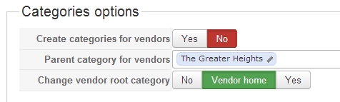

Please provide a screenshot of your HikaMarket configuration for the "Market / category" section.
It will help us to have a better idea of your configuration and tell you if it is a bug or not.

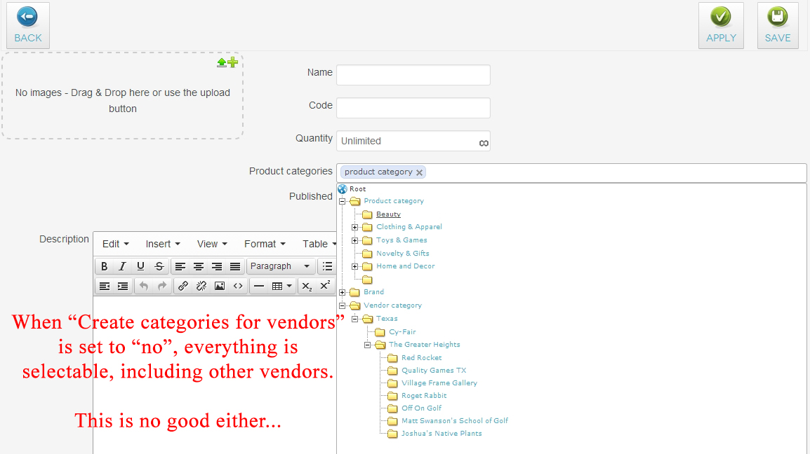

See Attached.
Right now I Have Create categories for vendors” set to “no”, So any new vendors created have the ability to select the right product categories for their products.
However, any vendor that was created when it was set to yes can still only select their vendor category.
Would love a solution to this.

You have the option "change vendor root category" configured to "vendor home".
www.hikashop.com/support/documentation/1...nfig_market_category
Change vendor root category
You can change the root category for vendors. It means that vendors could only see products and categories which are in their "root category".
You can deactivate it (and vendors would be able to see all products and categories of your store).
You can set the "vendor home" and it would use automatically the "vendor category" previously created.
You can set "yes" and at this moment, you would be able to set the default root category. The "root category" could be override per vendor.
Because HikaMarket create a vendor category, it is logical that your vendors are limited to that category, because the option said so.
Please use another value for the "vendor root category" in order to have more possibilities during the category selection.
You can also read the vendor tutorial which explain how the categories works.
www.hikashop.com/support/documentation/1...html#tuto_first_conf

This explanation helped a lot, but no matter how I configure this, I'm unable to achieve what we need. perhaps it is within the scope of the software's capabilities and perhaps no. Here is what we need:
  1. Vendor Category is automatically created
  2. All vendor's products are automatically listed in Vendor Category
  3. When adding products, vendor has ability to list their product in a product category that we created... so, in other words, they have access to product categories as well
Our niche is going to be setting up hyper-local stores. So, we need to be able to categorize vendors based on their geographical location. Our Vendor Categories can conceptually end up looking something like this:
--- United States (country)
--- --- Texas (state)
--- --- --- East Texas (Region)
--- --- --- --- Greater Houston (County / City)
--- --- --- --- --- Cy-Fair (Blok)
--- --- --- --- --- Greater Heights (Blok)
--- --- --- --- --- --- --- Store 1 (vendor)
--- --- --- --- --- --- --- Store 2 (vendor)
Right now, we standardize the product categories and restrict access for vendors to create new ones. All products must be categorized somewhere in the product categories...
Is there a way I can assign a vendor to a vendor category automatically using mass actions or filters like:
On vendor creation if address_post_code REGEXP 77007|77008 create vendor category in category ID 12
I checked it out, but i couldn't find anything.
