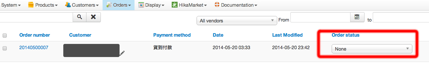

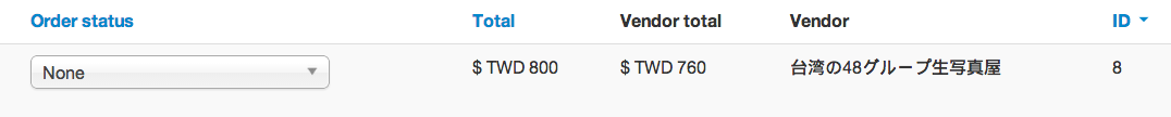

I found an issue not quite sure if it's a bug. Using the vendor account, I've modified the order status to "Shipped" for an order using manual payment collection (eg: COD), with a vendor account. I can see the order are changed successfully from the front-end even the backend. However I still cannot see the order status while try to list via "Orders > Orders", it's defaulted to = none

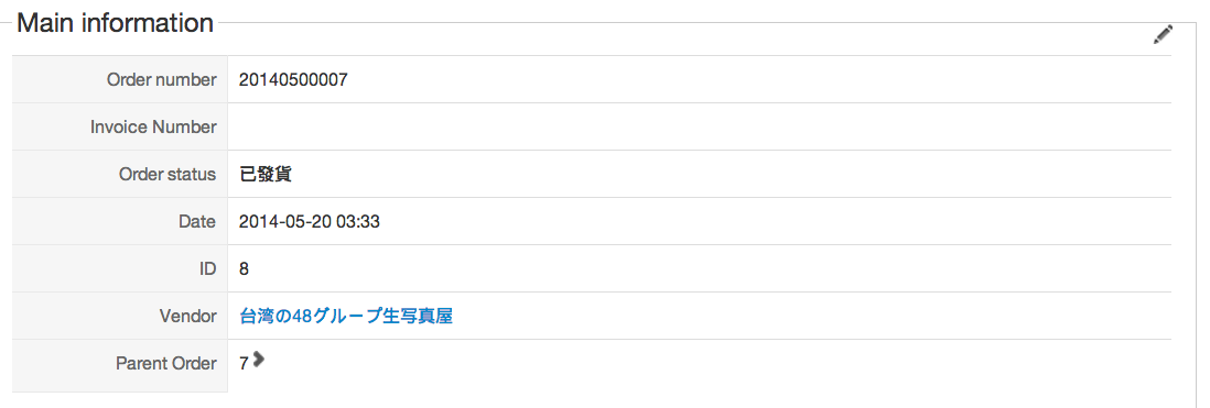

Note: The Chinese characters (Order Status) of the 1.png = Shipped.
Please advise if I need to re-confirm the status again via backend? or it's a bug. Thanks.
p.s. Please see the screens as attached FYI.

There is only 1 item 1 order, and this issue happened with Vendor order only. Let me explain a bit in details:

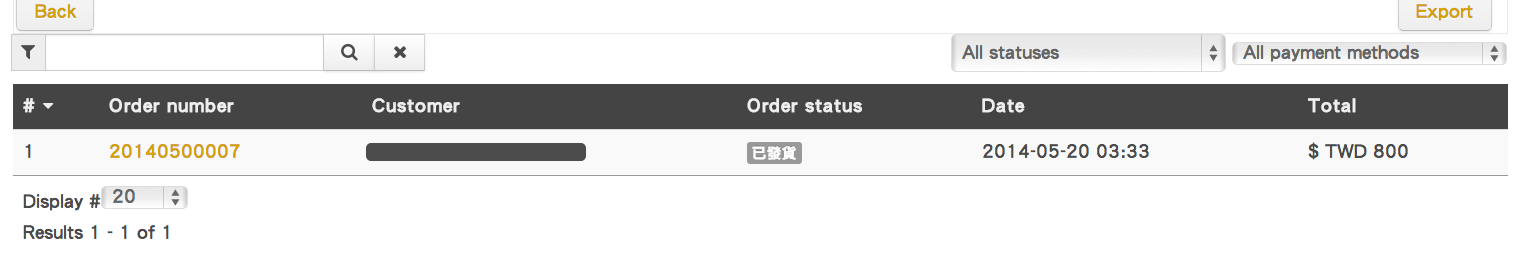

Front-end Vendor account:
- Can see only the order 20140500007 with ID 8
- The vendor changed the order status to "Shipped"
Back-end View:
a- List mode, order 20140500007 with ID 8, Order status = None
b- Click and view details, order 20140500007 with ID 8, Order status = Shipped

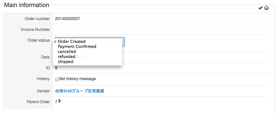

c- When I try to edit the status (in view details mode), the active Order Status = Order Created.
d- Viewing the order 20140500007 with ID 8, enable me to click "Parent ID" > 7

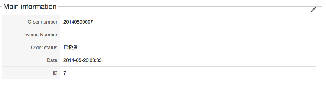

e- The ID:7 order can be viewed only in "No vendor" criteria
f- List mode, Viewing the order 20140500007 with ID 7 (Parent), Order status = None

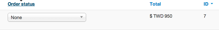

g- Click and view details, order 20140500007 with ID 7, Order status = Shipped

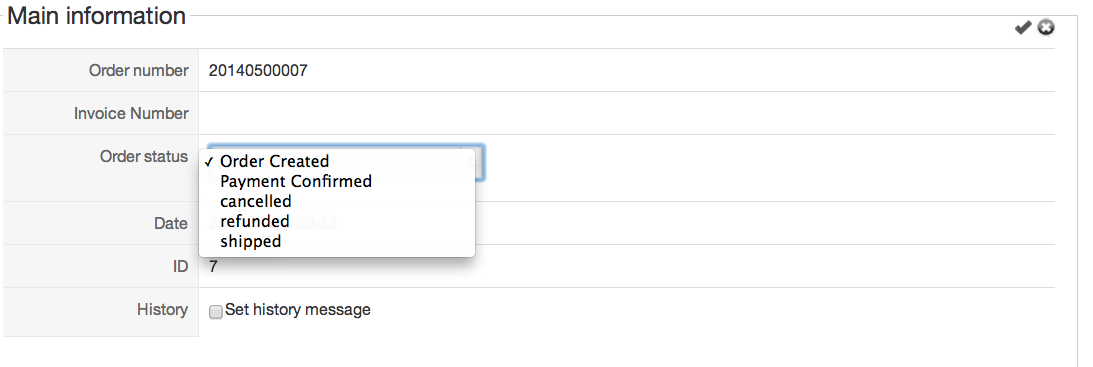

h- When I try to edit the status (in view details mode), the active Order Status = Order Created.
i- Under "HikaMarket orders", I can see the SINGLE order showing "Shipped" as order status.
(Pls find attached pic for your info)
There are few issues / bugs with above scenario, maybe you can try in your environment also.
Point a: the sub-order (ID8) still showing Order status = None in list mode, while it's actually showing "Shipped" when view in details.
Point c: when edit the status, it's active status should be "shipped" (as showing), but actually it ticked "order created" in the pull-down menu
point f: the main-order (ID8) still showing Order status = None in list mode, while it's actually showing "Shipped" when view in details.
point g: when edit the status, it's active status should be "shipped" (as showing), but actually it ticked "order created" in the pull-down menu
- Seems the showing value, pull-down active value, and the list mode value of Order Status are not sync, maybe that's the caused of the issue.
p.s. I have translated the display value of order status, and have installed falang using 3 languages together.
Our UAT is currently in an offline environment... (please refer to above points)
  • Posts: 43
12 years 3 months ago #156629
I have more information for you, I guess the problem maybe come from the Front-end status editing. Here is what I have done.
1) I created another order with single item only, using manual payment. (not Paypal, so the status should be manually managed)
2) Once the order is created, I can see correct status (list, details, pulldown menu editing) for the parent and vendor order from the BACKEND and FRONT-END.
3) I've logged in the vendor account, and change the order (not sure it is main/sub order, but the only vendor) from created > confirmed (payment received)
AND....the problem arise...
4) View from backend, BOTH main & sub order..
- in list mode, order status = none
- in detail mode, order status = confirmed
- in edit mode (pull down menu), order status = created
Strange .... I guess some problem with the front-end editing.
