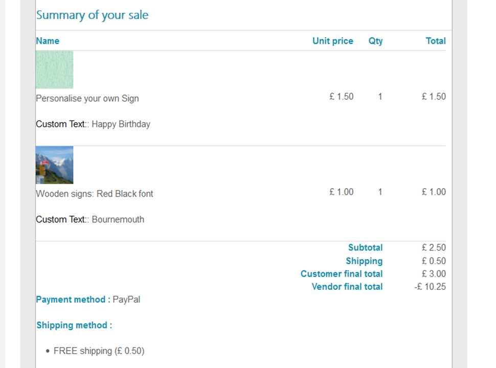

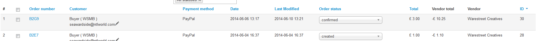

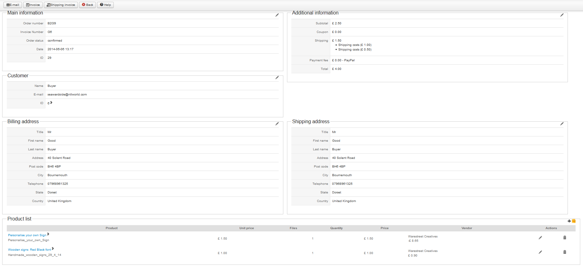

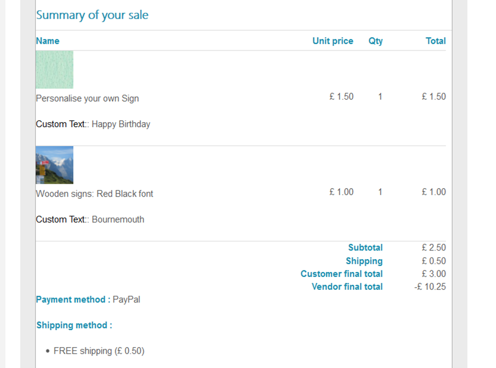

Hi I have created a product, assigned to vendor and given that vendor 10% commission. On the first product (£1) in the order the vendor total is correct - 10% of the total (£0.9). The second product is incorrect. The unit price is £1.50 so the vendor total should be £1.35 however it is showing as -£ 8.65 which seems to be incorrect. Everything else is fine, the correct amount via paypal etc but the backend calculation on the vendor amount is showing up wrong on the order please see attached.
Any ideas what would cause that?
  • Posts: 377
  • Thank you received: 7
12 years 3 months ago #159610
FYI this is how it comes through to the vendor (attached) so is confusing for the vendor also
Kind regards
Alex

12 years 3 months ago #159633
Ok I have attached a larger screen shot to show the shipping prices included, they seem to me to be ok. Please let me know if you need any screen shots of any section.
  • Posts: 26386
  • Thank you received: 4078

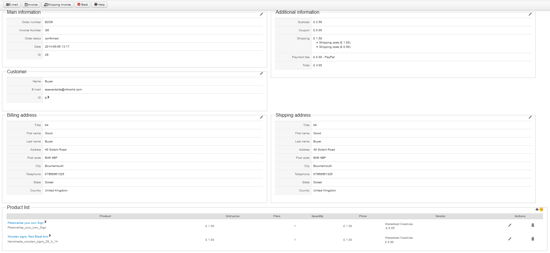

12 years 3 months ago #159639
Hi Alex,
It was too weird so I checked your website using the credentials you gave me by email last time.
The product "Personalise your own Sign" (id 14) have a flat fee of 10£ with a percentage fee of 10%.
1.5£ - 10% - 10£
= 1.5$ - 0.15£ - 10£
= -8,65£
So the price given by HikaMarket is right looking at the configuration.
Please remove the fee configuration for this product.
You can edit manually the vendor price for the created order if you want, so you will have a right price for this specific product.

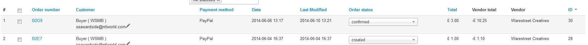

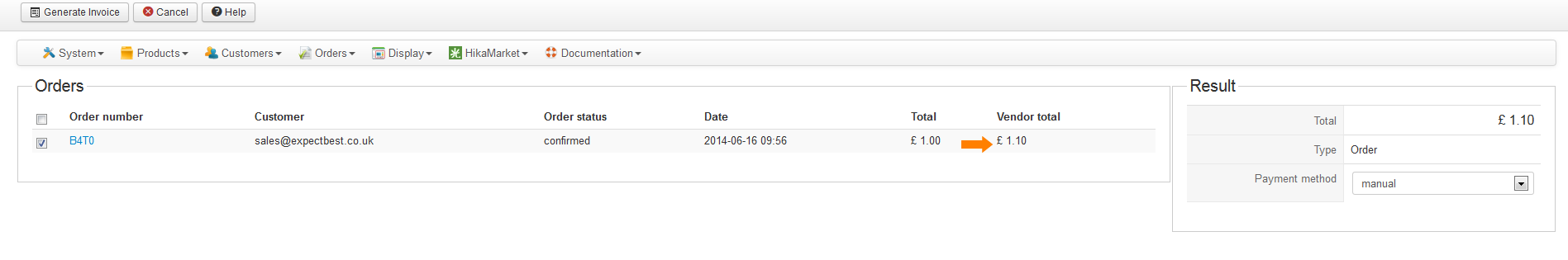

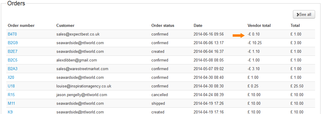

12 years 3 months ago #160404
Hi Jerome,
I am still unsure on some of these calculations are being made.

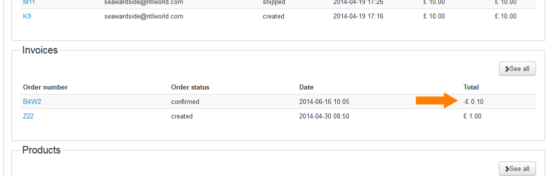

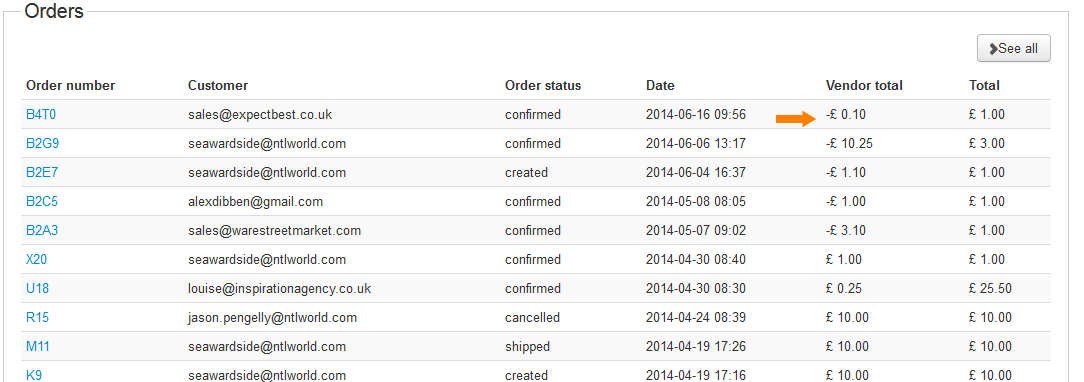

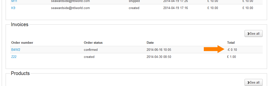

So I have a product that is £1 and £1 shipping = £2 total. We do not share commission on shipping as the vendor needs that to ship the item. I have no fee in the product only 10% commission for that seller. So everything goes through fine. I set status to confirmed in backend and then go to the vendor. However when i click on the vendor now it says that the vendor is owed £1.10... Which is strange. So when i click on the full vendor account it says that i owe the vendor total of -£0.10? If i click through to invoice, it will say the vendor total is £1.10 but surely if the commission on that vendor is just 10% and there are no other settings the invoice to the vendor would be £0.10 not £1.10? I would then transfer them the £0.90 manually and keep the £0.10 as payment of the invoice?
Kind regards
Alex

  • Posts: 26386
12 years 3 months ago #160419
When a price is negative it means that the vendor has been paid directly (a payment method with "commission" mode) or that the order is in a refund status.
I made some modifications in HikaMarket to improve the display when using fee and commission modes in the same time.
The problem is when we started HikaMarket there was only the fee mode and the commission mode come after and not with the better circumstances.
Because the mode wasn't planned at the begging, some part of the display does not right manage it.
  • Posts: 377
12 years 3 months ago #160452
So is this something that has been fixed in a more recent version of hikamarket? Sorry i am not clear did you patch it today or do i need to change a setting somewhere? I understand there is a display issue but i am still not sure how to fix it. I checked the shipping but see no reference to the fee/commission mode, the order is not in refund status so it cannot be that which is causing it it is currently set to 'confirmed'
Kind regards
  • Posts: 26386
12 years 3 months ago #160477
Hi Alex,
You are using the "commission" mode in HikaMarket but your payment plugin is "paypal".
Paypal does not authorize the vendor to be paid directly, you (your store) will receive the money, the "commission" mode can't do anything good ; on the contrary, it will provide wrong results.
Because you are in commission mode, HikaMarket think that the vendor is paid directly so when you want to "pay" the vendor, it is the inverse. HikaMarket think that you will create an order to be paid.
If you change the HikaMarket mode in your tests, it will result very strange and no working orders ; where the vendor should receive the money and you want to be pay.. It is just not possible to do any debug or else with that.
So, please make a full stable HikaMarket configuration and then make your tests.
If you mix the tests, it is logical that you will have bad results.
