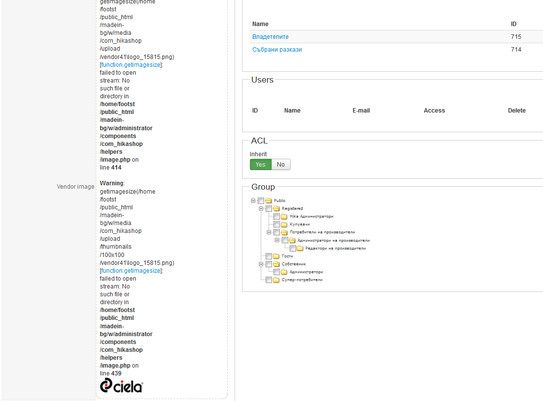

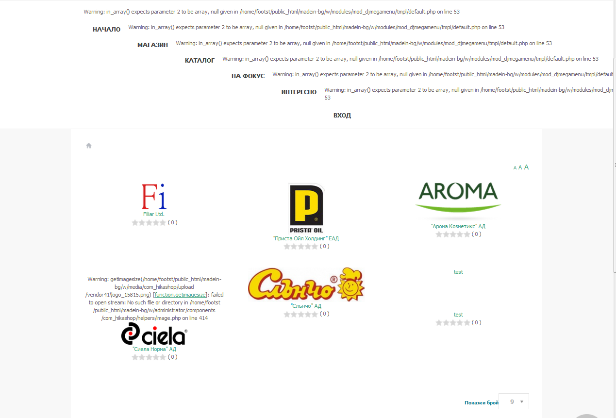

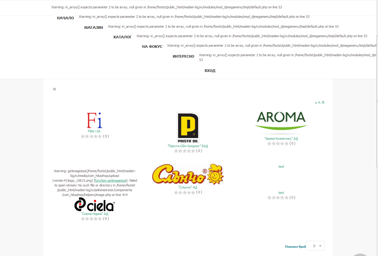

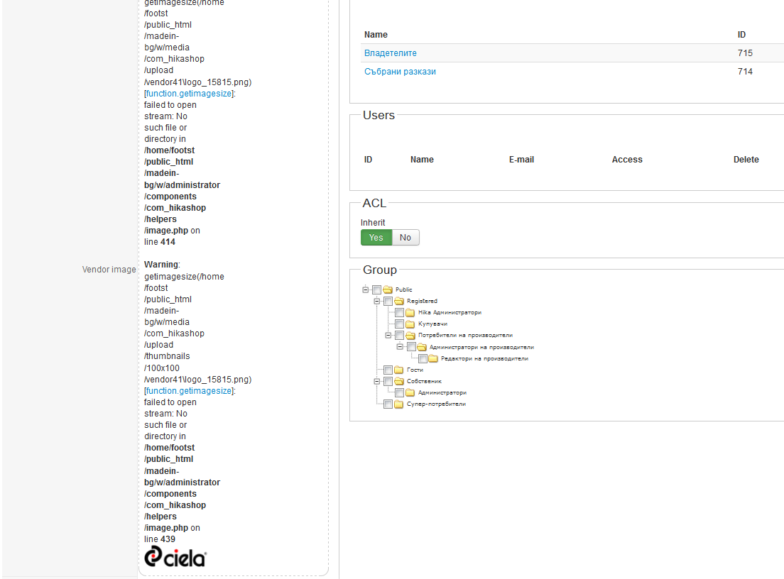

So, after updating to HM 1.6.0 the following error appeared on uploading from local project to working:
On the image of Vendor listing in frontend and on Vendor image in edit form in backend:
Warning: getimagesize(/home/footst/public_html/madein-bg/w/media/com_hikashop/upload/vendor41\logo_15815.png) [function.getimagesize]: failed to open stream: No such file or directory in /home/footst/public_html/madein-bg/w/administrator/components/com_hikashop/helpers/image.php on line 414
And the second warning appears in the main menu only on vendor listing page:
Warning: in_array() expects parameter 2 to be array, null given in /home/footst/public_html/madein-bg/w/modules/mod_djmegamenu/tmpl/default.php on line 53
I noticed the backslash after the vendor folder if that's the reason.

I forgot to mention that this happens only when the modifications are made locally (XAMPP for Windows) and then uploaded to the working server. No such error appears when the vendor is added online.

Please check that the file "media/com_hikashop/upload/vendor41\logo_15815.png" exist and has been transferred.
Then you can see to edit the HikaShop helper image and replace
list($origin->width, $origin->height) = getimagesize($fullFilename);
By
list($origin->width, $origin->height) = getimagesize($clean_filename);
About the warning in "mod_djmegamenu" ; I can't help you, it's not HikaShop/HikaMarket related.

Images are there and are displayed.
I made the modifications but Still no effect.

Adding this code on line 414 worked for me:
$fullFilename = str_replace( '\\', '/', $fullFilename);
$filename = str_replace( '\\', '/', $filename);

Okay.
Windows and Linux are not using the same character for the folder separator.
I made a report for your issue to HikaShop (because it's in HikaShop, not HikaMarket) and they will made a patch for the next release.

And in case someone else experiences simmilar problem - the menu issue was also connected somehow with this, because after the code modifications above it is now working as expected.
