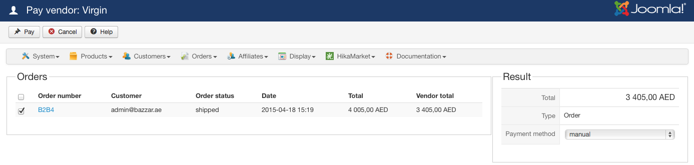

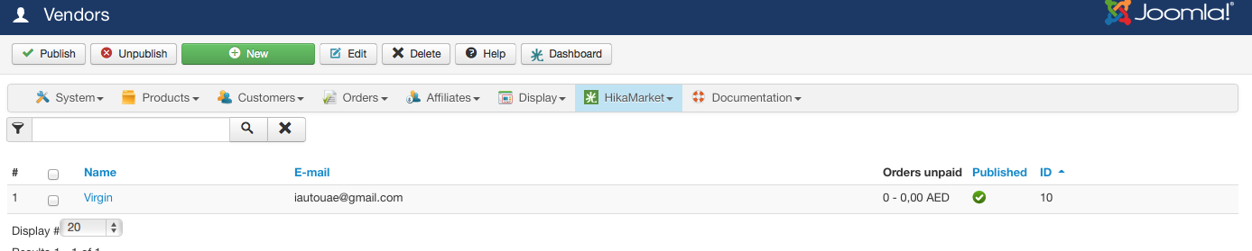

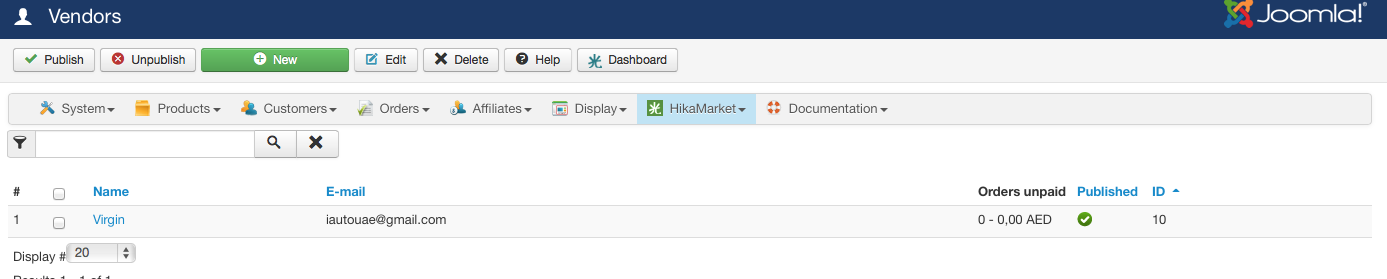

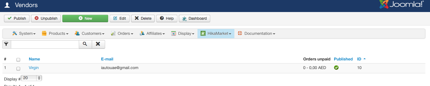

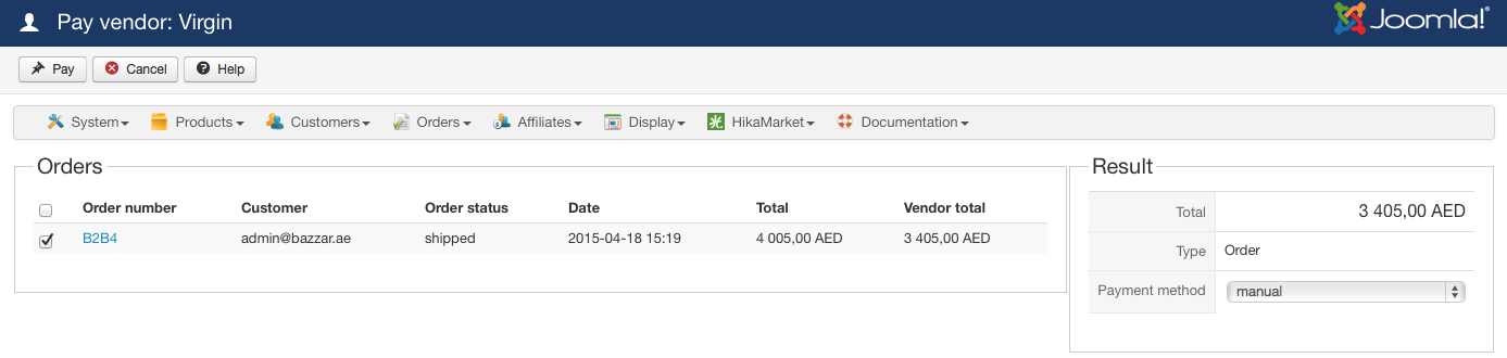

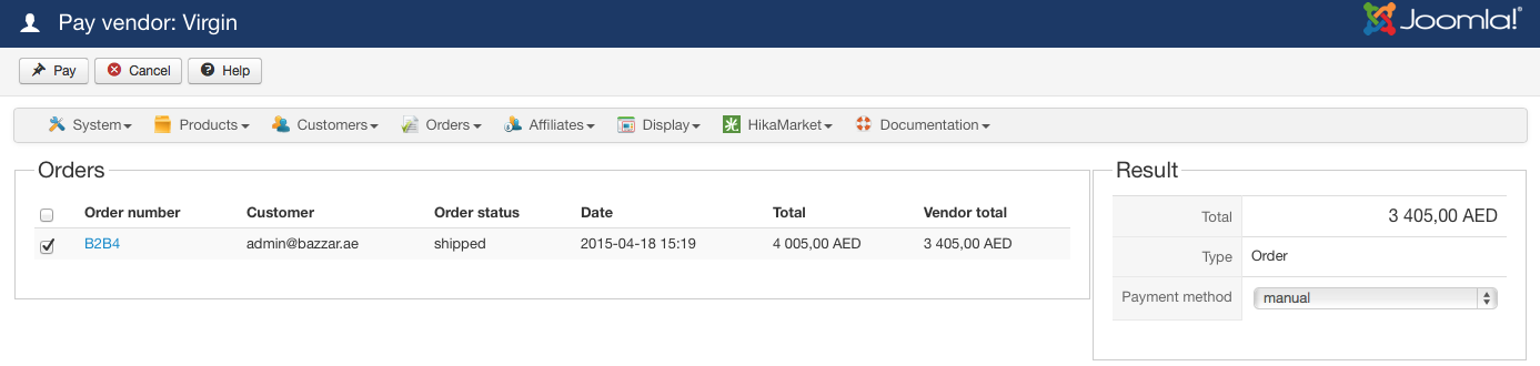

I have a issue with the vendors section. The table shows me that i have 0$(AED) unpaid to the vendor even though there is money that needs to be paid to the vendor. The valid status is set to confirmed. Even after confirmation it shows 0$ unpaid.
But i can still press "Pay" button. Please help, very important for my shop!
Ive attached screenshots for more info
Thank you guys as always! :) :)
  • Posts: 26381
11 years 4 months ago #199136
Please be careful when you give us details about your versions because HIkaMarket 2.4.0 does not exist.
In the file "administrator/components/com_hikamarket/views/vendor/view.html.php" please replace
$shopConfig = hikamarket::config(false);
$invoice_statuses = explode(',', $shopConfig->get('invoice_order_statuses','confirmed,shipped'));
By
$config = hikamarket::config();
$invoice_statuses = explode(',', $config->get('valid_order_statuses', 'confirmed,shipped'));
It should fix your issue.
