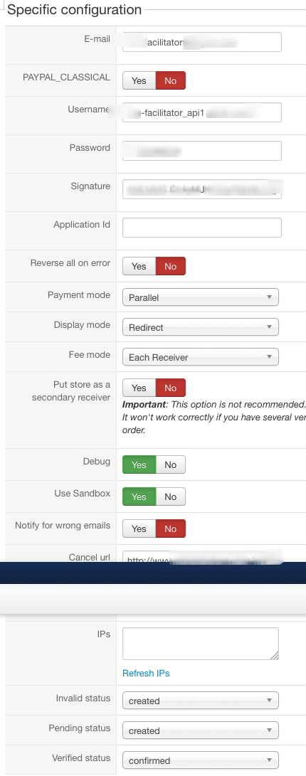

Can you please provide a screenshot of your paypal adaptive configuration (the sandbox one) ?

I'm attaching a screenshot of the settings for sandbox. These settings work initially, but when I change to live and get the receiverlist null error and then switch back to sandbox w/ exact same settings I still get the same error. It's like something is getting stuck when I switch to live, so I don't know what's causing the error in either live or sandbox. Note: I've tried w/ "notify for wrong emails" set to both yes & no, w/ no effect on the error.

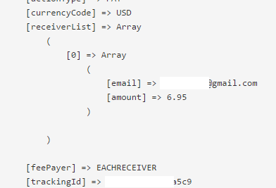

I performed two test orders in order to check the vendor total and the second with the "debug" activated (but without the sandbox).
And how you can see in my screenshot, the receiver is a gmail address, the vendor address, and not your paypal store email.
So, for what I saw, it is now working quite better then before
