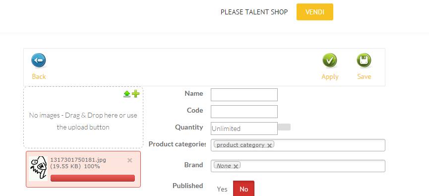

I can't upload product images. Upload seems to start but it stuck at 100% (like in the image attached).
There's no error on php logs.

So you should use the browser console in order to see the XHR call (for the upload) and get the return content.
Because the upload is marked as failed by the javascript library, the return content is not a json confirmation code ; because you do not have any error message display, it should not be a json error code either.
So it's possible that you have a PHP warning or a PHP error. But without the error context, it will be difficult to know the source (and to provide a fix).

There's no php error or warning. On browser console there's only warning from tinymce ('webkitMovementY' is deprecated. Please use 'movementY' instead)
I can upload images from the backend (Control Panel), but i can't from frontend.

The problem has been also reported in another thread.
So I performed an investigation and find the issue.
You can re-download HikaMarket 1.6.6 to get the patch or you can apply it manually.
Instructions are in that thread : www.hikashop.com/forum/20-market-feature...ront-end/216824.html
