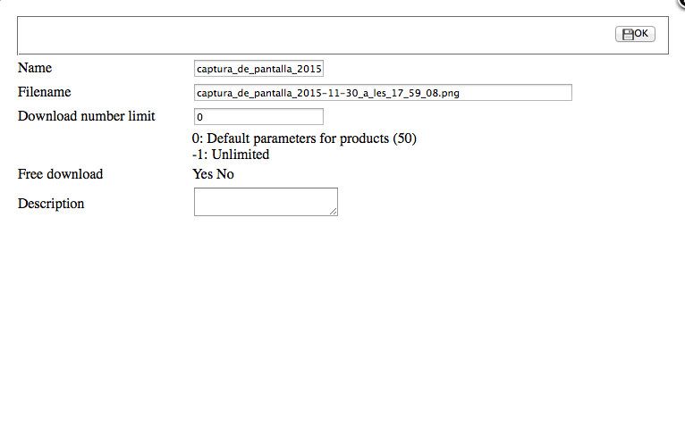

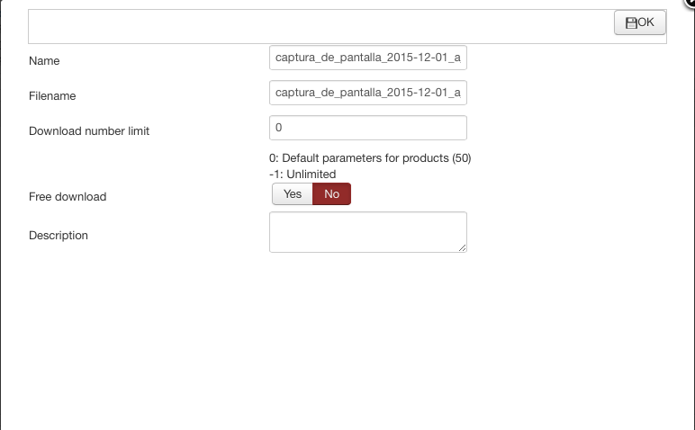

Additionaly my frontend file settings Popup looks broken and inaccessible. Does this depend on a setting?
while in backend looks usable

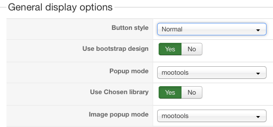

About the broken popup these are my actual settings for hikashop General display options
anyhow I played with many combinations and no porgress was percieved.

10 years 8 months ago #222742
Can you please check your PHP error log in order to see if you don't have any error at the end of the page ?
I can't reproduce the issue in my local website (and in the demo website) so I see different possibilities :
1 - An PHP error which stop the processing of the page
2 - Issue with the template and the "component"
3 - Incompatibility with the template which does not compatible with the bootstrap design in the "component" view.
Because I suppose that you have working "yes/no" buttons in the product edition page.
