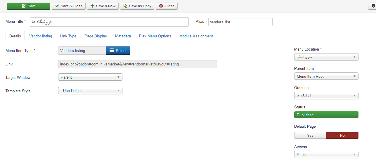

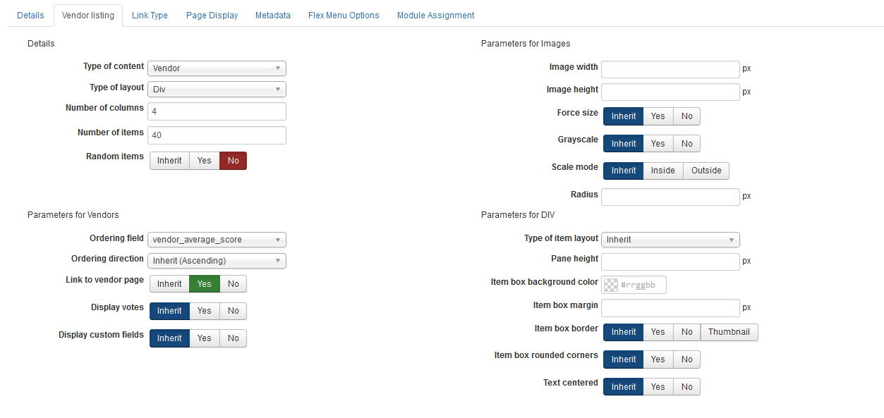

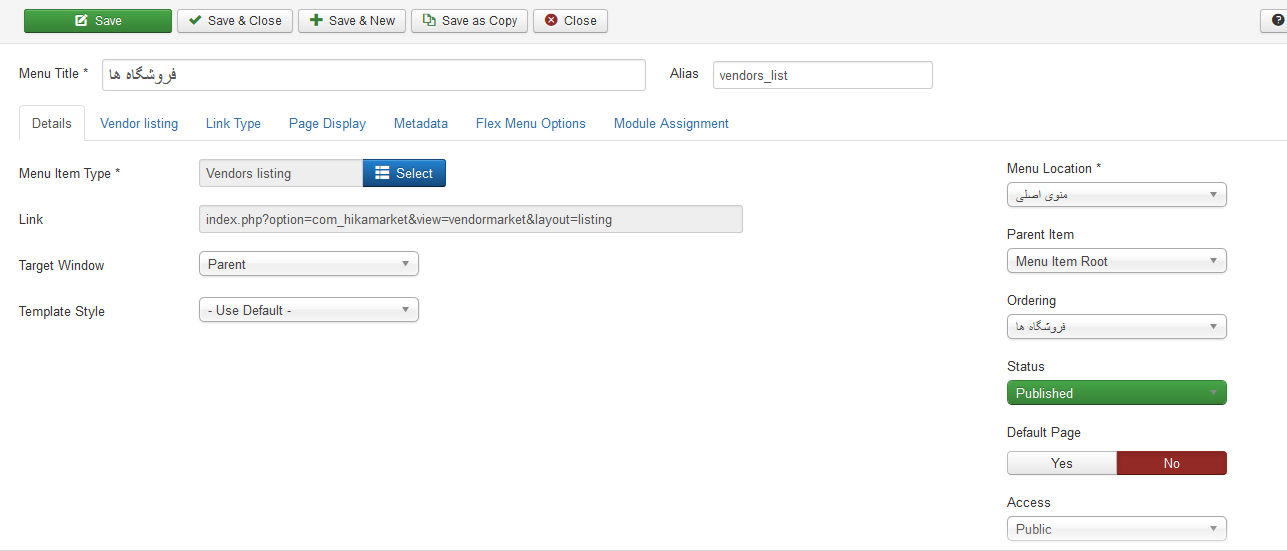

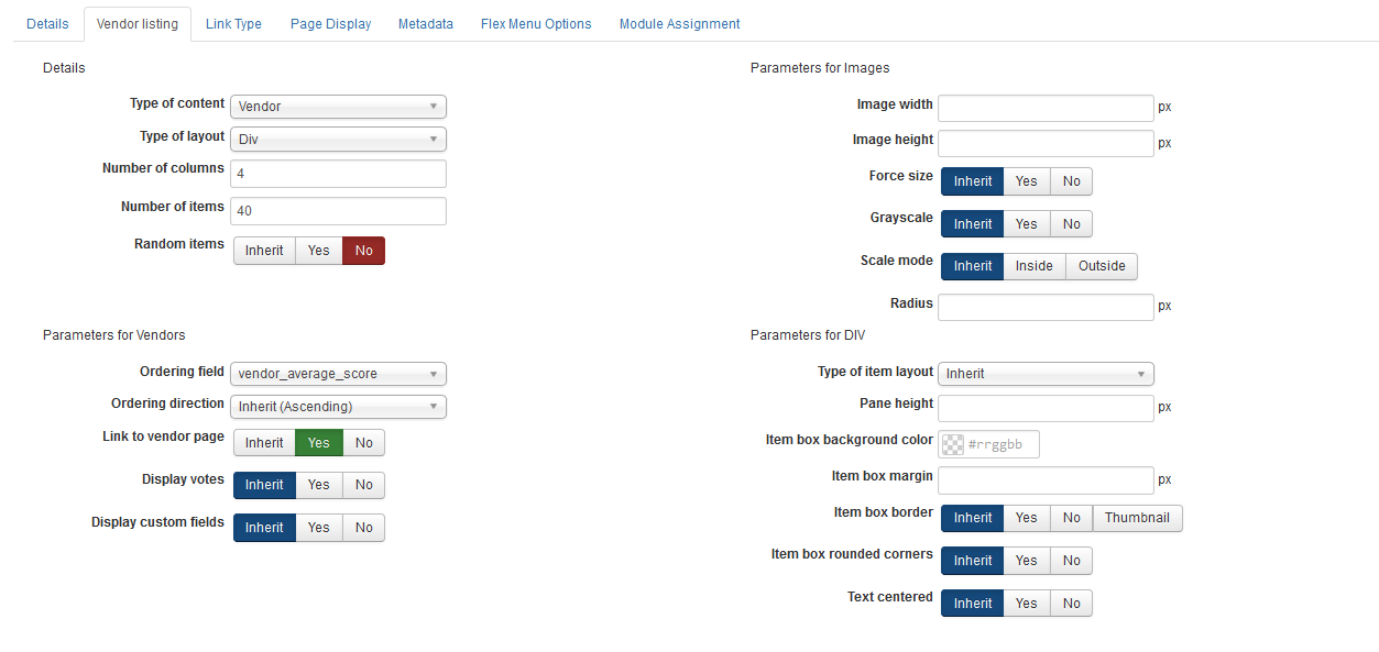

  • Posts: 54
10 years 8 months ago #223424
See the attached images. I captured two screenshot of the menu configuration. Is that help?
