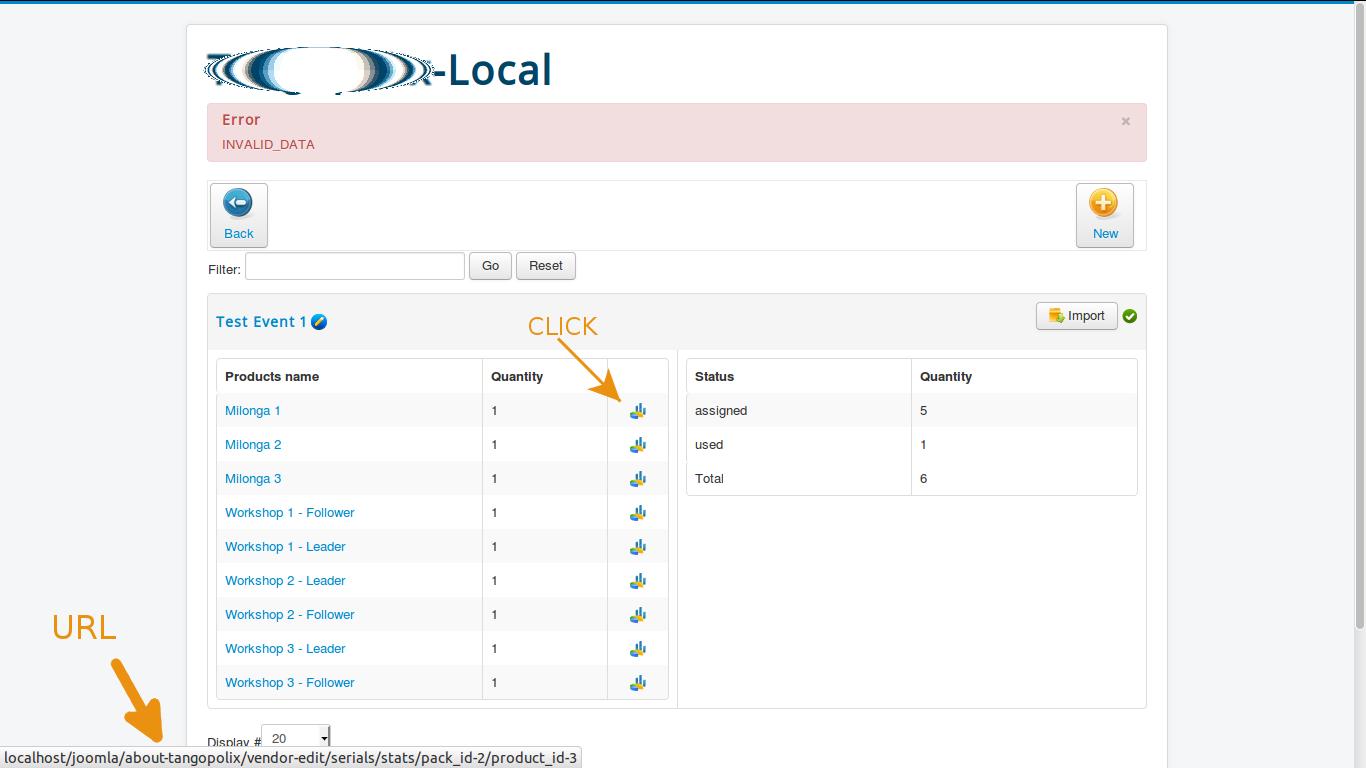

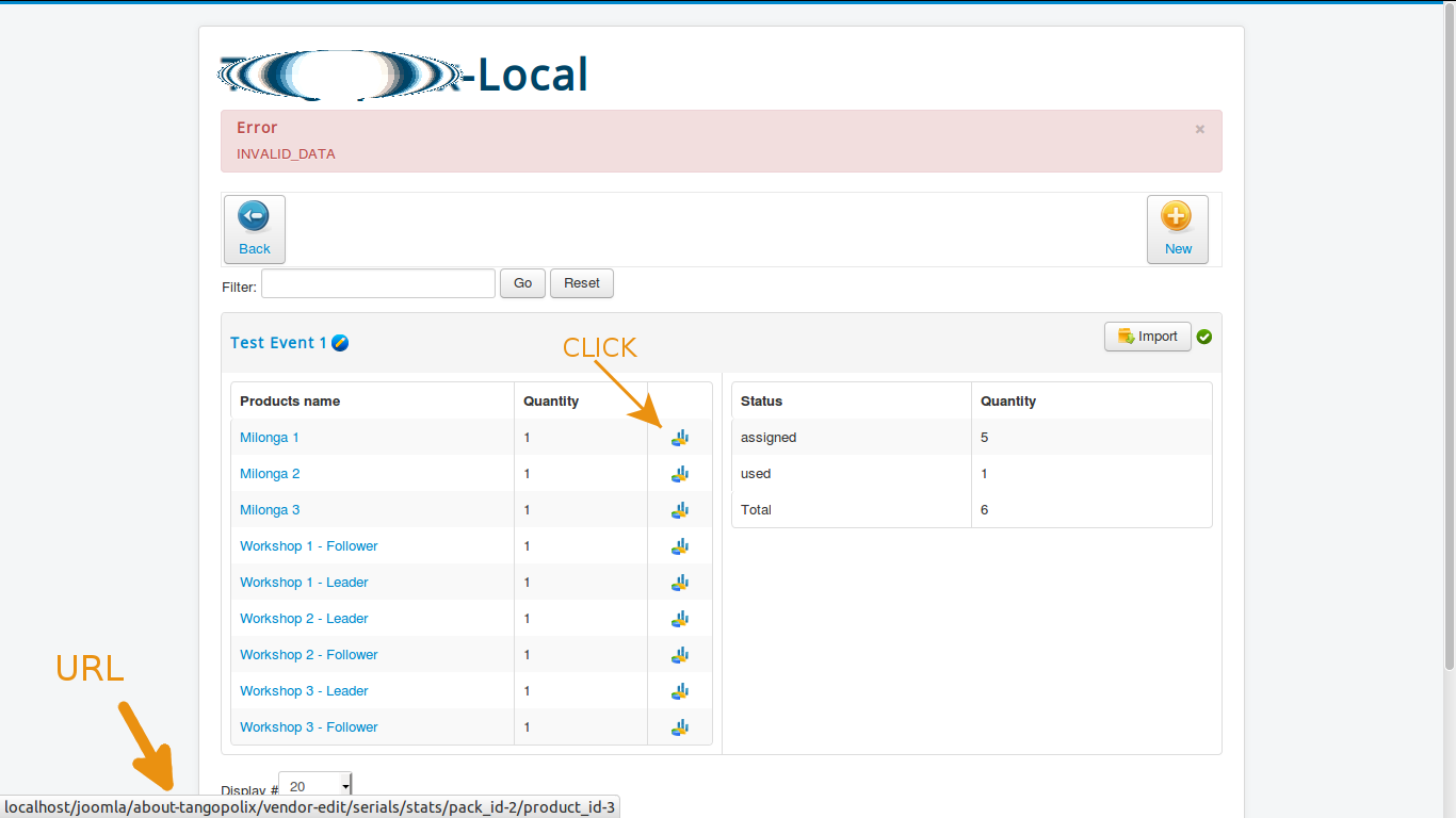

I'm using Hikaserial and HikaMarket multi-vendor and I'm having an issue with vendors managing serials from the front end.
In this case, when a vendor goes to into “Serials” from his Vendor Account then it is presented with the screen like the one in the attachment. It shows the packs and the products that are linked with that pack. That's fine, but when I click on the stats icon for any of the products I get an error message INVALID_DATA.
In the attachment I show you where I click (the stats icon) and the URL that the stats icons points to (when I hover over the icon).
In the backend the vendors have all the permits enabled in the “Default Store Access”.
Any idea what might be going wrong?

  • Posts: 128
9 years 10 months ago #247609
Yes, product with ID=3 and the rest of the products are correctly assigned to the vendor I am logged in with when showing the screenshot.
The same error message occurs when trying to see the stats for the other products as well.

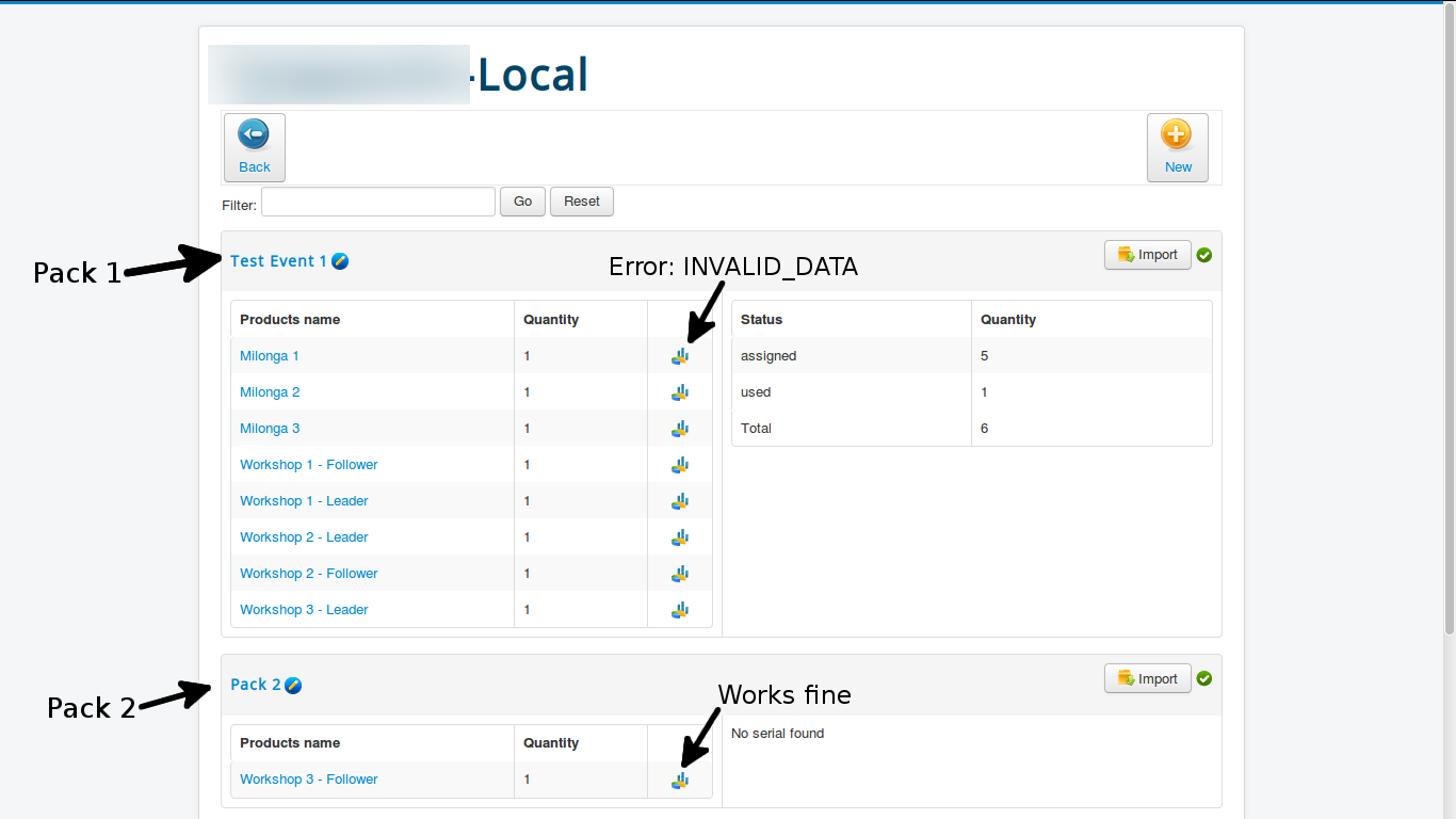

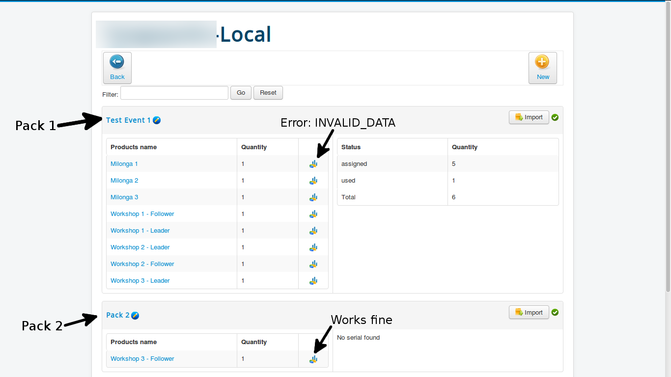

I did more troubleshooting on this issue and I found out the following:
- The issue appears when there are more than 1 product linked with a particular Pack of serials.
- If I only have one product linked with a particular pack then the stats show fine.
- Please see the attachment for further clarity
Is this the way it is supposed to work? So, if we want to see the detailed serial stats for one product in the front end of Hikamarket, then we need to create one pack per product?
Please advise, thanks!

9 years 9 months ago #249819
Thanks !
Please edit the file "administrator/components/com_hikaserial/classes/pack.php" and replace the line
$vendorPackCache[$vendor_id][$pack_id] = ((int)$db->loadResult() == 1);
By
$vendorPackCache[$vendor_id][$pack_id] = ((int)$db->loadResult() > 0);
And it will fix the issue for the vendor pack detection.

9 years 9 months ago #249843
Thanks, that sorts out the issue.
