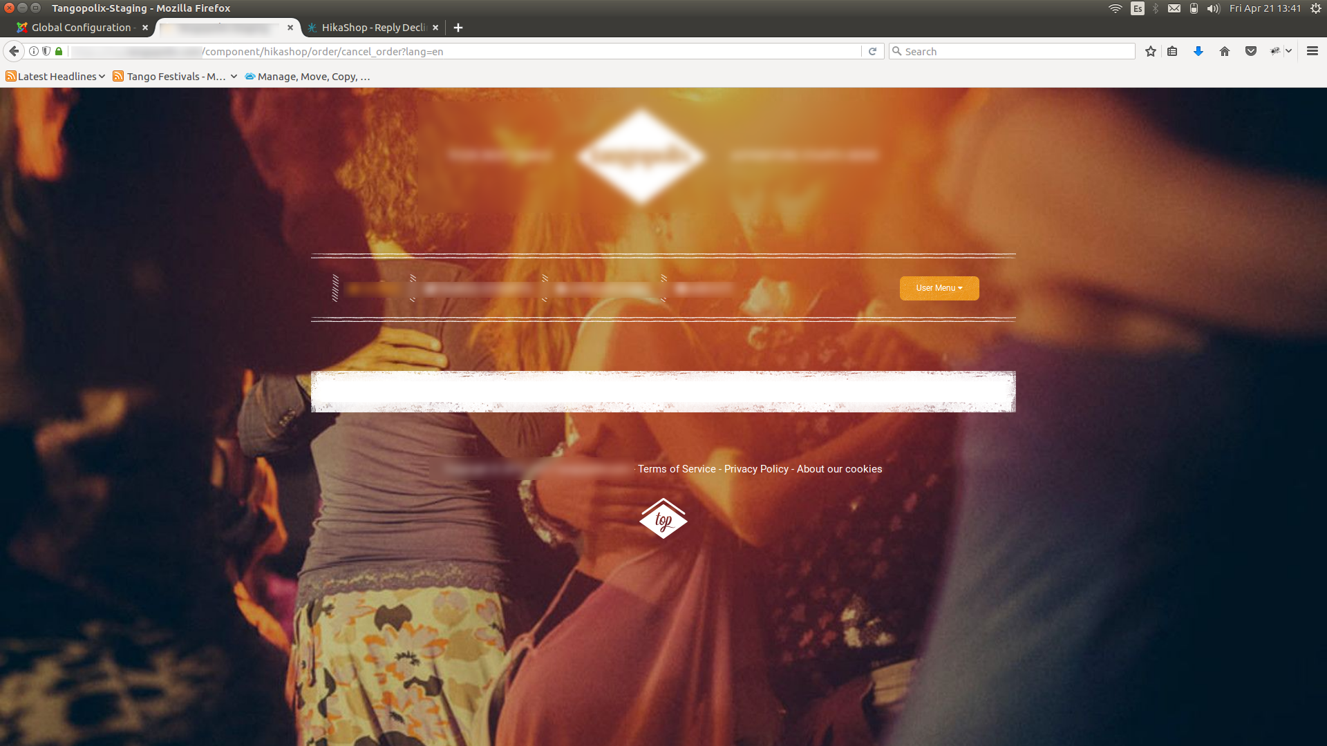

Hi there,
I’m using MangoPay as the payment method and I have an issue when the user’s card is declined by MangoPay since the user is NOT being redirected to the URL I expect it to.
In the Payment method Configuration I have setup a Cancel URL as follows:
myweb.com/index.php?option=com_content&view=article&id=15
Which is a Jomla menu item which contains a single article.
However when the payment is declined by Mangopay the user is redirected back to:
myweb.com/component/hikashop/order/cancel_order?lang=en
Which is a completely blank page (on the component area of Joomla).
I have also noticed that the order created before redirecting the user to the MangoPay gateway where the card is inserted, stays as created. And in the Payment method configuration I have setup Invalid Status as Cancelled. Shouldn’t the order be cancelled automatically?
No errors in the MangoPay log.
To generate the declined payment in MangoPay sandbox you have to use a valid testing card and type 999 as CVV code
Thanks!

9 years 6 months ago - 9 years 6 months ago #267911
by sabroso
Replied by sabroso on topic Declined Mangopay transaction not properly redirected
Hi, thanks,
Sorry it is not a full blank page. All the modules, menus, etc load fine, it is just the area where the component displays has no content at all (see attached)
I'm testing on a testing environment with PHP error reporting set to maximum and I don't see any fatal error, warning, notice or anything in fact. Nothing gets added to the error log either when I perform this operation.
The order does not get updated and there is no redirection to the cancel url which I have setup in the plugin config.
