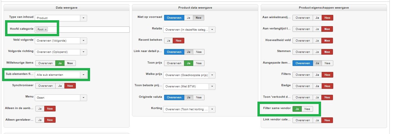

Sorry to be not clear. What I mean is: see all products from the same vendor below a current product on a product page. Before the update to hikamarket 2.0.1, this was possibible.
Now, after the update, I see all products of all vendors below a current product of a vendor. So it seems that the filter is not working anymore.
In the Hikashop content module I have set up for this, the main category is selected, sub element filter is set to "all subelements" and the "filter same vendor setting" is turned on. So it should remove all products that aren't from the same vendor of the current product on the product page. Please see attached screenshot of the configuration.

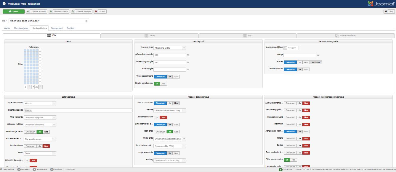

provide a screenshot of the configuration for the element which have an issue.

  • Posts: 115
7 years 5 months ago #287036
This is what you mean?
  • Posts: 26256
  • Thank you received: 4041
7 years 5 months ago #287037
Yes, it is what I mean : the configuration of the element (module in your case) which have the issue.
The setting "filter same vendor" available in HikaShop modules is working for the vendor pages. It can also apply the filter if the view object have a "product" object.
But that setting did not work for the product pages ; so unfortunately the HikaMarket update cannot deactivate a feature which was not there before.
So I suppose that you have modified the HikaShop core in order to patch and add the feature ; modification you lost during the update since it restore all core files.
But there is no regression in the HikaMarket features.
Now, we can see to improve the core and see to implement a compatibility of "filter same vendor" with the HikaShop product page.
It is something I'm not found off since the code won't be flexible and compatible with possible HikaShop evolution.. That's the reason why I did not put that feature before and still prefer having a better solution for nicer implementation.
