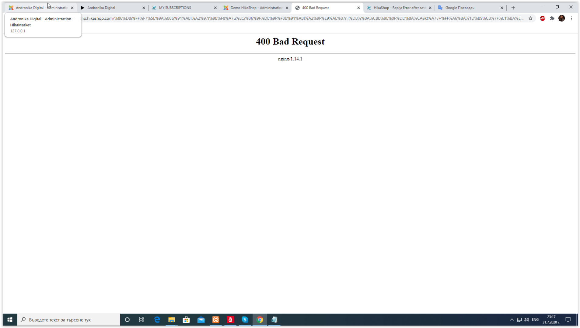

6 years 3 months ago #322520 by neo191987
-- HikaMarket version -- : 3.1.1
Hi, when I add a new variant as a vendor, after saving the variant, I will receive the specified error. Applies only to variants, for creating new products no problem.

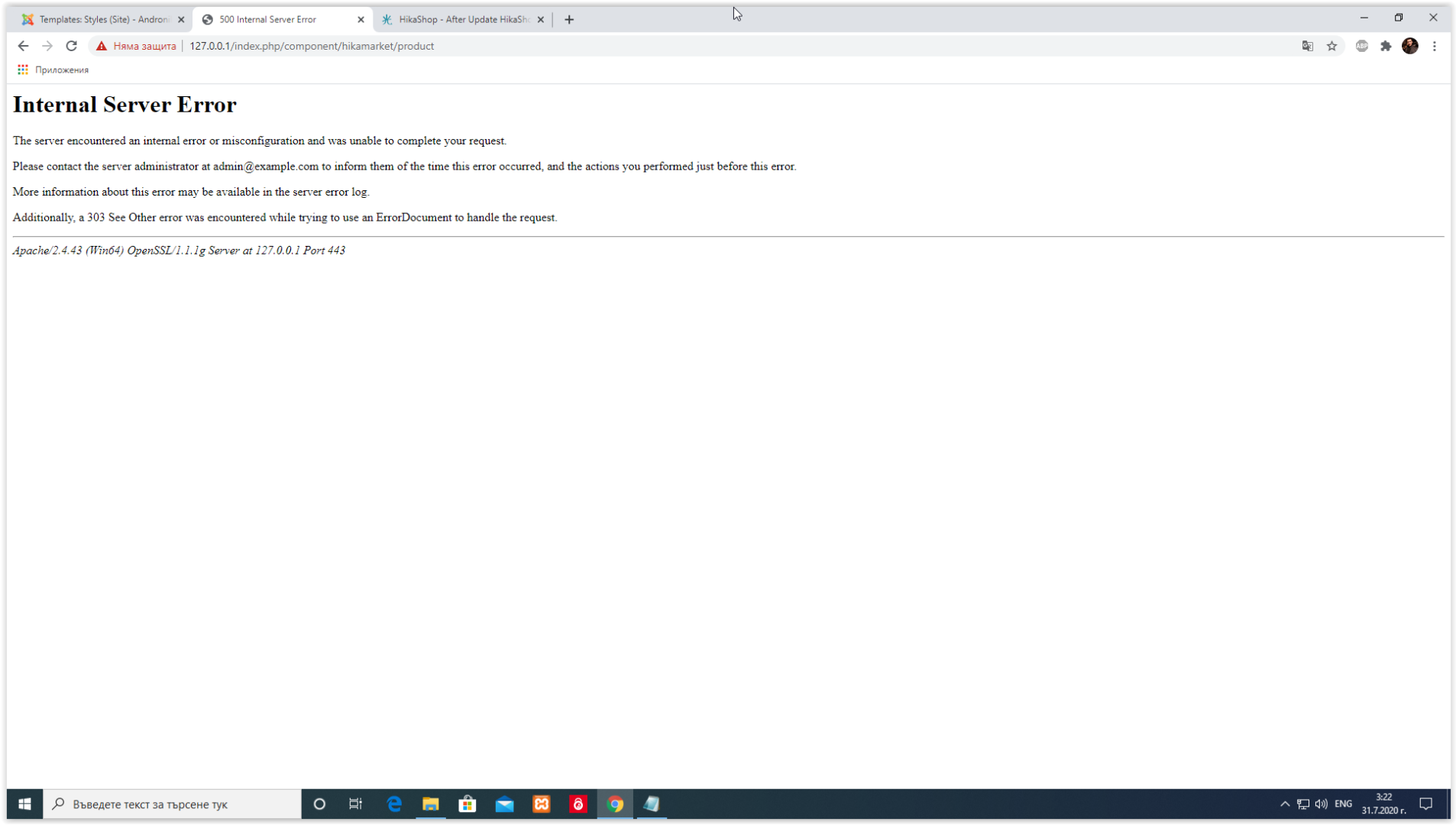

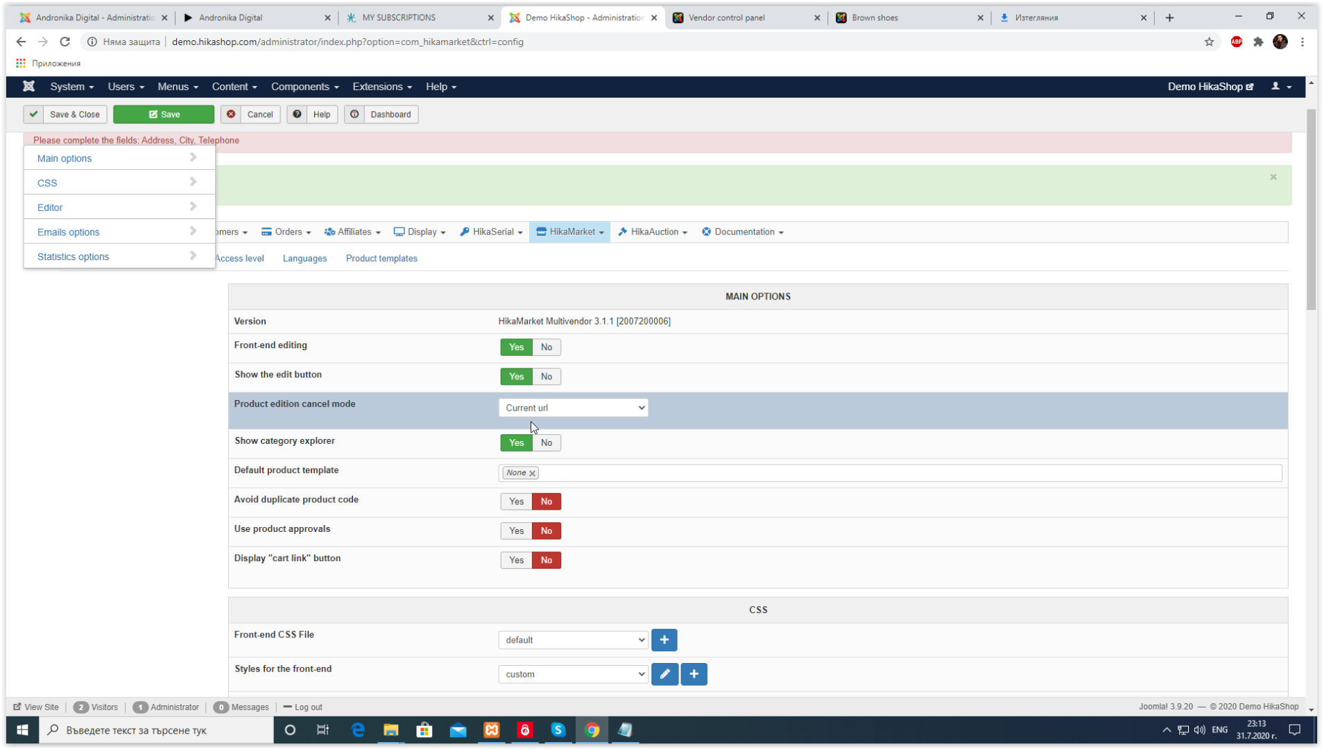

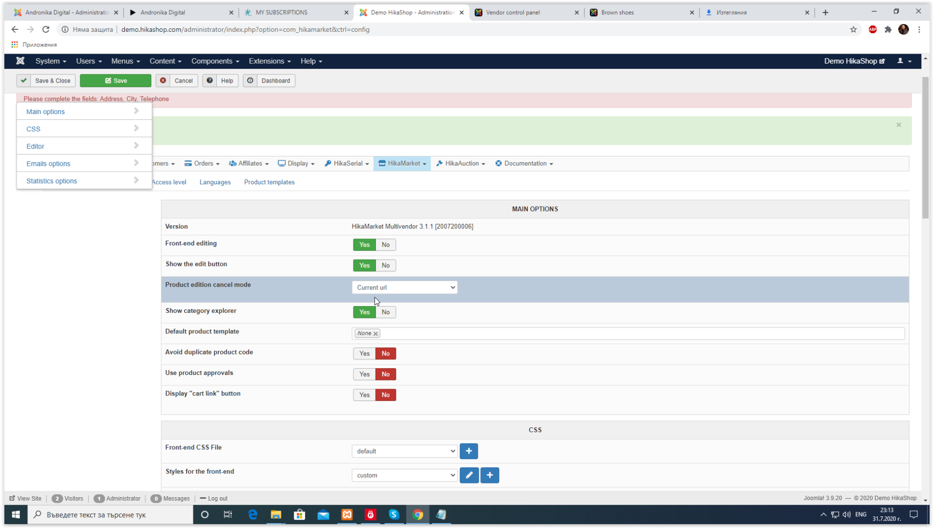

6 years 3 months ago #322568 by neo191987
The problem has been identified and is caused by the setting: Product edition cancel mode - Current url.
Test
demo.hikashop.com/index.php/en/hikashop/...product/4-brow-shoes
The result

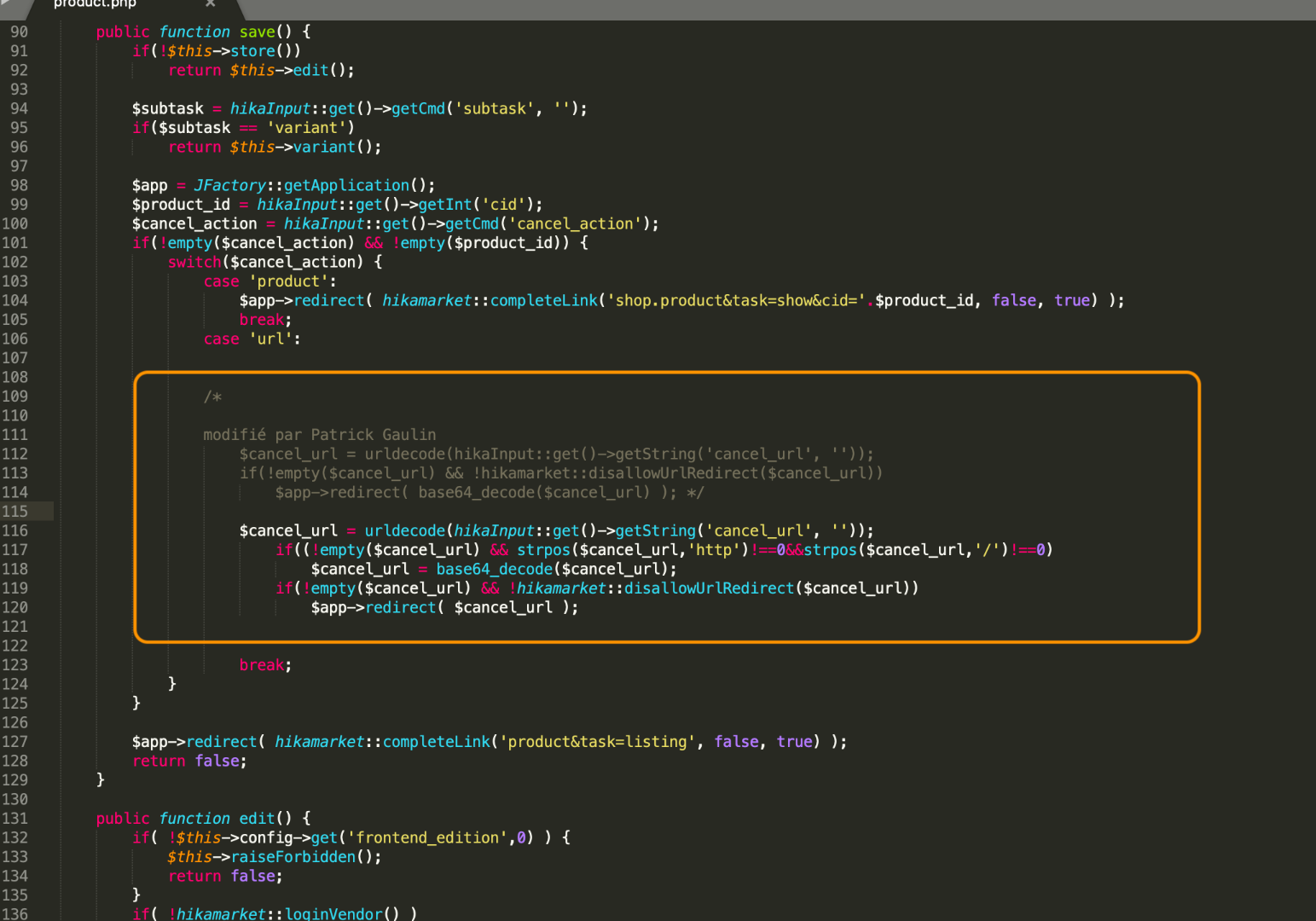

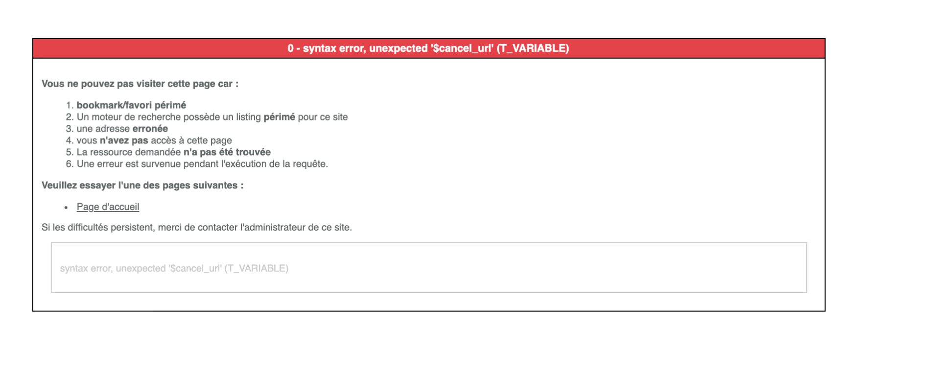

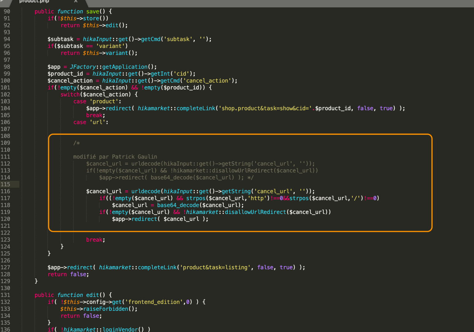

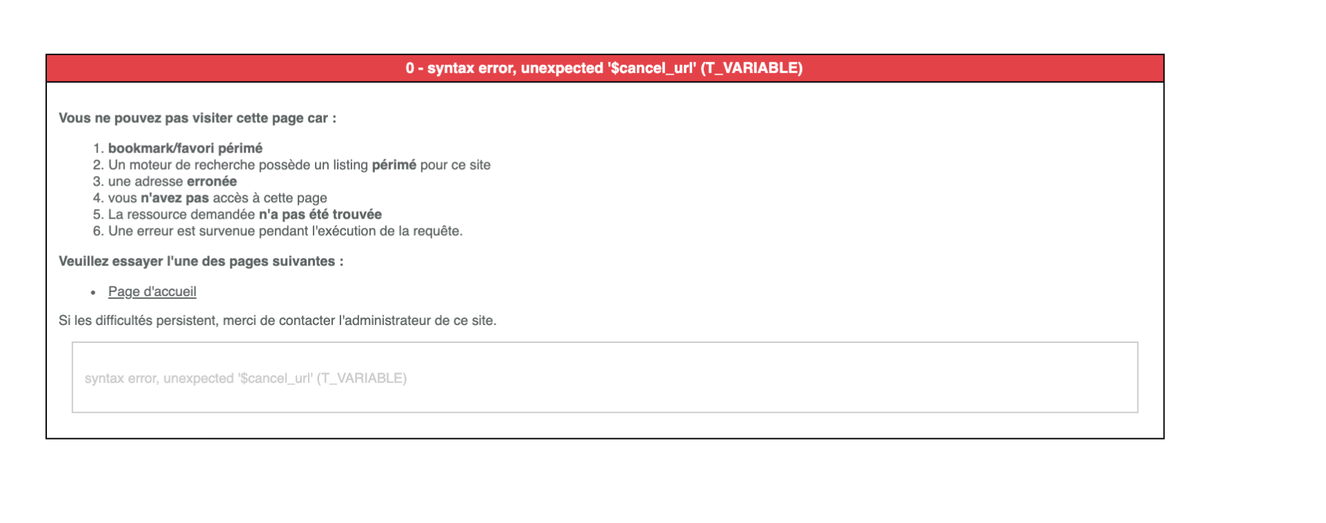

6 years 2 months ago #323519 by patoushka
Thank you for your answer. When you write "temp hack" will it be added to the next release of Hikamarket?
I changed the code and now, I have an error when I click on the edit button. What am I missing? Did I put it in the wrong place?
Thank you again for your precious help.
More information:
The code:
The result:
6 years 2 months ago #323523 by Jerome
When I edited the message 3 weeks ago to clean a bit the code, I introduced a typo (extra parenthesis).
In HikaMarket, a different patch has been added for the next release, the patch is there to fix the problem in the current version.

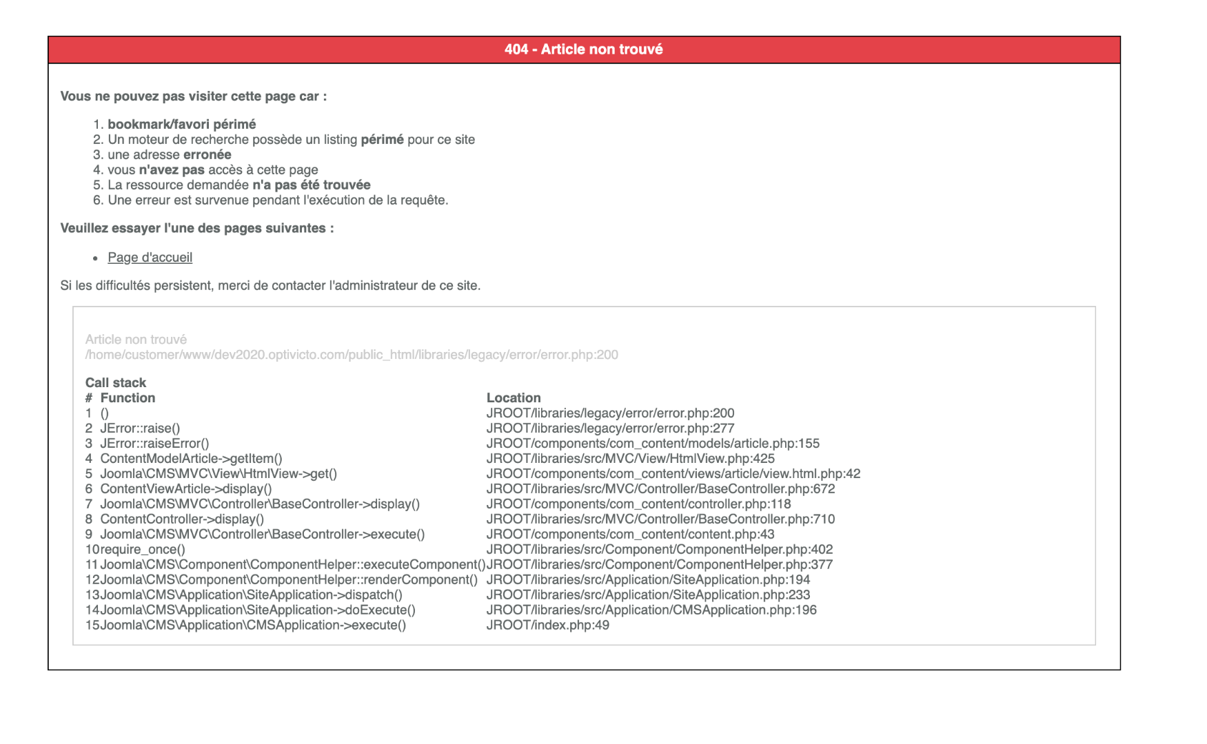

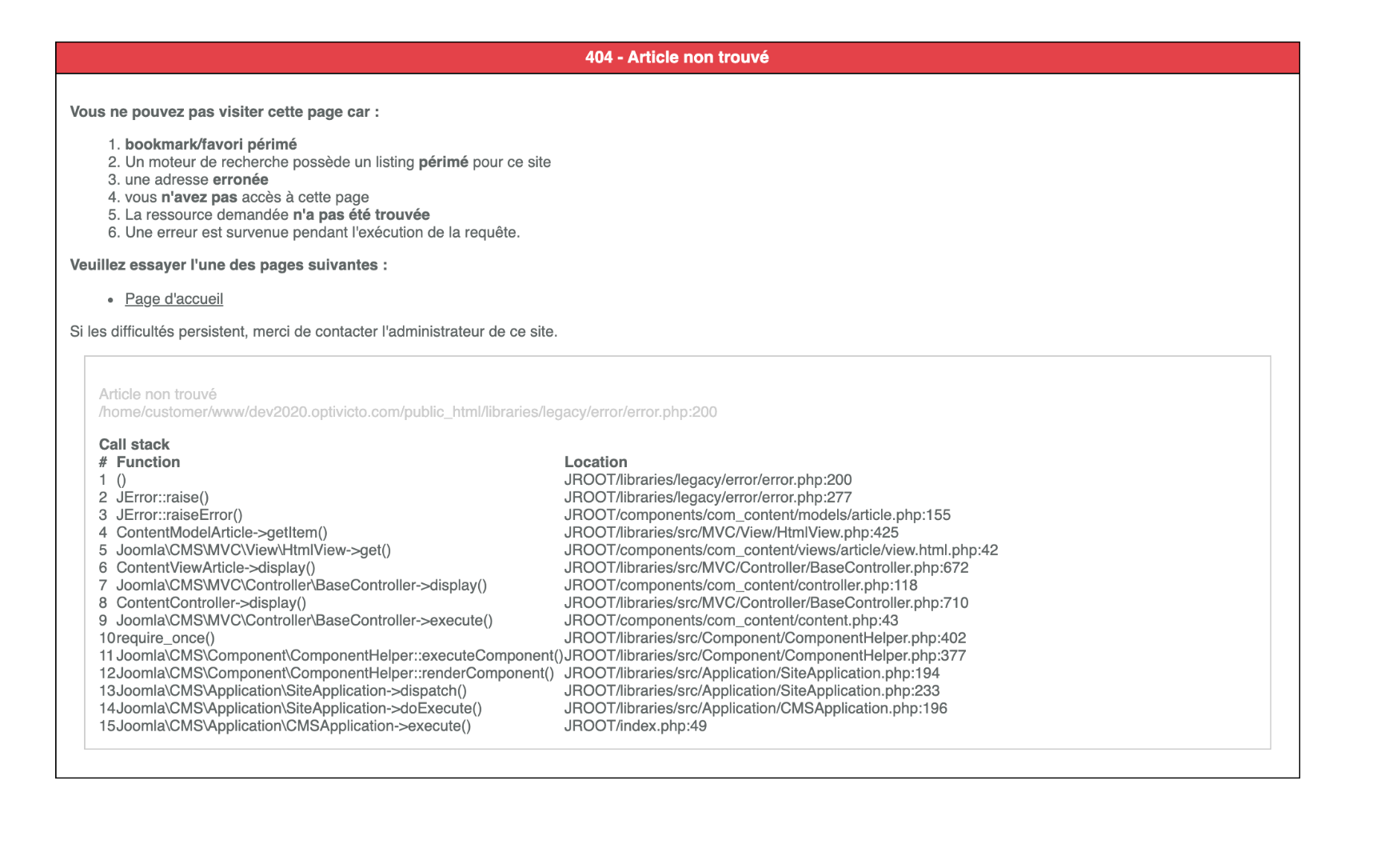

6 years 2 months ago #323535 by patoushka
Thanks for the precision. What about my error after editing the code? I turned off the hack and I receive this alert when we click on the save button. Any idea?
6 years 2 months ago #323556 by Jerome
What is your URL when you got that error ?
(you can remove your domain name)
6 years 2 months ago #323560 by patoushka
/component/hikamarket/product
Many thanks!
6 years 2 months ago #323589 by Jerome
I'm afraid that I can't explain your issue right now.
The URL you have seems to be a valid and working URL ; even if it's better to have a menu for the HikaMarket vendor panel and not use the common Joomla SEF (when you have an URL starting with "/component/").
If you have an error generated by "com_content", it means that the URL is handled by that Joomla component and not sent to HikaMarket.
But depending the context, you might have some POST data which could override some values.
So, we would need more details to understand what is going on exactly.
