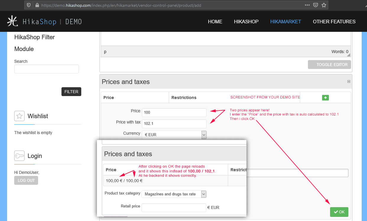

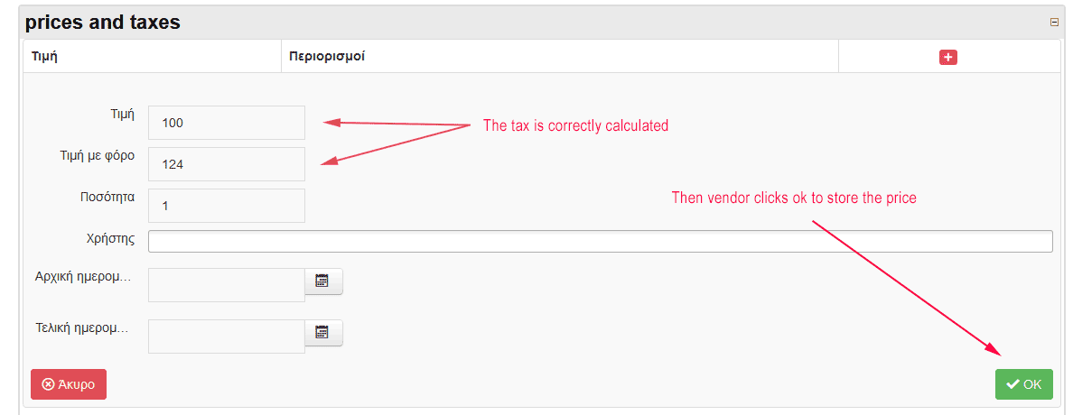

When vendor creates or edits product, in the "prices and taxes" section of "/product/add" page we discovered the following problem.
Vendor sets price 100$ that becomes 124$ with tax.
Then vendor clicks OK to store the price before saving the product. Right after clicking OK the vendor sees the following.
This is confusing for vendors because they can not know at this stage if everything is correctly set for their product.

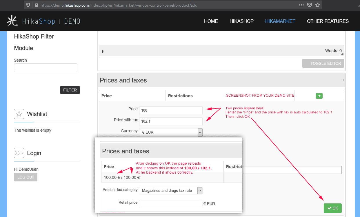

The issue exists on your demo site and here are the screenshots of your demo site:
Hope that you can see it.
Thank you

Step 1
Vendor goes to create new product. Clicks on "+" button to add price. The vendor ads the price without VAT and the site calculates the VAT and shows the price with tax correctly. So the site calculates the price and tax correctly! You can see it before pressing "OK".
Step 2

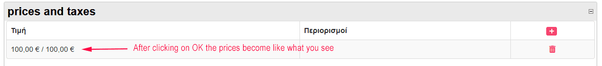

Vendor sees the price and the price with VAT at the 2 fields. When the vendor clicks on "OK" the page refreshes and it shows two times without VAT (price without VAT / price without VAT).
The only way for the vendor to see the correct values is to click on save. Then the correctly calculated prices arrear. Till then the prices appear wrong.

I see the price and the price with VAT before i click on OK. When i click on OK i see: "price without VAT / price without VAT" two times.
This is the confusing part for vendors because they do not know that when they will save it everything will be saved correctly. And we do not expect from them to know it or imagine it.

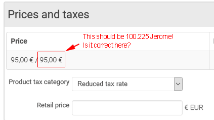

Use "Reduce tax rate" set price to 95 and the price with VAT becomes 100.225. Now click on "OK" and the next thing you see is this:

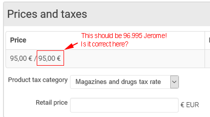

Use "Magazines and drugs tax rate" set price to 95 and the price with VAT becomes 96.995. Now click on "OK" and the next thing you see is this:
Now you will tell me that if you save it, all the prices are stored correctly!
I know that. But the vendors do not know that!
Do they see a message somewhere that they have to save and then edit the product to see the correct prices?
No!
They enter their price once, click "OK" and they see wrong prices!
They enter their price once again, click "OK" and they see wrong prices!
